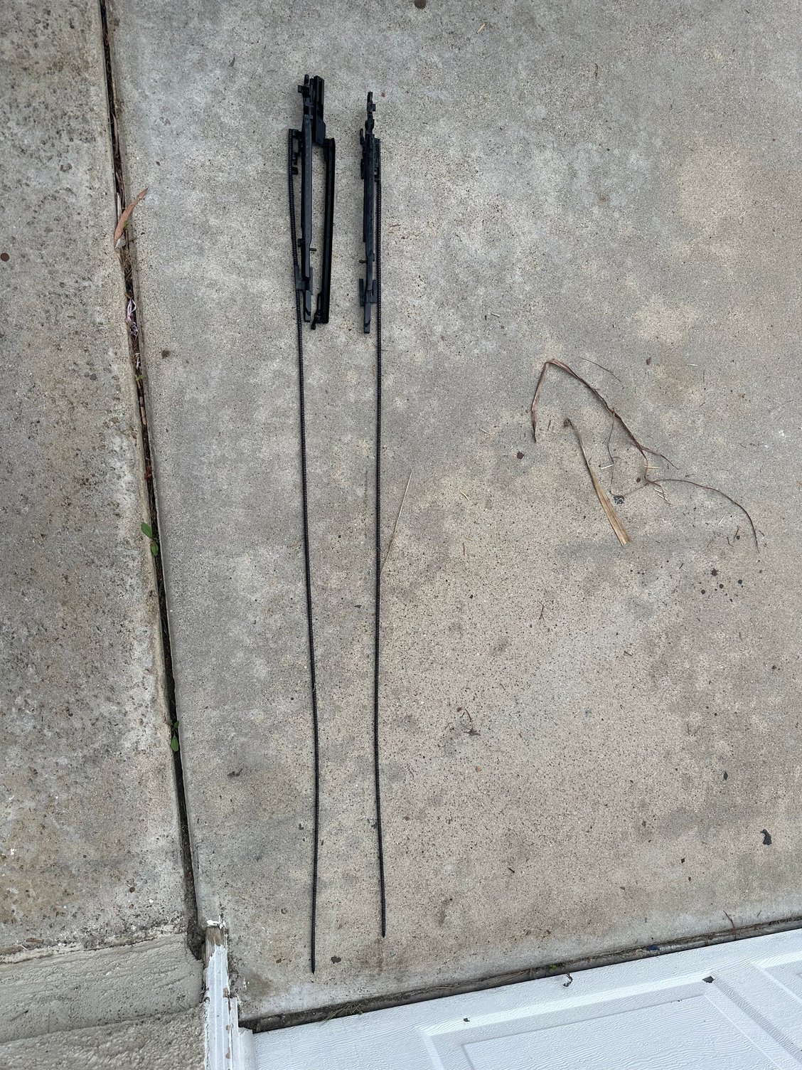

This should be final update. New parts arrived, they are not quite as pictured. It includes the drive cable, traveler, and the plastic arm that Carrie’s the moon roof.
Replacement was straightforward, have to ensure that L and R sides are at the same point.
Reinstalled moonroof, checked that it did not bind manually, then connected motor and overhead switch panel to verify electric operation. Ours had two issues. When closing it would hit the defector arms and reverse. If we pushed them down it would close normally. The other issue was the vent position was actually only closed, and closed was still a little open. Both of these were solved by manually cranking the moon roof to vent after pushing the button to vent. I think there is a register between the computer and the motor that was broken with our disassembly.
These are the two assemblies that were removed

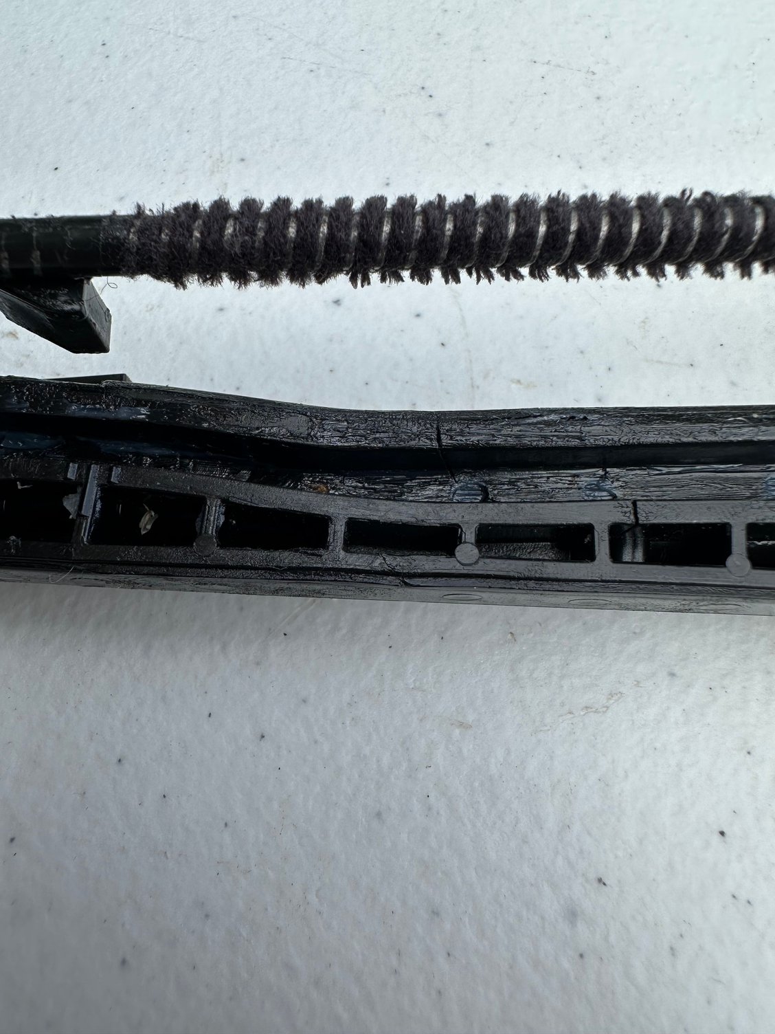

Close up of drivers arm, cracks can be clearly seen.
The metal claw slides through the channel. This one is so worn that the claw catches at the top and does not slide through.
More damage to the arm.
