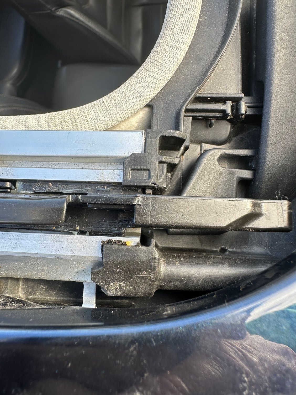

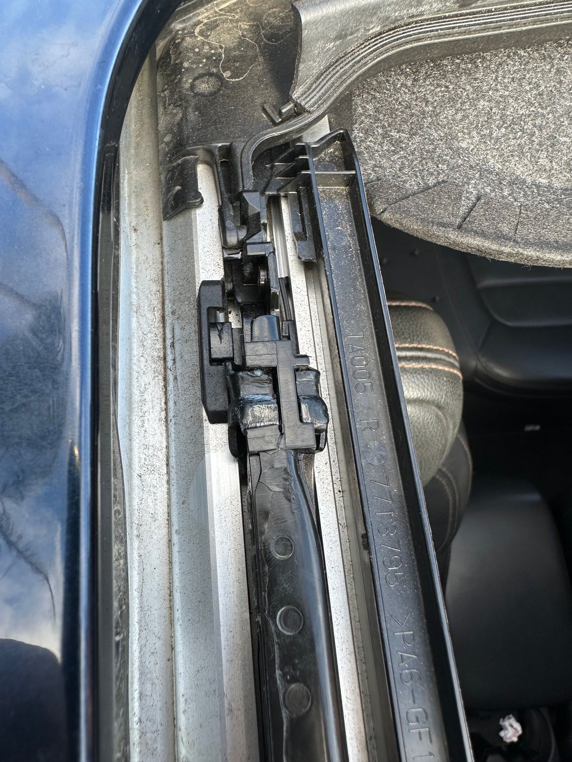

Hi,
We have a 2020 CX-5, purchased CPO last year. The 12 month Mazda warranty expired in late June. About a week ago the moonroof stopped closing properly. If you push the button forward to close, it slides forward normally, but the rear edge of the glass panel does not raise properly. The (US) drivers side does not lift at all, the passengers side does lift. The front edge of the glass is aligned normally. We looked with a borescope, but we cannot see anything blocking the glass or rails. We removed the glass to watch the rails. From what we can the the passengers side behaves as normal, the rail slides forward, then the rear raises up. The drivers side slides forward, but does not raise. Looking from above there is a cutout in the rail for a tab to move up when the rear edge raises. That tab is not aligned with the cutout, the rail appears to move about 5mm too far forward.
Does anyone here have experience with this?
Can the travel of the glass carrying rails be adjusted? Mechanically or with dealer software?
Can the guide rails be adjusted forwards or backwards relative to the moonroof frame?
Ill try to upload some pics later today.
Thanks for any help!
Drivers side, tab is not passing through the plastic gap
Drivers side front of rails, gap is smaller than passengers side
Passengers side front of rails
Passengers side, tab is passing through gap.

Appears to me that your driver's side tab is broken, and the passenger side has hairline cracks in it.
This can happen with debris or ice (or defective part?)

Appears to me that your driver's side tab is broken, and the passenger side has hairline cracks in it.https://www.realmazdaparts.com/v-202.../body--sunroof
SHARP EYE, if the replacement parts are available separately instead of a whole new track assembly ,it ought to be a easy cheap fix.
