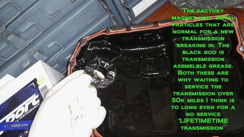

Mazda ATF is already a dark color, so it is difficult and not always the best indicator of the condition of the transmission. Careful inspection of what was on the pan magnet, the varnish on the valve body and the collected sediment at the bottom of the pan is a better indicator as to what was and has been going on in the transmission.

Some vehicles may exhibit a chirp noise (stick-slip noise) from the automatic transaxle (AT) when shifting from 3 to 4 while driving. This may be caused by the automatic transaxle fluid (ATF) being contaminated by iron powder due to excessive wearing of the lock up clutch in the torque converter.
This was a BAND_AID theory based on bean counters determine that it was necessary to do the least costly service. If you read and understood this TSB/Bulletin it was written first and foremost directly for a Mazda mechanic. That is important because so many of these are often as in this case misinterpreted, understood or simply thinking that it fits anyone describing the sound they hear that has a psychological effect of reading one descriptive word like chirp.
See video below
The reality is that NOT doing very early fluid pan and filter service is likely the cause of ALL transmission issues and when you are out of warranty you are out of any recourse to go back to the dealership to have Mazda cover the issue cost.
ALL Skyactiv transmission like engine have a break in period and will shed various material that will not always be caught in the transmission filter which even in a 2026 transmission they are still antiquated in the concept for filtering and are great for stopping very large pieces of material from being pulled from the fluid that held them in suspension before going through the transmission.
The next time a transmission pan is dropped take notice to the material that is always present on the pan magnet ( provided a few pictures ) and then think of going years or tens of thousands of miles or even only a few thousand miles on a new transmission what is mostly, but not all collected on that magnet.
