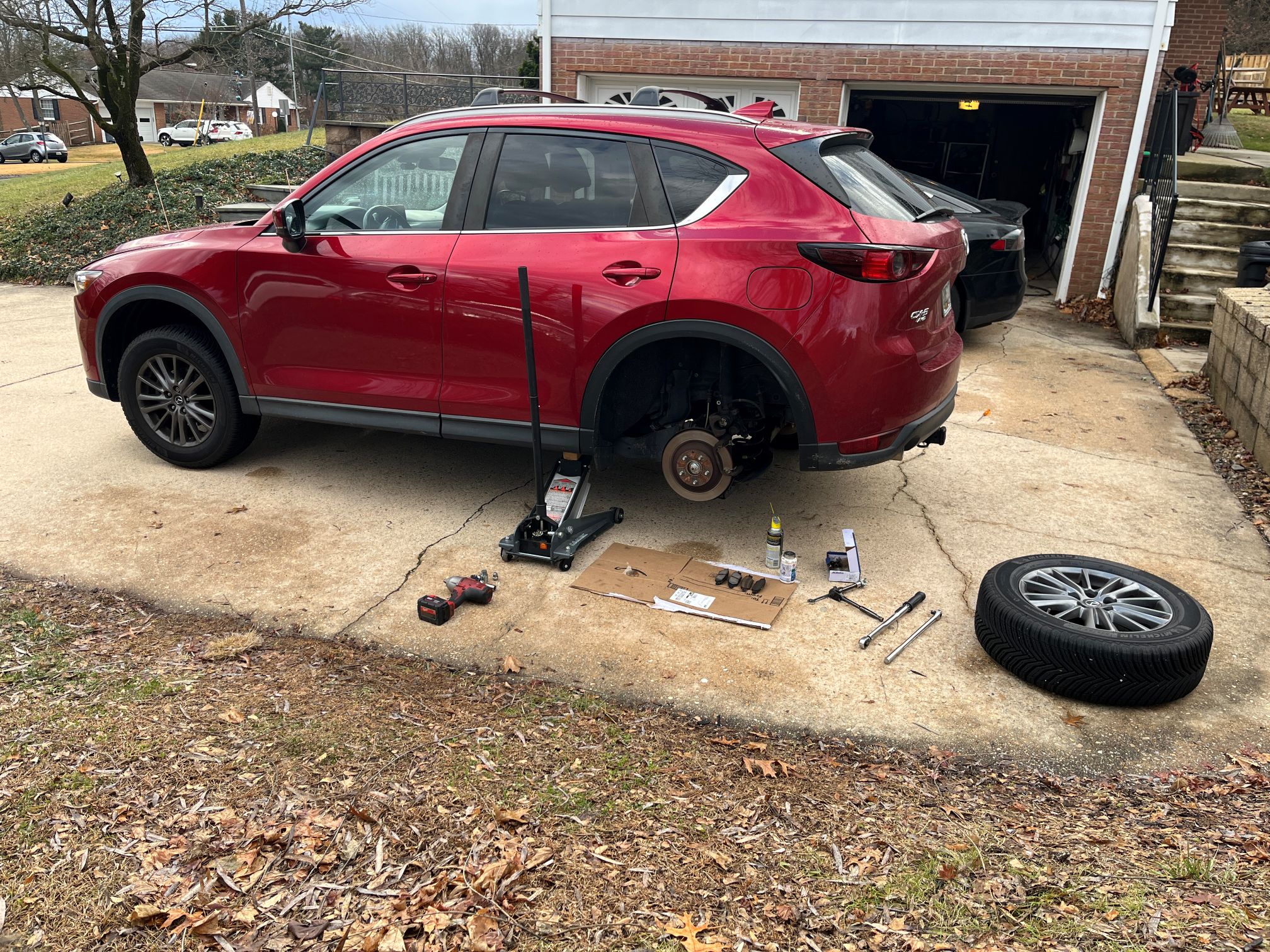

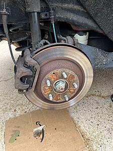

DIY Rear Brake Pad Replacement:
1. Loosen lug nuts (DO NOT REMOVE)
2. Jack/lift from the jack/lift points
3. Remove tire

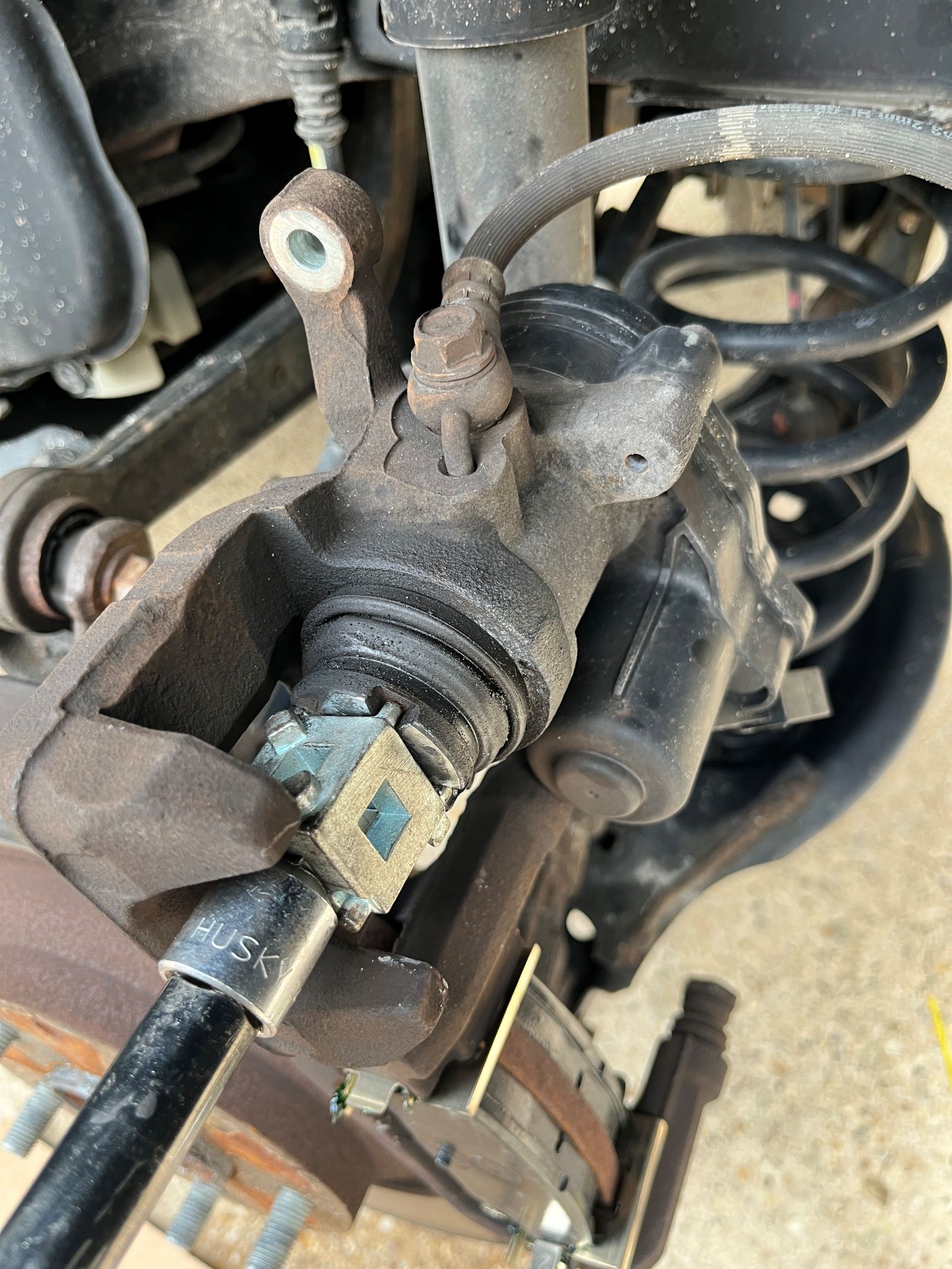

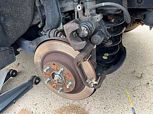

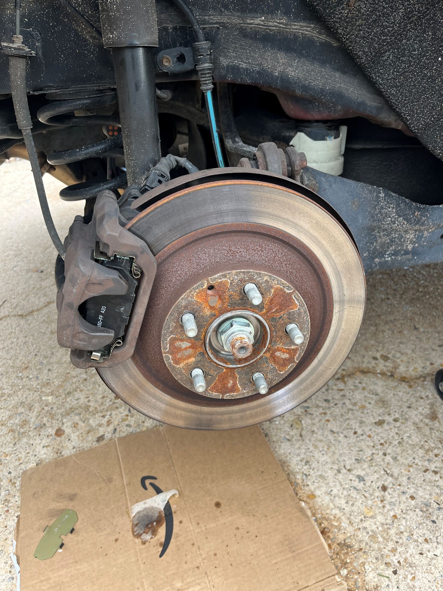

4. Loosen caliper bolts (14 mm)
5. Remove bottom caliper bolt only
6. Remove ABS clip
7. Pull up caliper slowly from the bottom

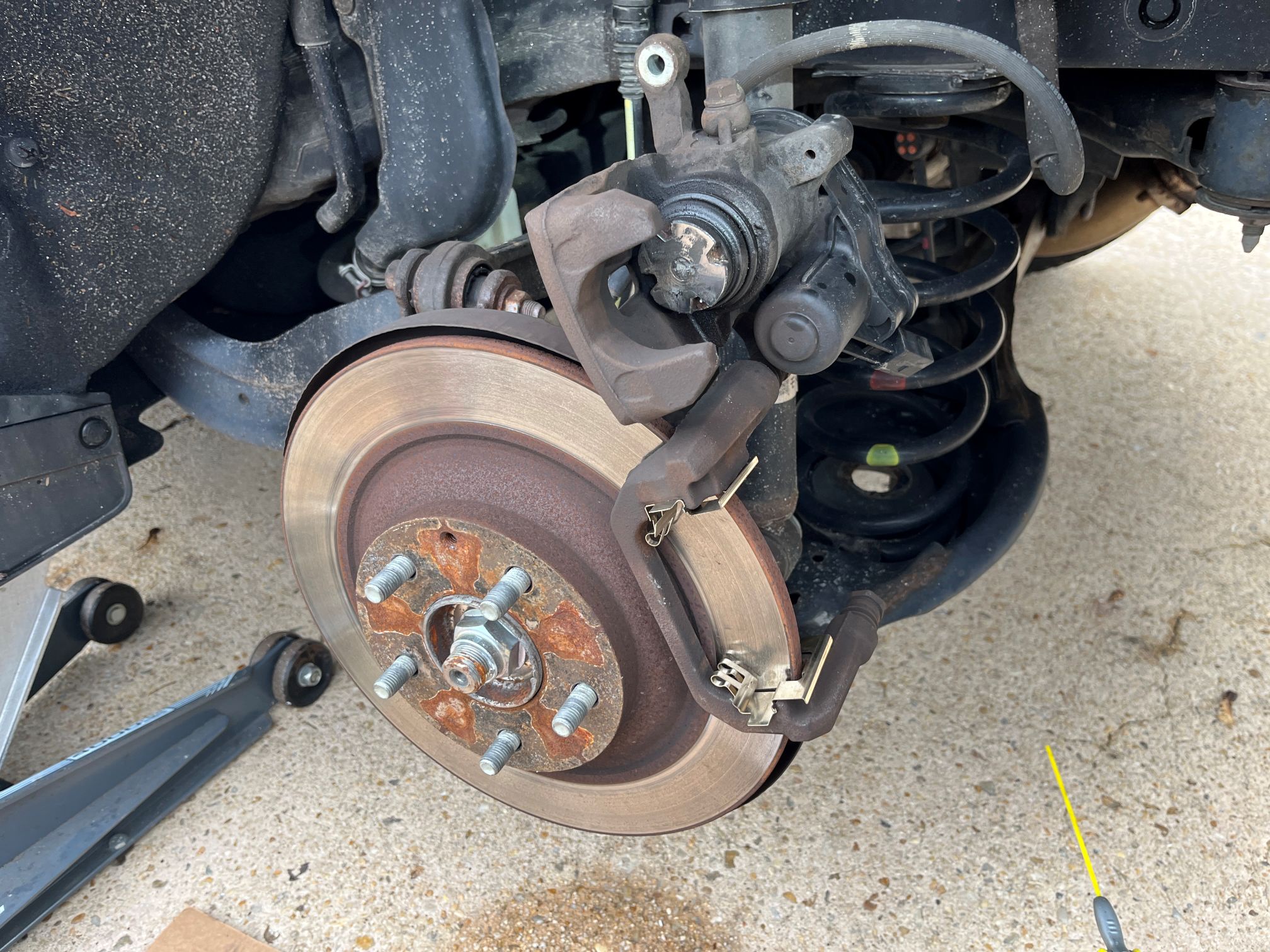

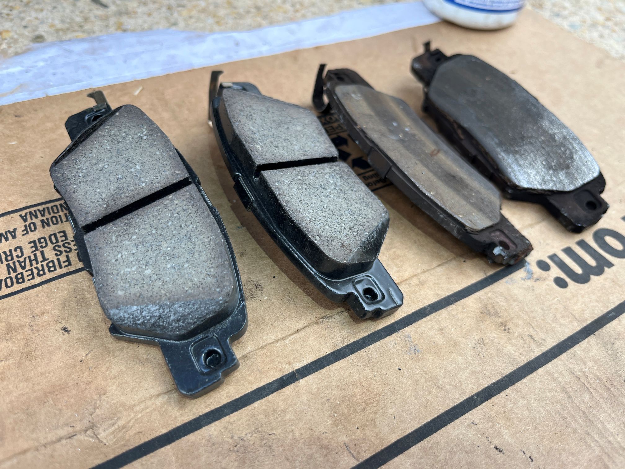

8. Remove old brake pads
9. Clean or replace shims/clips
10. Push back caliper piston
10. Add grease (very little) to tips of new brake pads
11. Insert new brake pads into caliper
12. Install in reverse: caliper, ABS clip, tire, etc.

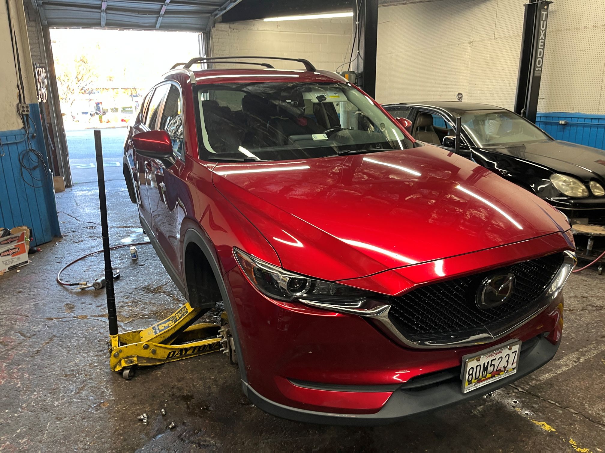

This was a cool milestone to catch...79997 miles on this car.

Old Dec 24, 2025 | 10:17 AM
Posts: 10,606
Nice write up on the rear. But you forgot to mention placing the rear electric parking brake in service mode. I am surprised you did not have a problem when you finished by not doming that unless you did.
Old Dec 24, 2025 | 11:30 AM
Alexmed2002's Avatar
Posts: 925
Likes: 15
From: Massachusetts
This is extremely important! Good call @Callisto .
