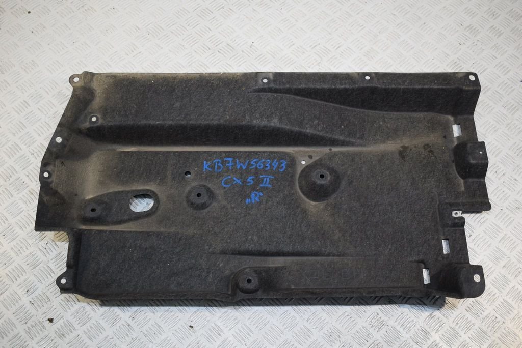

Not so far out. I actually have a piece of the missing shield with a part number but it doesn't come up in any search. It say KB7W56343. I know this is a Mazda part number because similar numbers come up in my search but they are not cover splash shields

Can you post a photo of the piece with the part number?

Does the panel look like this?
I can't find your part number using online Mazda parts systems, however I can google the number & get Polish or Russian websites, nothing for the USA or other markets.

Yup that's the rear section. I finally called the dealer, he couldn't find it in the beginning either but he did find them. The old numbers had been superseded by KB8B561Z0B for the front and KB7W563D0C for the rear
Problem solved
