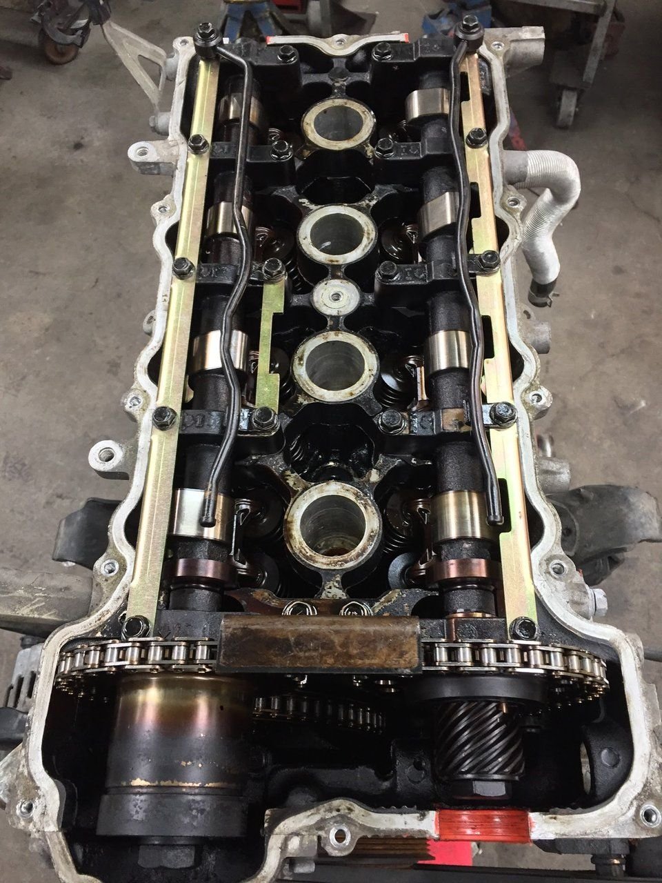

There wasn't any maintenance history available. That said, I have a tendency to look under the oil cap, look for any staining, build-up, or burning smells that might indicate someone lapsing on their oil schedule. It's not perfect, but I've had engines that look like this after 50k:
and then I've had engines that look like this after 50k:
