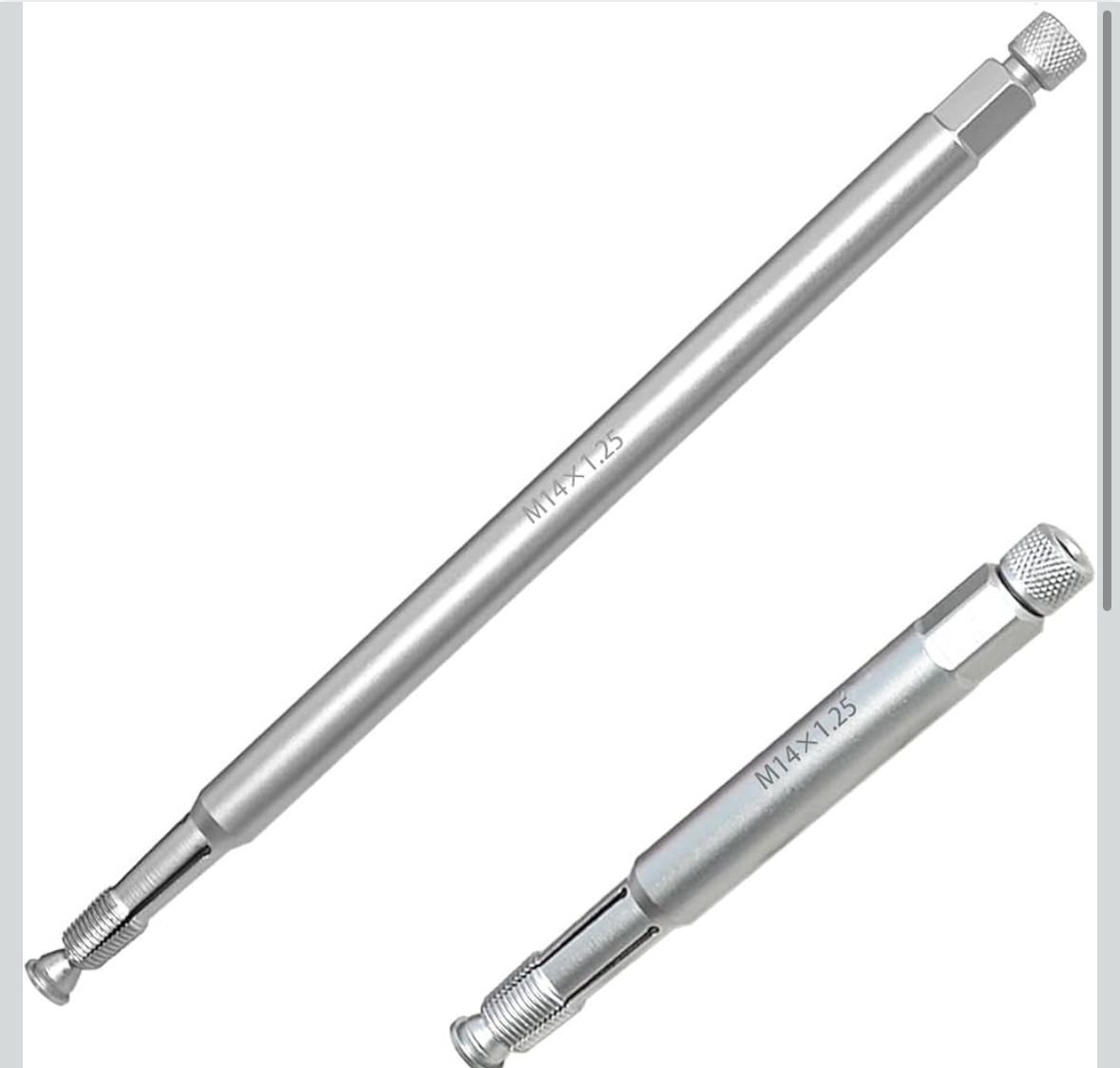

You can buy a tool to try and restore the thread but it takes some skill so my recomendation is have it towed to a reputable shop.

Would a back tap possibly work?

This is the type of tool I'm talking about but if you messed up trying to fit a plug your likely to destroy the thread and have to remove the head to fix it. The plugs are deep down and it's difficult to get any repair tool in there.

I actually bought one but they sent a 12mm 11” one but I ordered 14mm. Waiting for replacement. I used the 12mm just to get idea of length and it seemed to be long enough but I could be mistaken.

Therefor it is very doubtful you will be able to use the "tool" correctly.

So to add.. you have a few issues going on but the first have a qualified service shop fix you spark plug cylinder threads before you do damage that will require R &R of the complete cylinder head.
The tool pictured in the inexperienced hands can further damage a thread in the location of a head with deep spark plug access.
