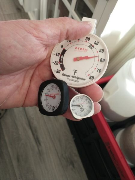

I figured the blower motor was fine. I would now check the actual temperature coming out of the vents? It easy to do and even if you don't have the automotive measuring devices, I am sure you have one in your kitchen?
These little tempretue tools are great for all sorts of automotive use. I have one in the center vents of my Mazda and also in the intake tube just before the Throttle body.
