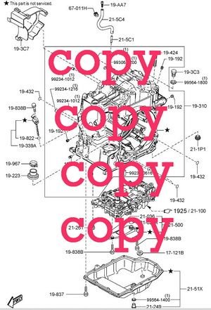

Here is a parts illustration for a non turbo Cx30 transmission that as all I am going to post. about that. I will state however that my very long-time friend own a Transmission shop that has been in business since the 80's
