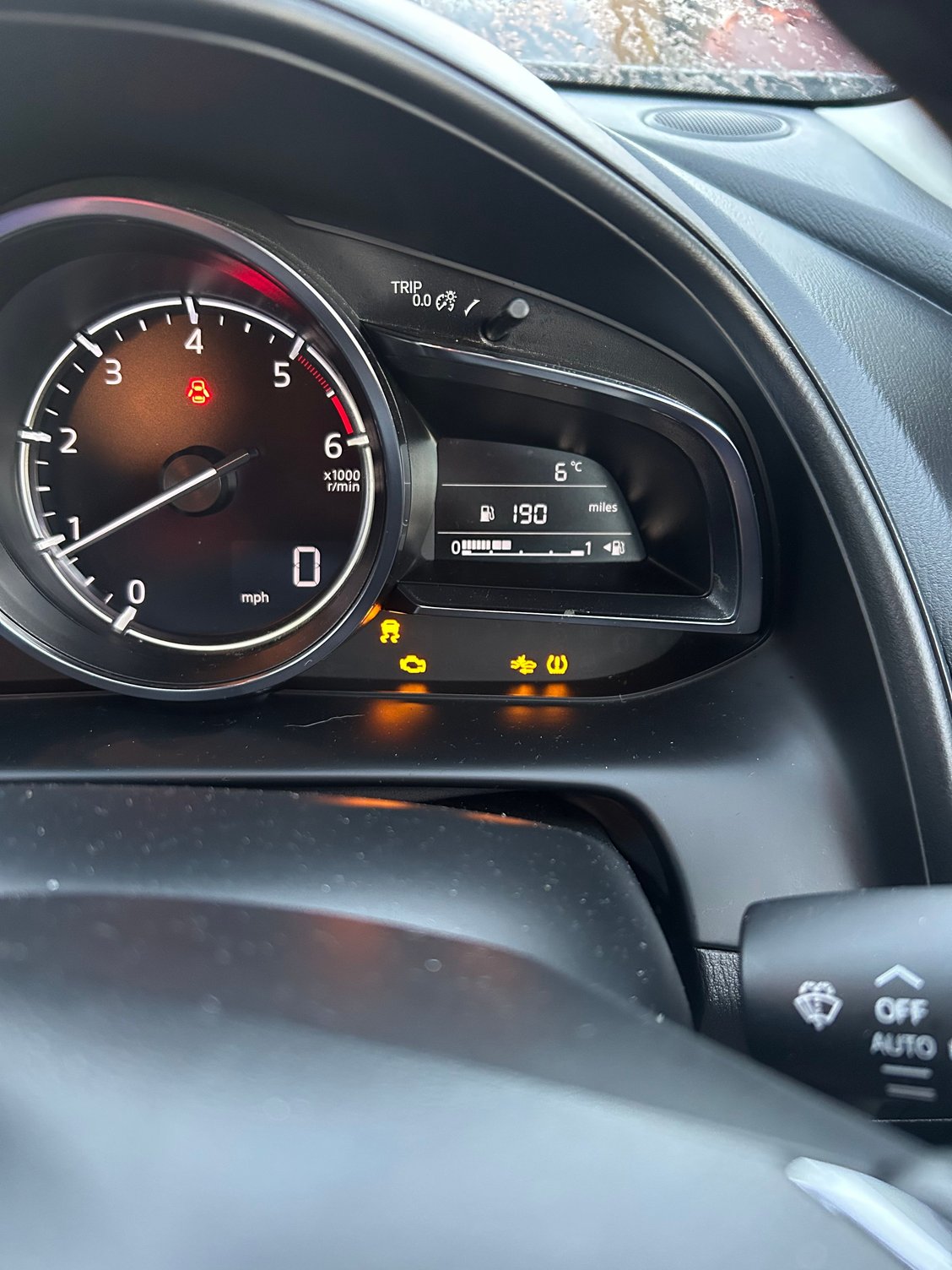

[img alt="Started my car this morning, drove out the drive to the junction and 10-15 metres away, stopped at the junction and these lights came on
I went in to work and came back out for lunch after 4-4-1/2 hours and management light was still on. Went back to work and came out 5-5-1/2 hours later and no lights. Never came on on the way home either
What could the problem be? I’ve been told it’s an ABS sensor, would that check out?"]https://cimg0.ibsrv.net/gimg/www.mazdaforum.com-vbulletin/2000x1504/img_2483_293ab2da761bf15747a7e787230d55ed75283637. jpeg[/img]
Started my car this morning, drove out the drive to the junction and 10-15 metres away, stopped at the junction and these lights came on I went in to work and came back out for lunch after 4-4-1/2 hours and management light was still on. Went back to work and came out 5-5-1/2 hours later and no lights. Never came on on the way home either What could the problem be? I’ve been told it’s an ABS sensor, would that check out?
To start of you need to get your ECU professional scanned or at least someone that has a good quality Diagnostic scanner (not any blue tooth type) and can completely scan the ECU for all incidences at least in the 3 main area's of the ECU. Without that it's all guessing without enough and correct information
Aside from the check engine light the other depending on your operating environment are normal and the TPMS suggest that you should check all your tire pressures when the tirs are cold and early in the morning is the best . Then reset the TPMS.
Yellow indicators mean to be aware of a state of caution regarding what the symbols illustrate
RED light means generally stop driving and or turn the engine off and look for the cause of the RED light
In the picture above all are explained in detail in your owners manual.
