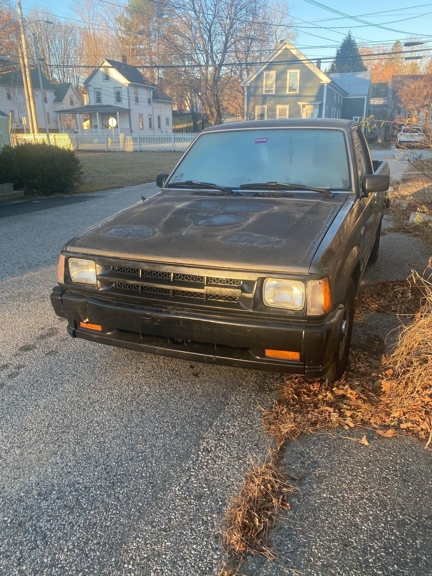

Hi all, new to the forum and hoping I can get some help and recommendations
I just got my first Mazda truck, a 1988 B2200 and I'm trying to find a way to put some decent snow/studded tires on it, since I need to drive it this winter
The problem I'm having is that I can't find any snow tires in the size on the truck (205 75R14) and it looks like the only way I can get snow tires on it is to bump up to a 15" wheel from the current 14s.
Can anybody point me in a good direction?
Thanks!!
