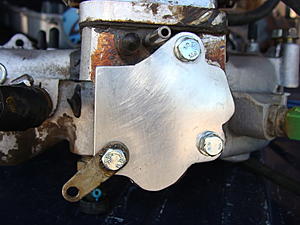

Originally Posted by HITDOGG
As far as that EGR valve, You said you had it hooked up to the thermo valve, is that the blue valve that is on the intake underside closest to the firewall?
Once I had the EGR valve hooked up to that thermo valve under the intake manifold, yes. But once you convert to Weber you can delete the EGR valve using a metal blockoff, or just use the disconnected EGR as its own blockoff. Photo of my EGR blockoff below; if I was making new, I'd add an "ear" of metal and drill a hole in that for the throttle return spring so I wouldn't need the little throttle bracket shown.
I did my Weber 32/36 DGEV conversion about 12 years ago.
Originally Posted by InTheWoods
How did you plug the reed valve plumbing and what did you use
Two of those Reed valve lines bolt on fittings on the exhaust manifold. Those fittings on that exhaust manifold get capped off; I used 14mm x 1.5mm wheel lugs from O'Reillys (about $6 for four) to plug the pair tube outlets coming out the upper manifold heat shield. For the remaining one I just made a block off plate from a little piece of sheet metal, something like this (copy/paste this http://img.photobucket.com/albums/v6...psc9fcdfac.jpg ) Someone else's write up for this is here Air Injection Delete: AKA Those Ugly Steel Tubes On The Exhaust Manifold
Attached Thumbnails  Weber Conversion-mazda-b2200-engine-photo.jpg    Weber Conversion-mazda-b2200-egr-blockoff-dsc02425.jpg
