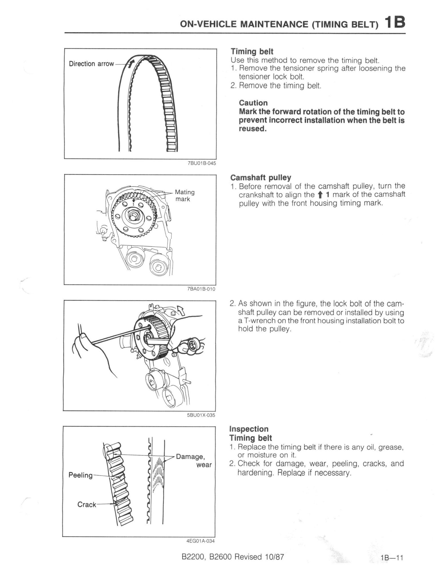

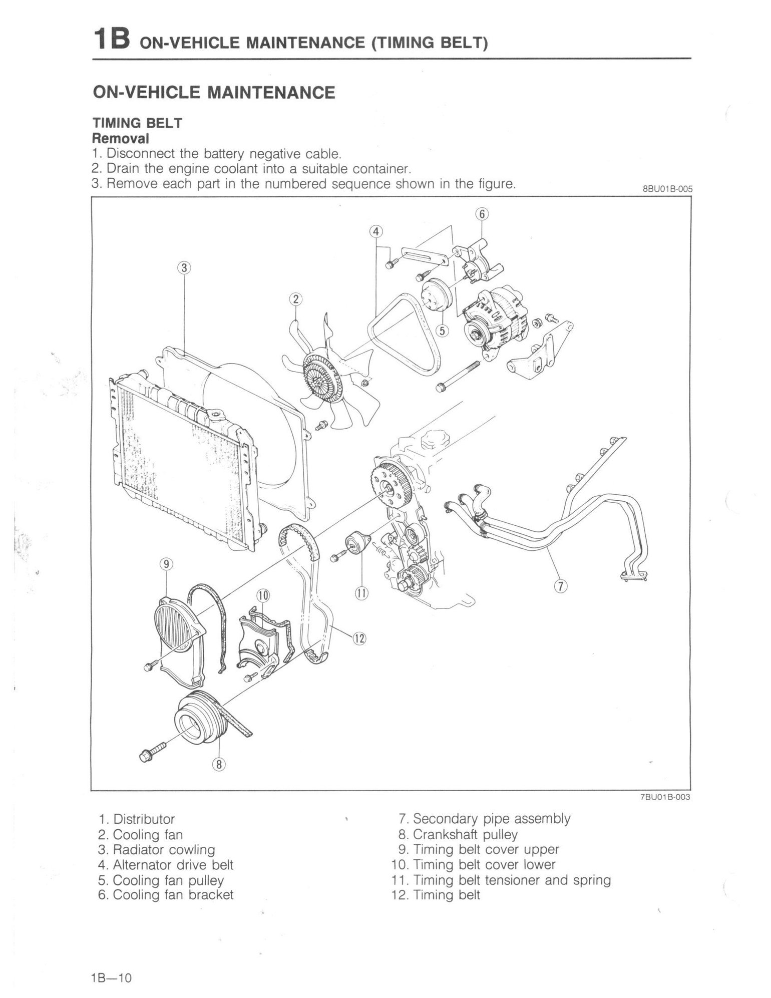

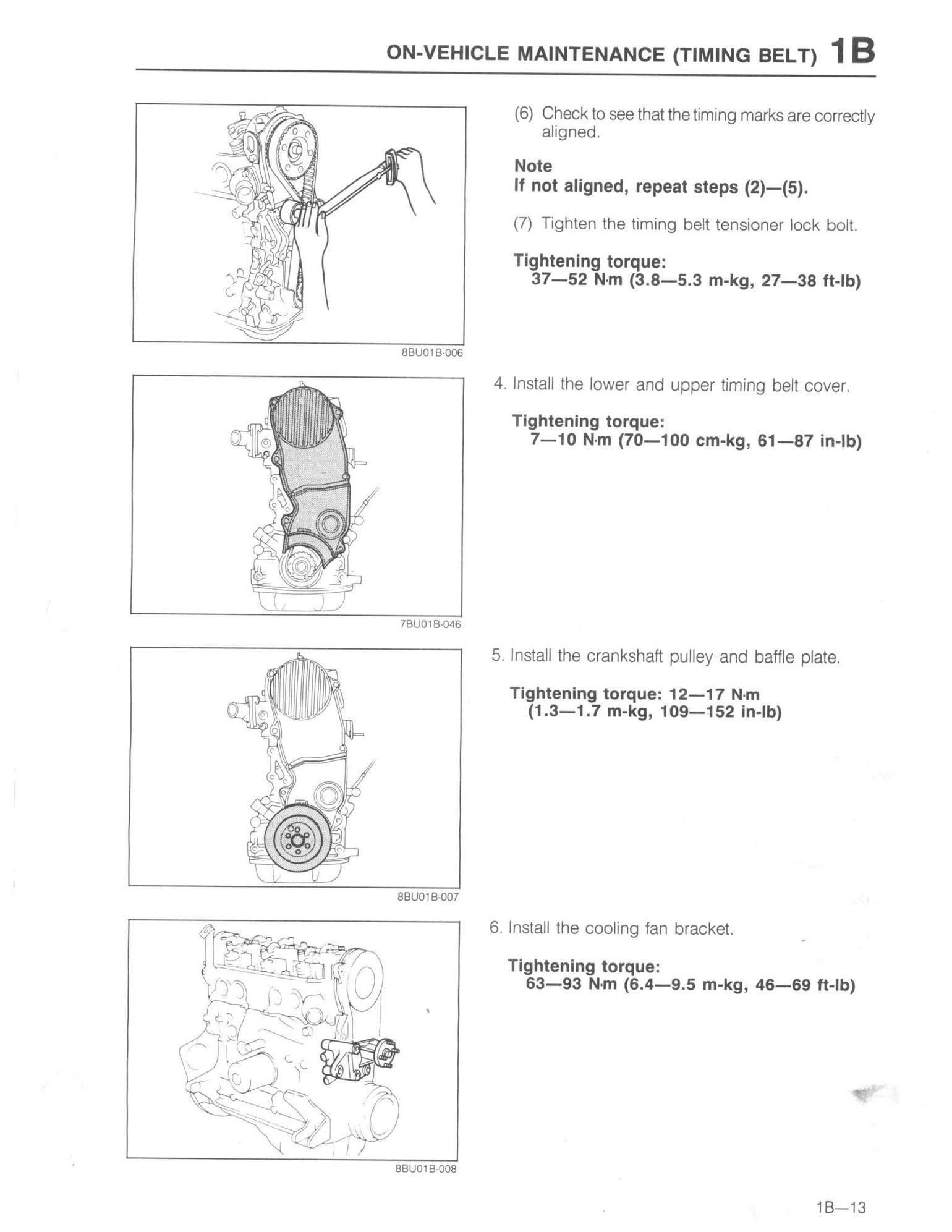

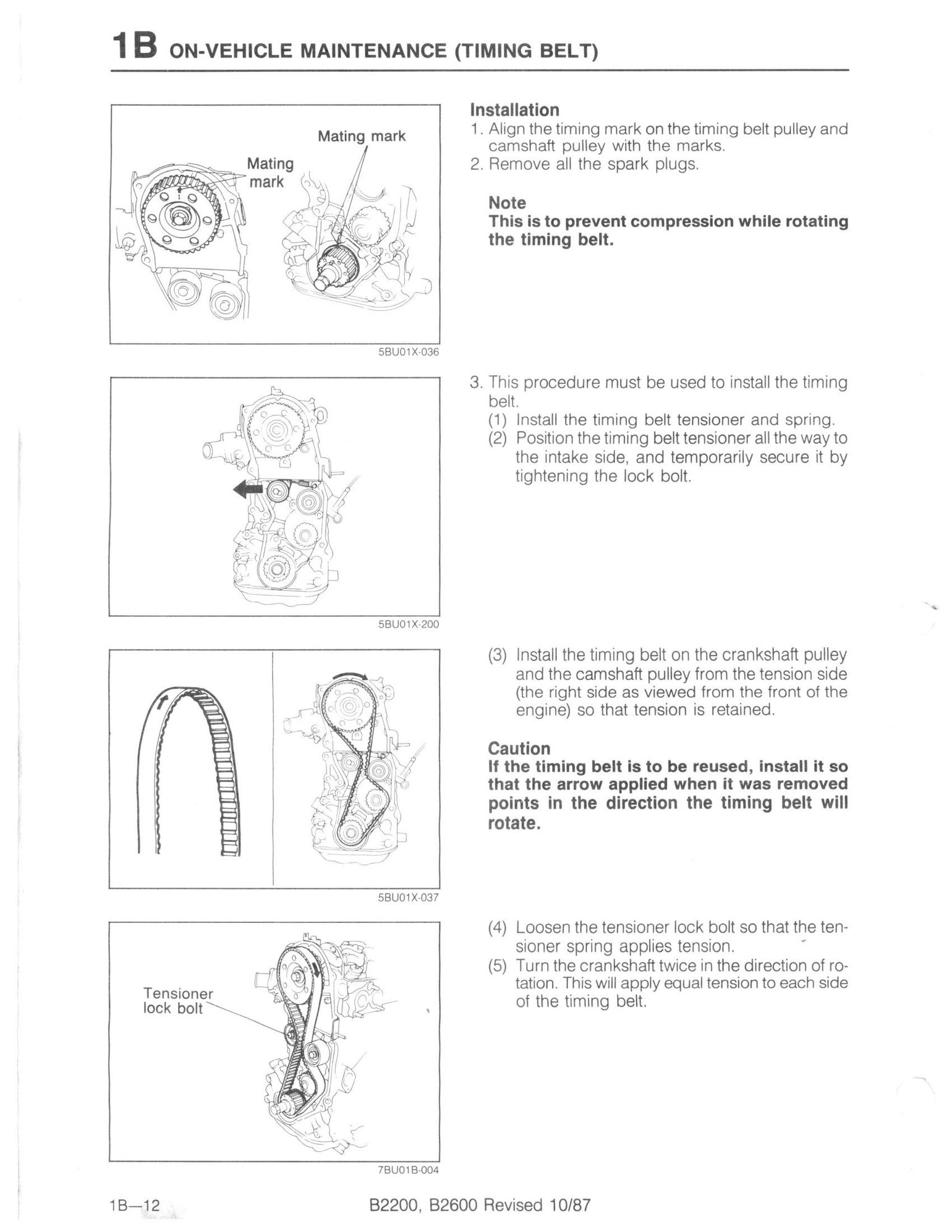

OK, these images are from the 1988 Mazda Workshop Manual, if you have any questions about the procedure, just ask them here.
Also, you can click on the image and increase the size, and print it if needed, I would assume.

In Step 3-(5) Do I make 2 complete rotations from TDC to TDC clockwise on crank? just making sure.
Thnaks,
BJ
Yes, you are just rotating the engine to equalize the tension on each side of the timing belt.

You can turn the engine several more times if you'd like.....just verify that the timing is still aligned properly by stopping at TDC and ensuring that both the cam gear and the crank gear both are aligned to their timing markers, as they were when you installed the timing belt.
Keep in mind that the crank gear turns 2 revolutions to the ONE revolution of the cam gear.......so you need to turn the engine crankshaft over twice to have TDC on both the cam & crank again. In other words......if you turned the crankshaft over THREE full revolutions, the camshaft gear would NOT be at TDC (12:00 o'clock position).......the "1" mark on the cam gear would be at the 6:00 o'clock position......you would have to turn the crankshaft one more revolution to get the cam gear "1" mark back to the 12:00 o'clock position again.
