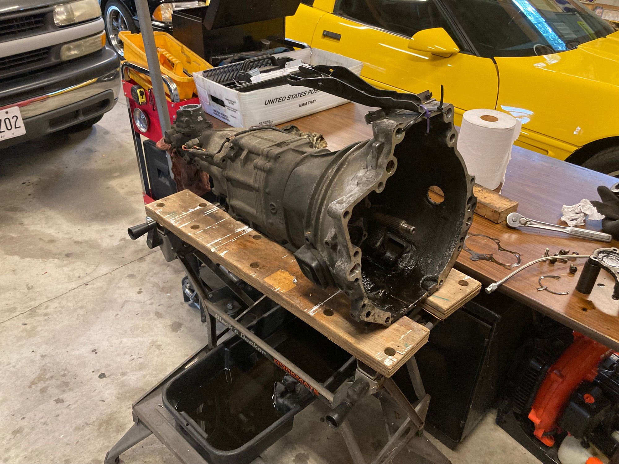

This spare transmission needs synchronizers and I plan to tackle this job myself. I don’t have a shifter for it. I tried manipulating it with an extension but it’s not working well. B2200 shifters are rare but Miata are not. If I get a used Miata shifter off eBay will it work just for work bench purposes?

I can't see why it wouldn't.

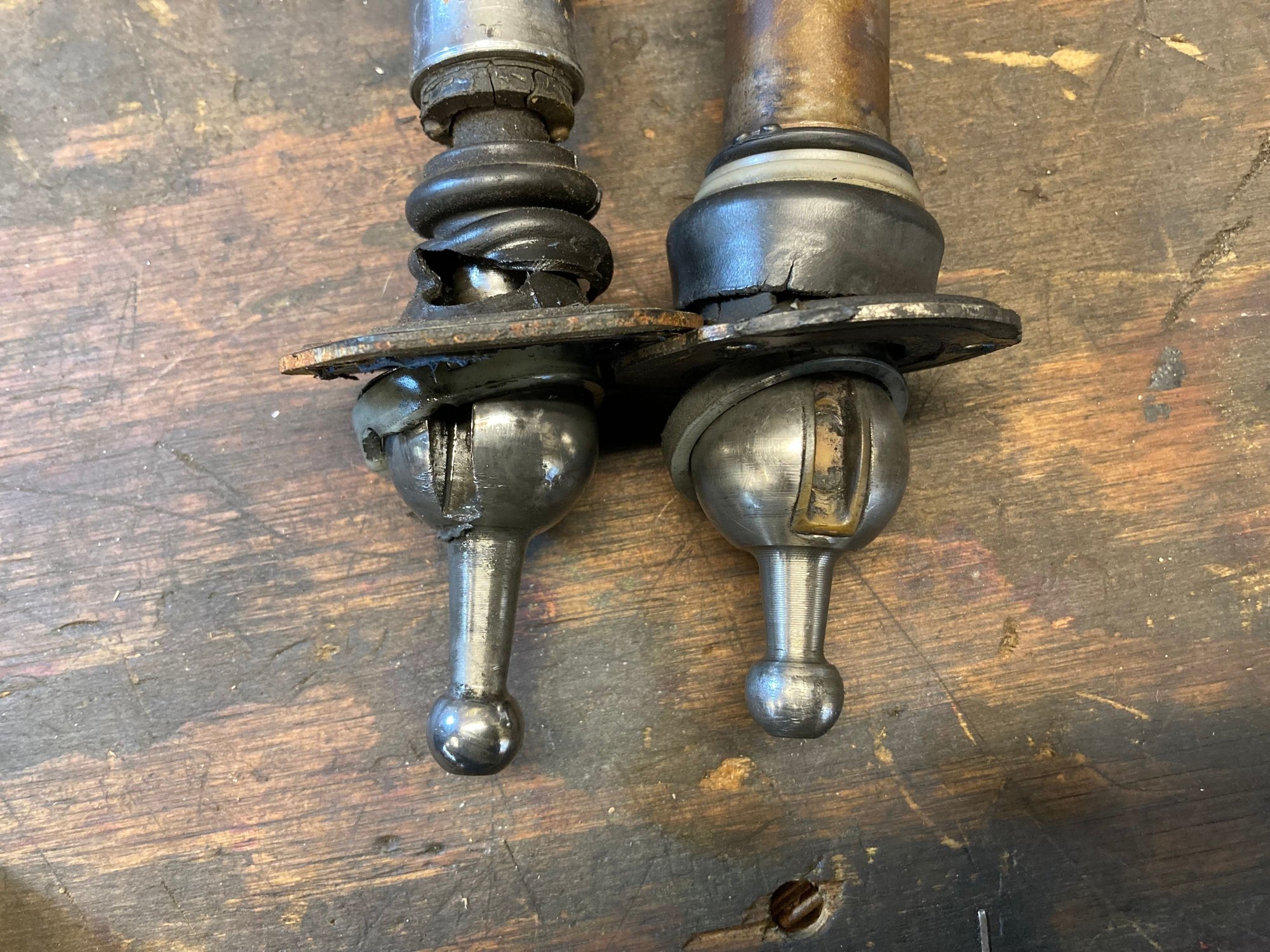

For the record, a shifter from a 96 Miata has a shorter extension into the transmission so it doesn’t directly fit the B2200 transmission. B on the left and Miata on the right
