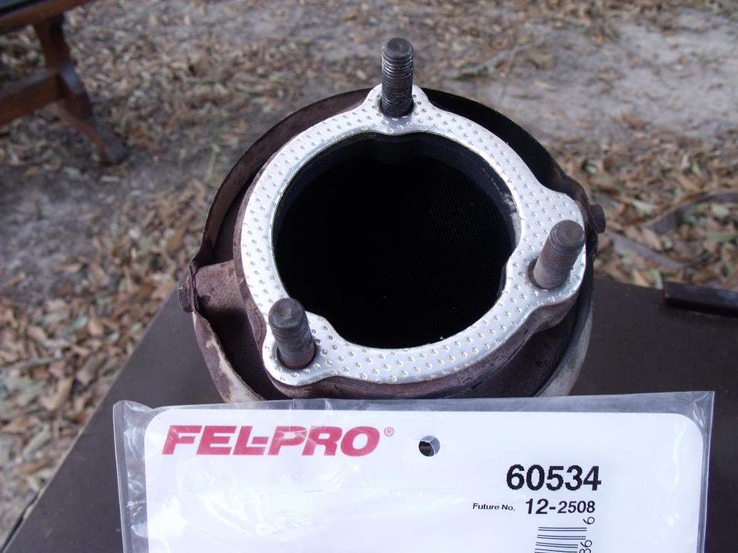

Hey Folks I have an 87 Mazda B2200 & need the Pre-Converter gasket that goes between the exhaust manifold & the 1st converter. Any of you know where I can get one online?
Thanks for the suggestion, but our local dealer closed a few years ago after being run by a crook for a few years and then being sold to a dealer from out of state who just didn't really try to make it work. I have also e-mailed the 2 nearest dealers (Biloxi, MS. & Jackson, MS) & recieved no reply. Apparently a single gasket for an older truck isn't worth their time.
Anyway thanks to someone on another forum I was able to come up with a FEL-PRO part number that I oredered through Advanced Auto parts with a total cost of about $3.25. The FEL-PRO Part number is 60534 & I have attached a picture of the gasket setting on top of the converter just so anyone looking at this will know exactly which gasket we are talking about & that it is correct.
Thanks. 60534 helps me, turns out that can be ordered through Autozone.

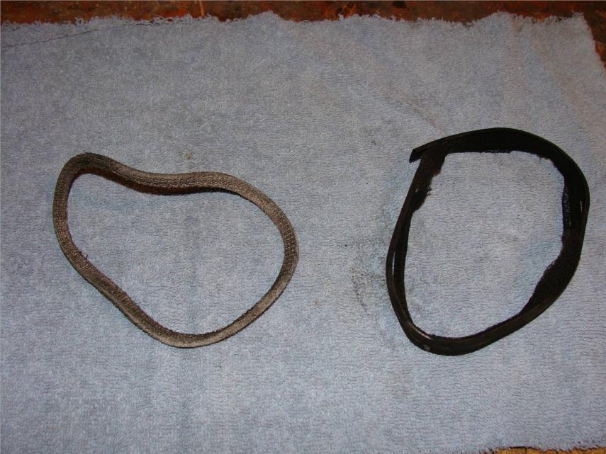

I re-did all my exhaust gaskets yesterday, from pre-converter down, except for that one; I have the air tubes removes, the gasket sealed a block off plate I made from a Simpson Strong-Tie from Home Depot. I just left that block off plate on (sealed using the original gasket) when I removed the pipe below the pre-converter.
Anyway, I had been experiencing a rattle issue from the exhaust. I pulled a loose "soft" ring out of the pre-converter, and a loose metal-clad ring from the 2nd converter, and buttoned it up with new gaskets. And the rattle is gone.
Pre-converter gasket on left, 2nd converter gasket on right.
I also blocked off the air pipe using the factory type gasket & a rectangular piece of steel plate. This truck has no converters after the pre, apparently someone else had previously removed them. On my personal truck i'm running a weber carb & the pace header setup with a Walker factory replacement muffler.
