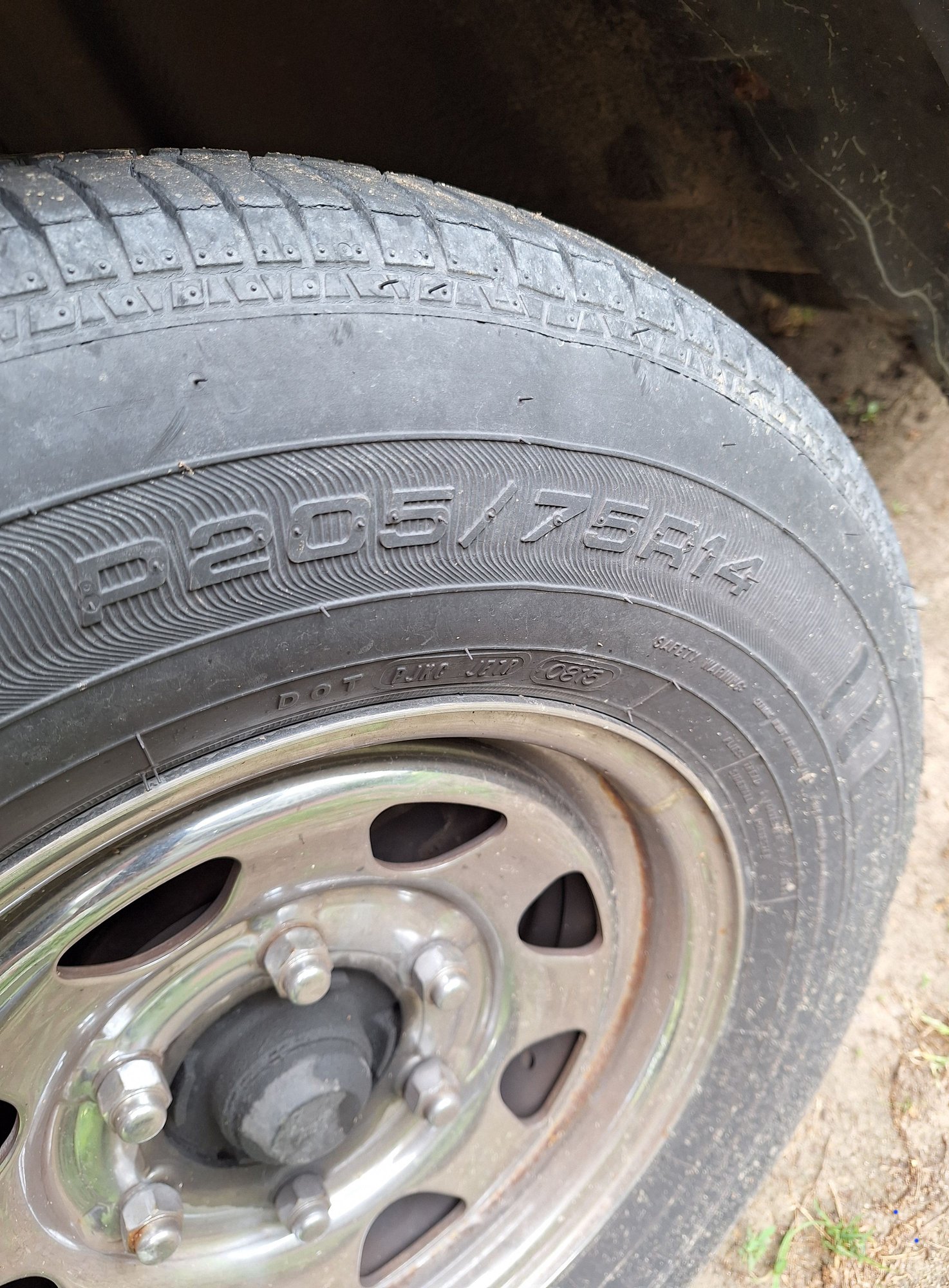

I swapped the factory wheels out for 14" chrome '90s model Nissan hardbody wheels. Static dropped it about 3 inches with blocks in the rear and clocked torsion bars up front.

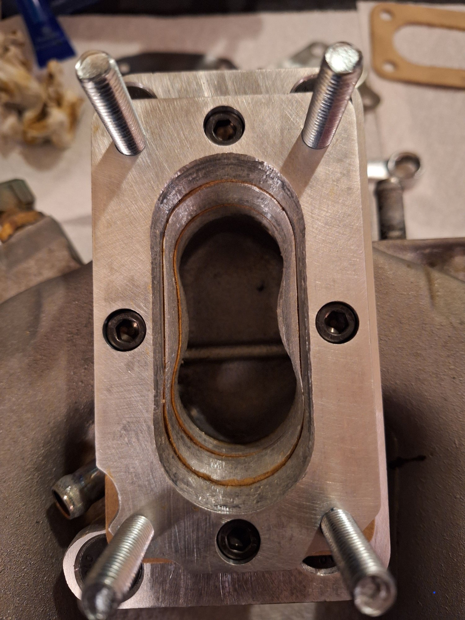

Here is 2 pics of the carb set-up. Been running for about a year now.

You are like me... port and polish everything. Just curious on the primary runner of the intake why you choose not to do a smoother finish in that area to reduce turbulence?
Old Nov 5, 2025 | 01:30 PM
Mechanically Minded's Avatar
Joined: Nov 2025
Posts: 143
Likes: 13
From: North Carolina
Fuel sticks to smooth surfaces. These cheap carbs are not the best at atomization, anyway.
I think somewhere around 80 grit is about right for the intake tract. It allows it to peel off in the turbulence. Mine is grinding stone rough. Laziness I suppose...
Yes, I port match everything. I do not see a reason not to. It is near free. Makes the casting better. And might make it a little more efficient. If you do this too, nice to meet you!
