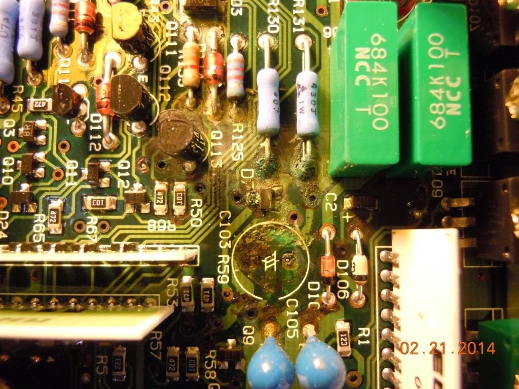

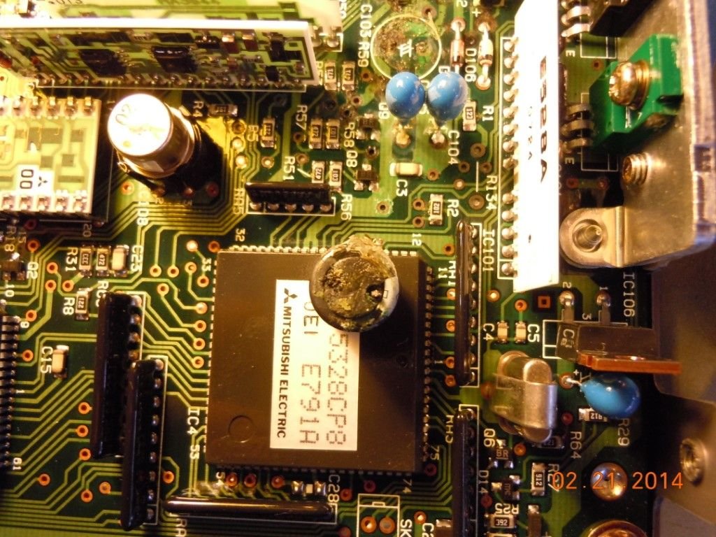

Are you sure the ECU (computer) is good? They are known to have 2 leaky capacitors that can etch the circuit board and therefore cause issues with the injector circuits.

Bad capacitor in the center of picture (turned upside down to show where the leads corroded off of it from the capacitor leaking acid)....
Close up of where the capacitor is supposed to mount on the board (at white circle C103) and the surrounding corrosion from the leaking capacitor acid.....

yeah, I inspected my ecu and tried the one in my brothers truck(same truck) not the problem. thanks!
