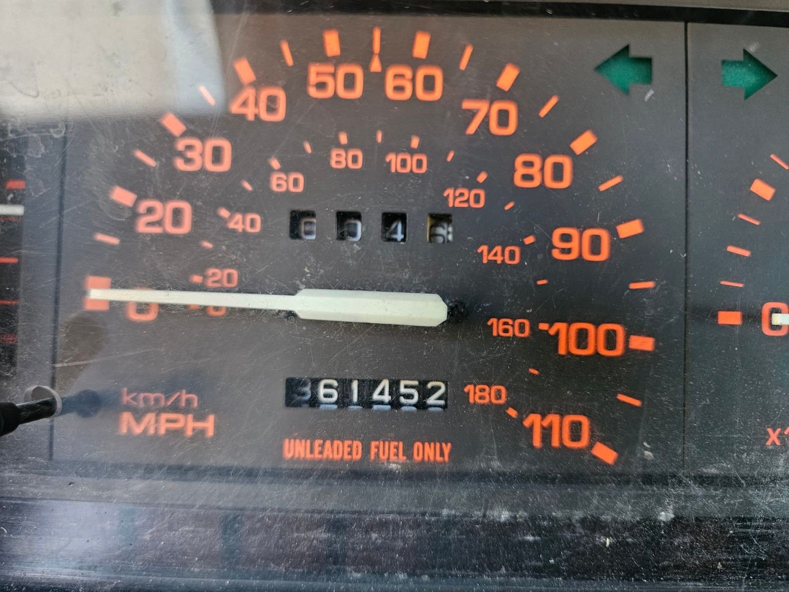

1992 B2600I 2WD 5-SPD EXTRA CAB LE-5 WITH 361k ON THE ODO.
I've had this truck for seven years as of this past August. It had 182k when I bought it, so I've put twice as many miles on this rig "in seven years" than it got in the previous twenty-five... IT IS SOOOOOO FUN TO DRIVE! Still has the original paint and it's glossy. Almost all original, and I get compliments ALL THE TIME.
I'm having a problem with the throttle "sticking" when I let off the accelerator to shift gears... like it doesn't want to let off the gas immediately and will rev high when I depress the clutch. Kind of an intermittent problem. My mechanic "instantly" said sounds like a vacuum issue and proceeded to inspect a few hoses and each one shows cracks. He also pointed to the throttle body and said it's likely got plenty of gunk that needs cleaning out. Since I'm committed to keeping this old truck, I want to find the best source for the replacement parts I'll be needing to bring it back to it's glory. For you folks with vast knowledge on this truck/engine... where do you shop for parts? I read somewhere that the "ECM" can be hard to find anymore. Mine seems to be okay, but what happens when they go bad? And where do folks have them serviced nowadays?
