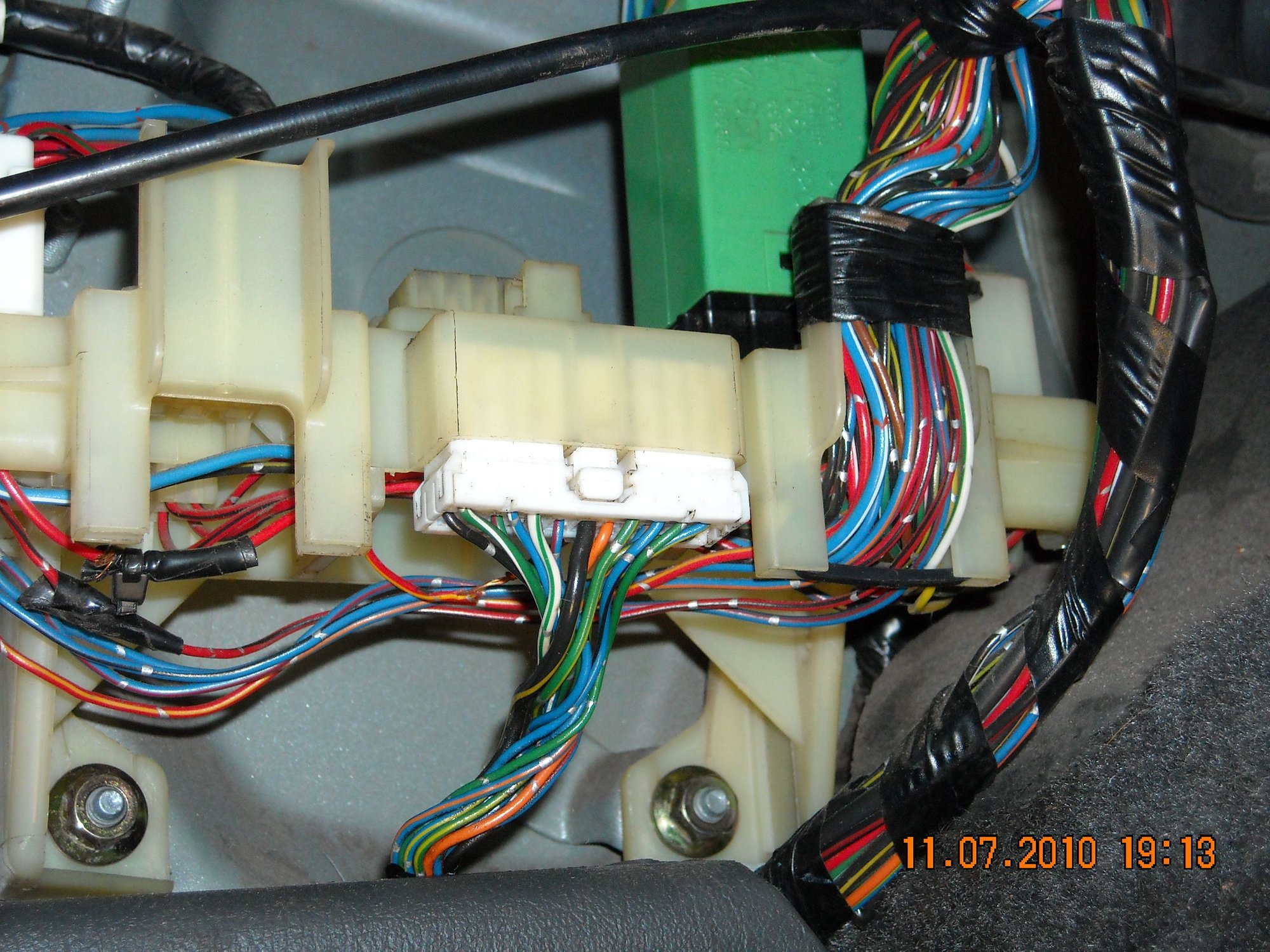

Look under the dash on the Driver's side, and ABOVE this.....
Look for this bundled wiring harness......

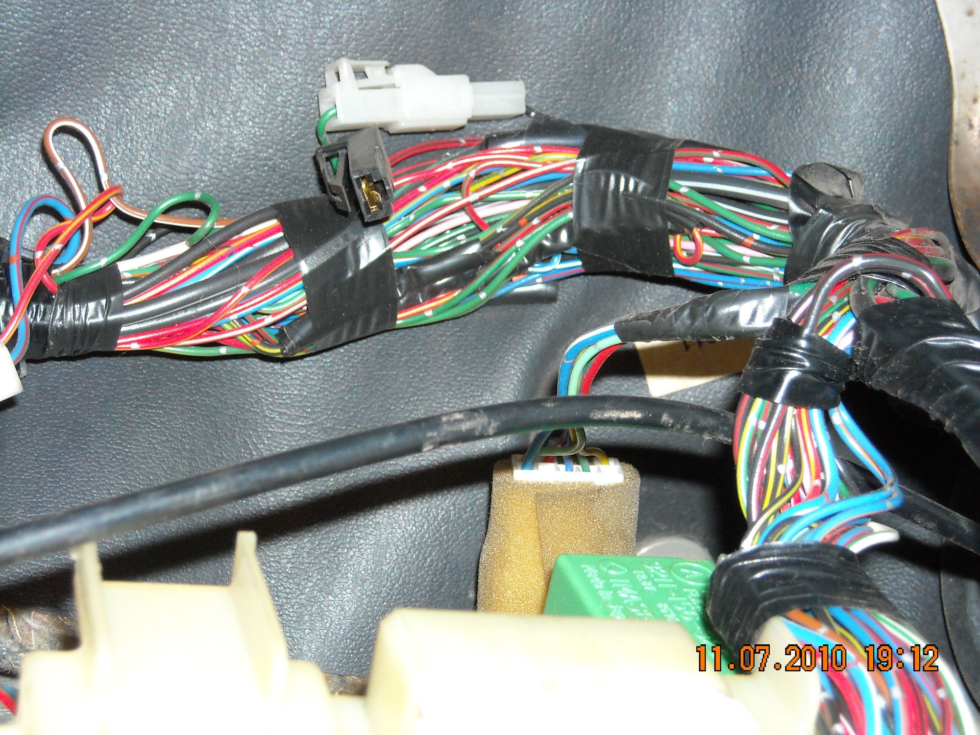

NOW.......do you see the THREE single pin wire connectors? Two are WHITE connectors........and one is a BLACK connector. Whichever two connectors that are plugged together on your truck........unplug them AND plug the UNUSED connector back into the other connector. This is EXACTLY what the Mazda dealership would do, after they changed your timing belt.
So, to recap.....if you currently have the two white connectors plugged together on your truck like the above picture shows.......when you unplug them, you should plug the black connector into one of the white connectors. On the other hand.....if you have a black connected to a white currently, then when you unplug them, you would plug the two white connectors back together.
In other words.......all that you have to do to turn the CEL OFF again.......is to SWAP a couple of wires!!! It really IS that EASY!
