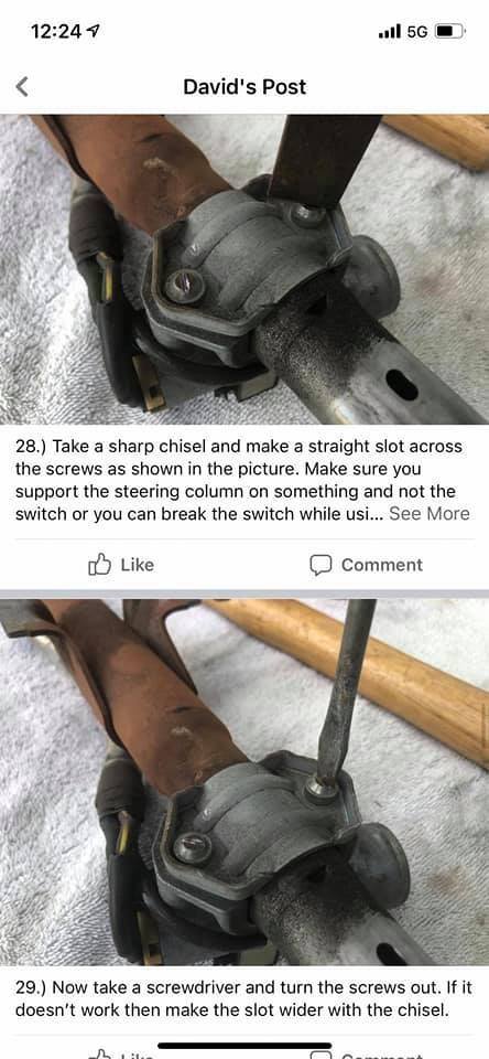

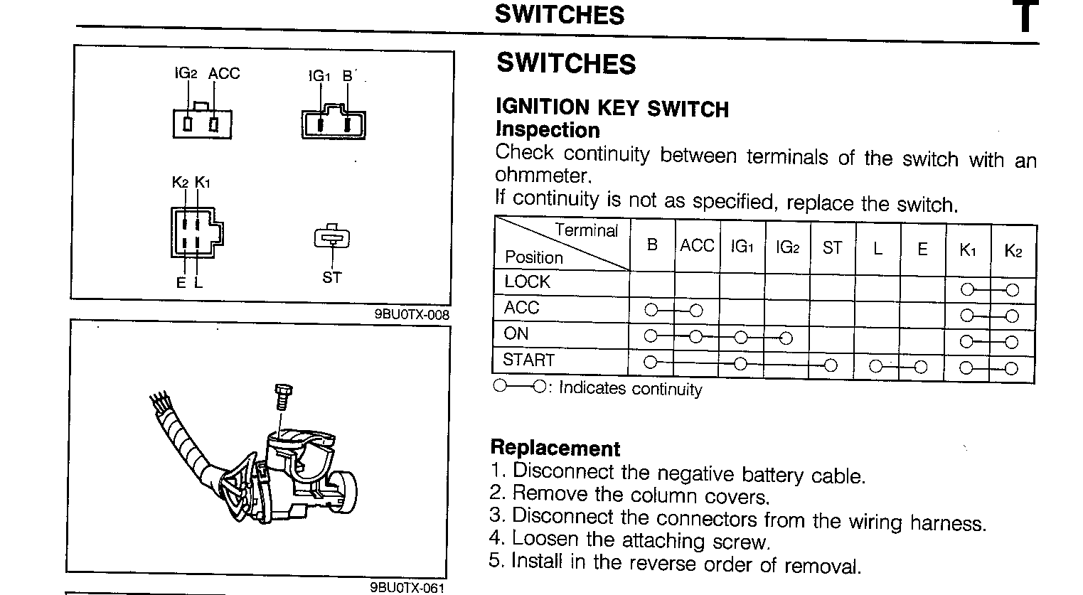

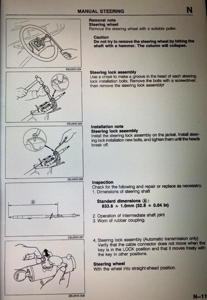

I still plan to rebuild the factory ignition switch. However, I have acquired a new switch assembly with the associated wires and connector. Is there anything specific I need to know about removing the old one and putting the new one in? Any tips are appreciated
