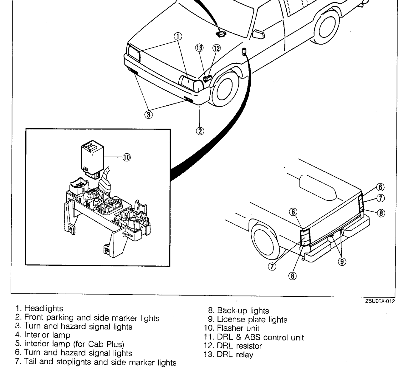

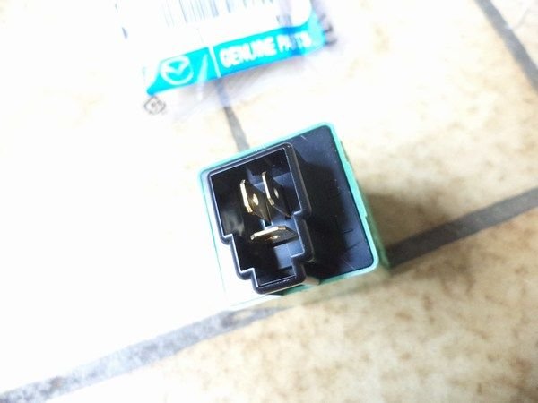

I have a 1987 B2600 and I have no hazards or blinkers. I ordered the flasher but I cannot find the location for the life of me. I found the timing buzzer under the drivers side dash but no luck finding the flasher

The flasher box goes right near the buzzer, under dash, driver side. I think it's green.
