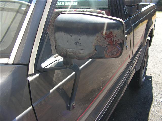

I have a nice old '88 B2600 SE-5 that I just put back on the road. I completed a Weber conversion, new brakes, new hand brake cables, and ball joints. It looks and drives pretty nice (for a 25 year old truck).
My only problem is finding a driver's side mirror. The current mirror is rusted and falling apart, so a replacement is needed. Unfortunately this truck doesn't have the usual corner mount mirrors that were the norm on B series trucks. This SE-5 series OEM mirror is mounted on a bracket that attaches to the door (almost like a mini towing mirror setup). Does anyone know where I can find such a mirror.
Dealerships are useless in my area. I've checked several, and they are no help with finding a part this old.
Thank You --

The thumbnail shows what's termed the SE-5 tow mirror, on SE-models such as yours.
Unless you can fix yours with bodywork, you'll need to search parts yards, Ebay, classifieds, etc. I have such mirrors on my 1988 B2200 but mine are in good shape as I'm in Arizona.

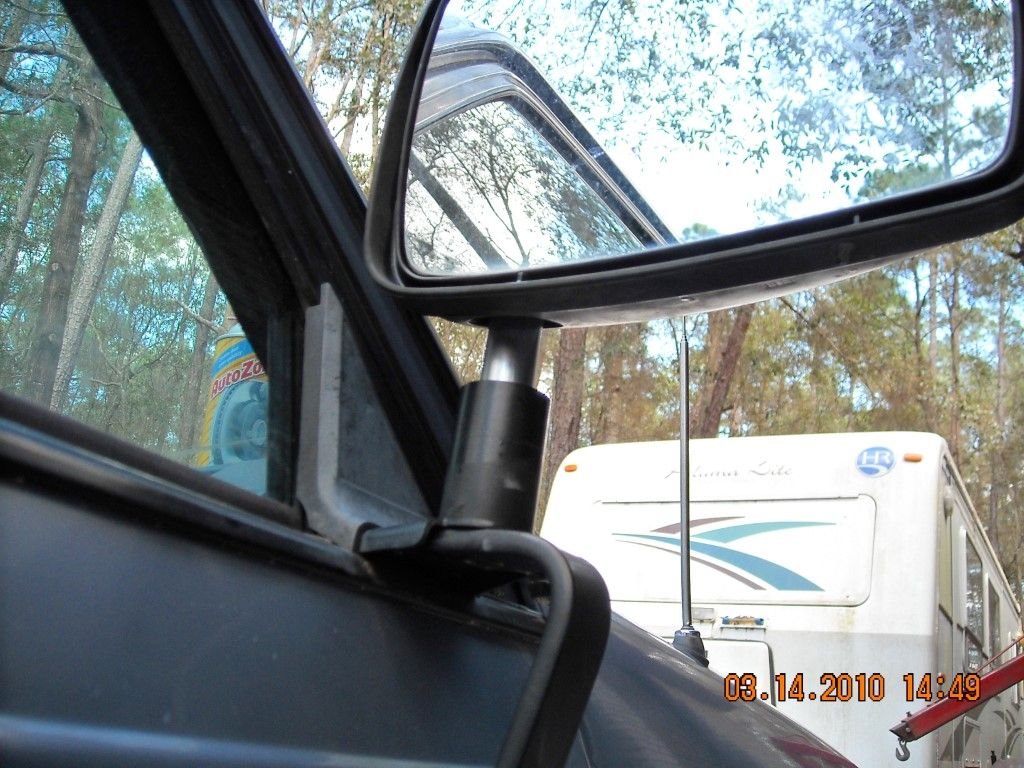

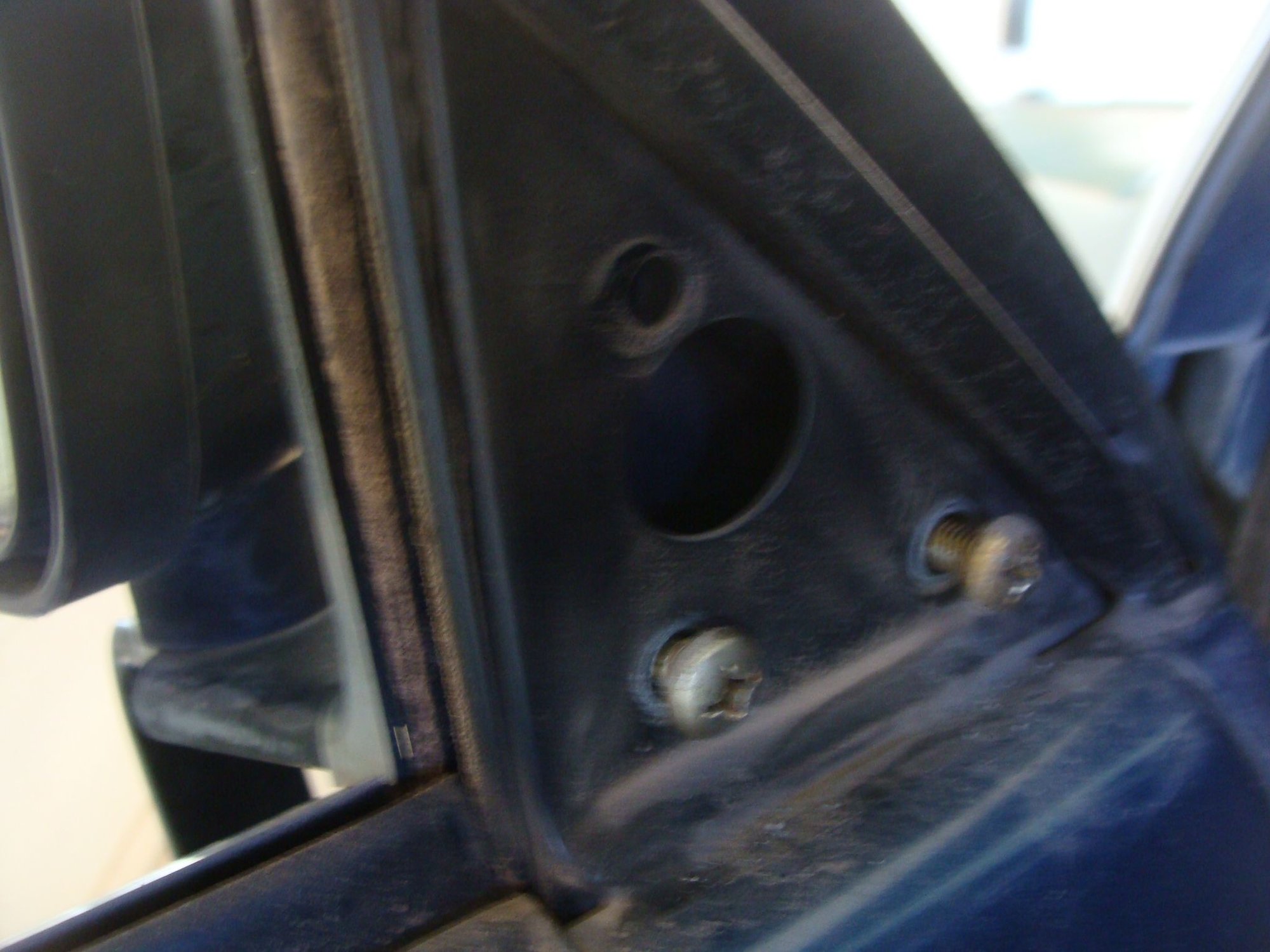

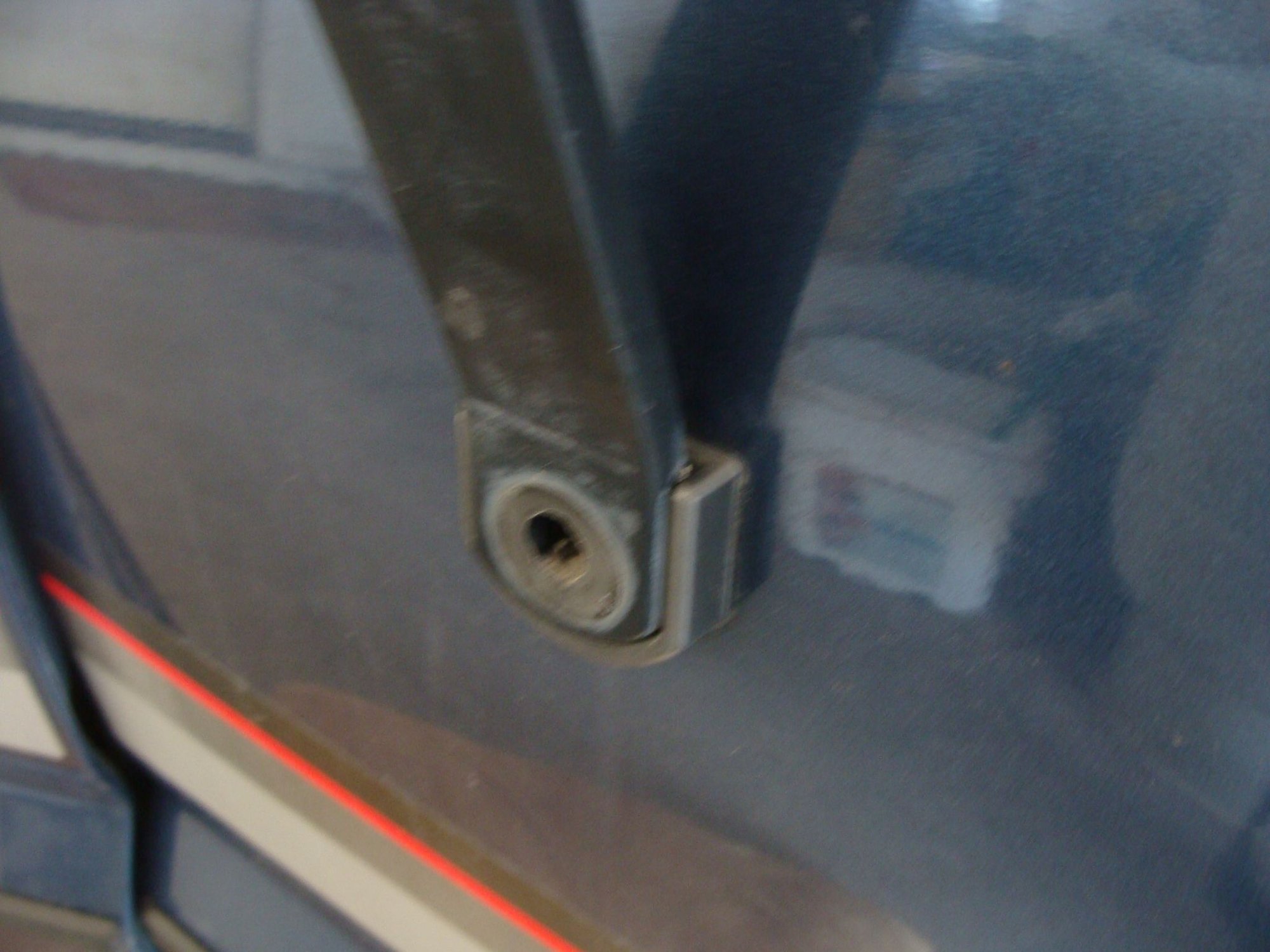

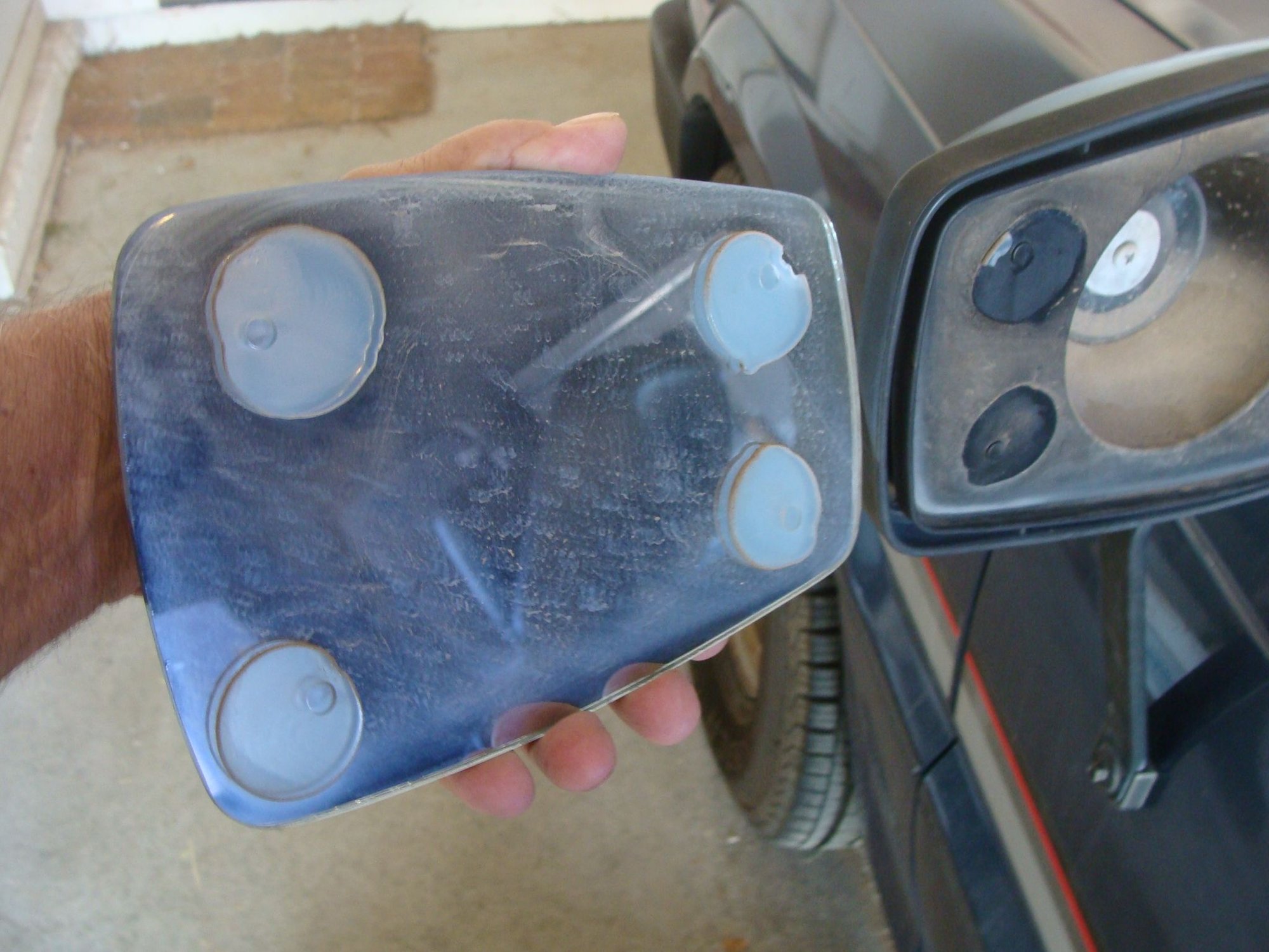

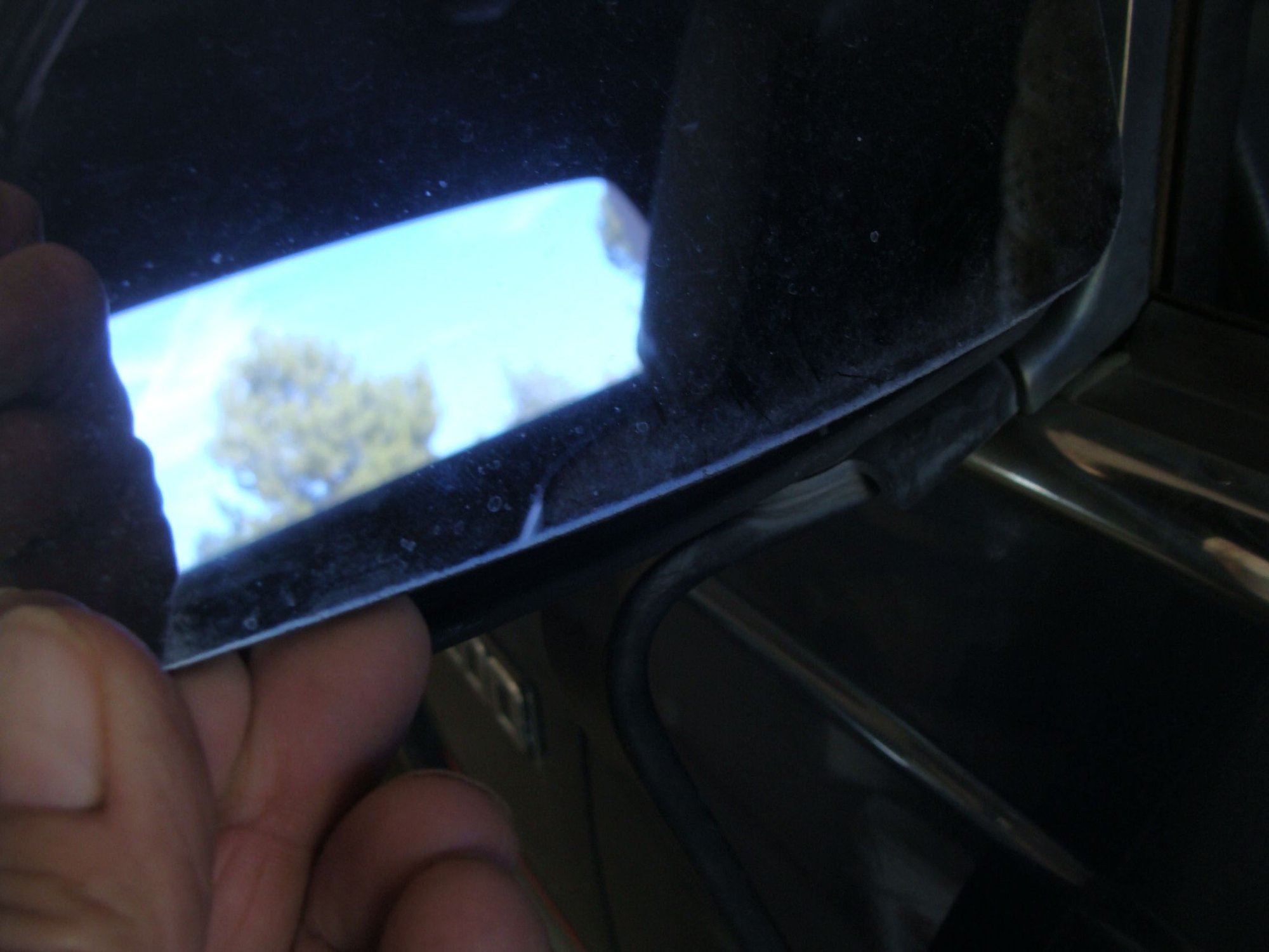

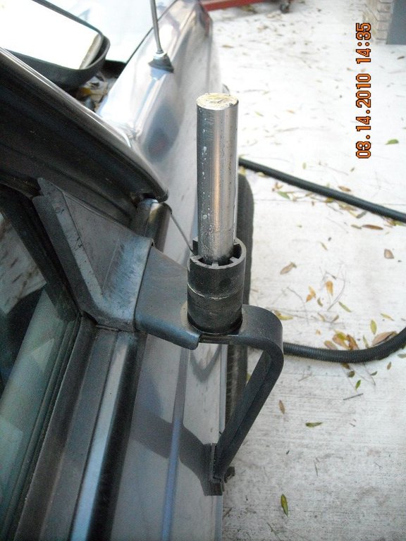

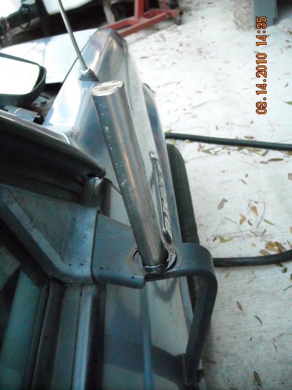

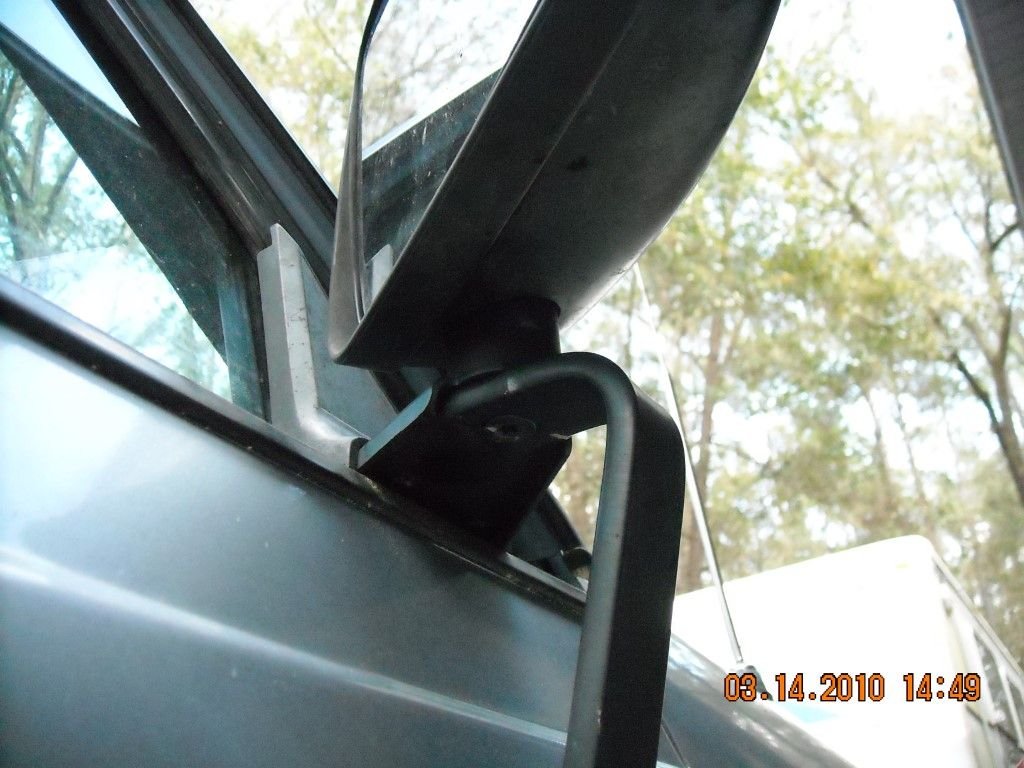

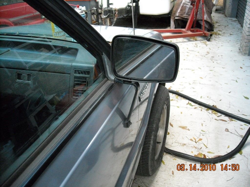

So.......what exactly is wrong with your outside tow mirrors? Are they rusted out? Or are they loose? The reason I ask is because they can be fixed in some cases. On the Mazda tow mirrors, the mirror head is just slipped over an aluminum post, and it can be removed by grasping the mirror head and pulling upward on it while twisting it back and forth. If it won't pull off of it's aluminum post, then you may need to spray some lubricant in behind the glass mirror to lubricate the post some.
Here are a few pictures of the tow mirrors......

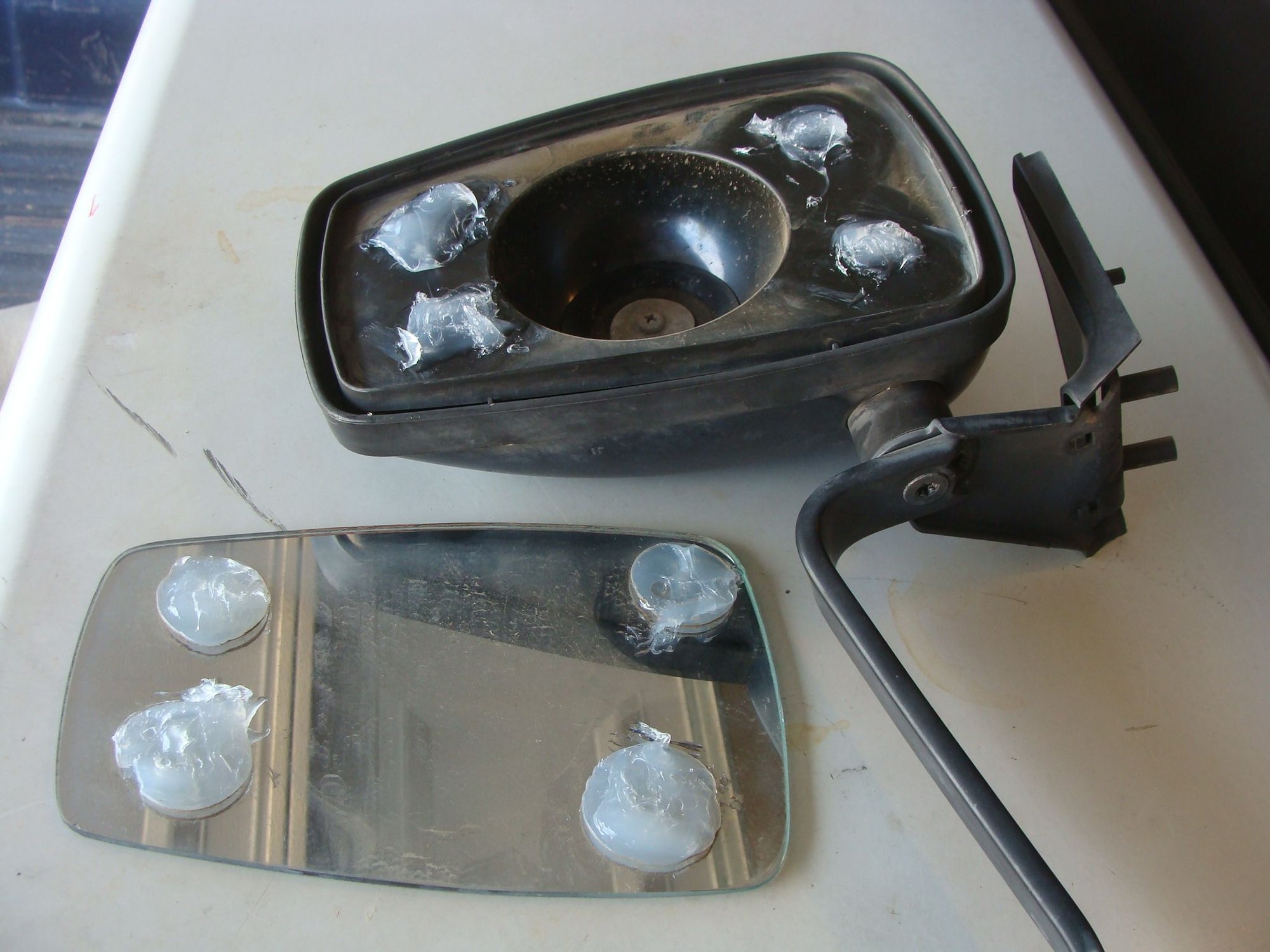

That's good information, Axel. My driver side tow mirror always seemed loose at highway speeds the last 20 years (1988 B2200 SE-5). Then it got worse and the mirror glass was loose, so I took it apart and re-glued it with silicone glue. Fine now.

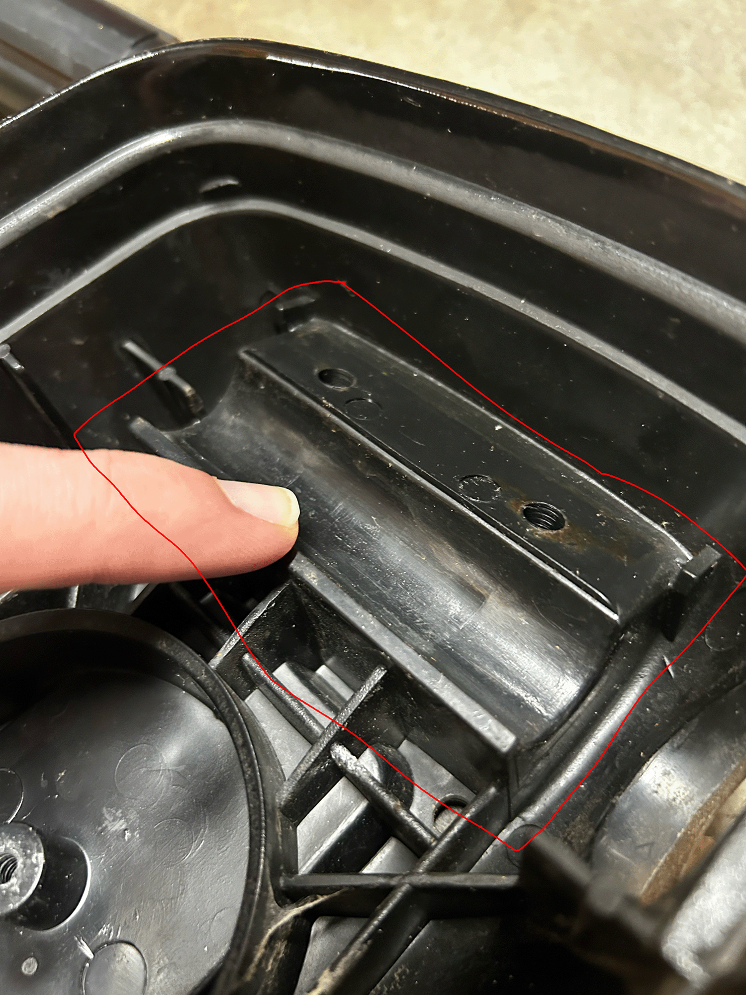

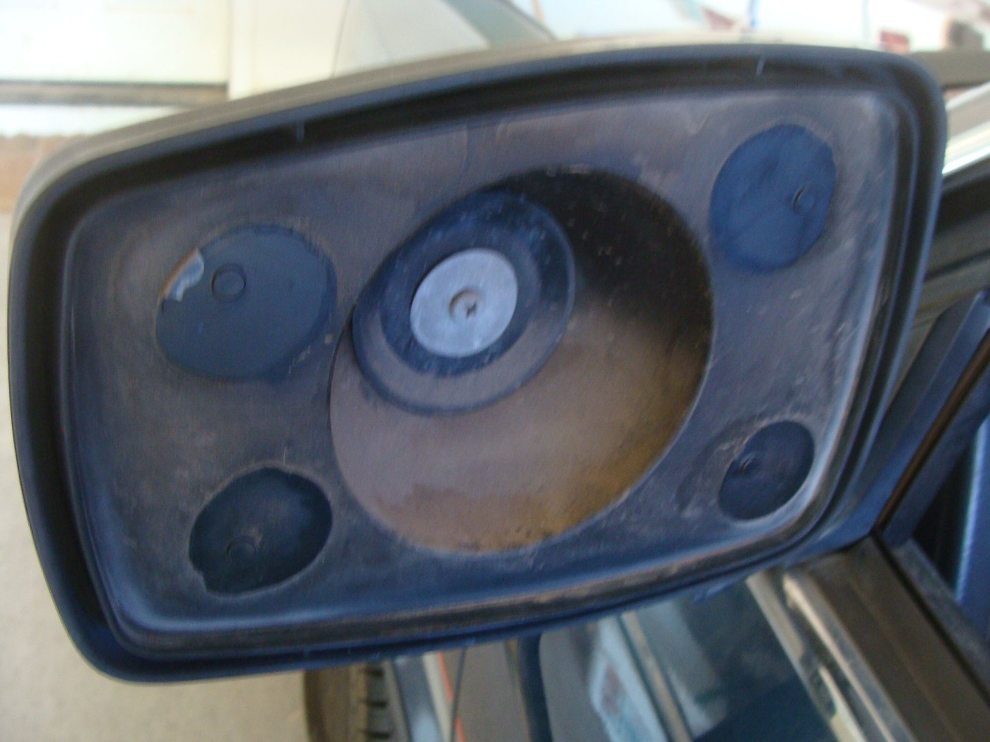

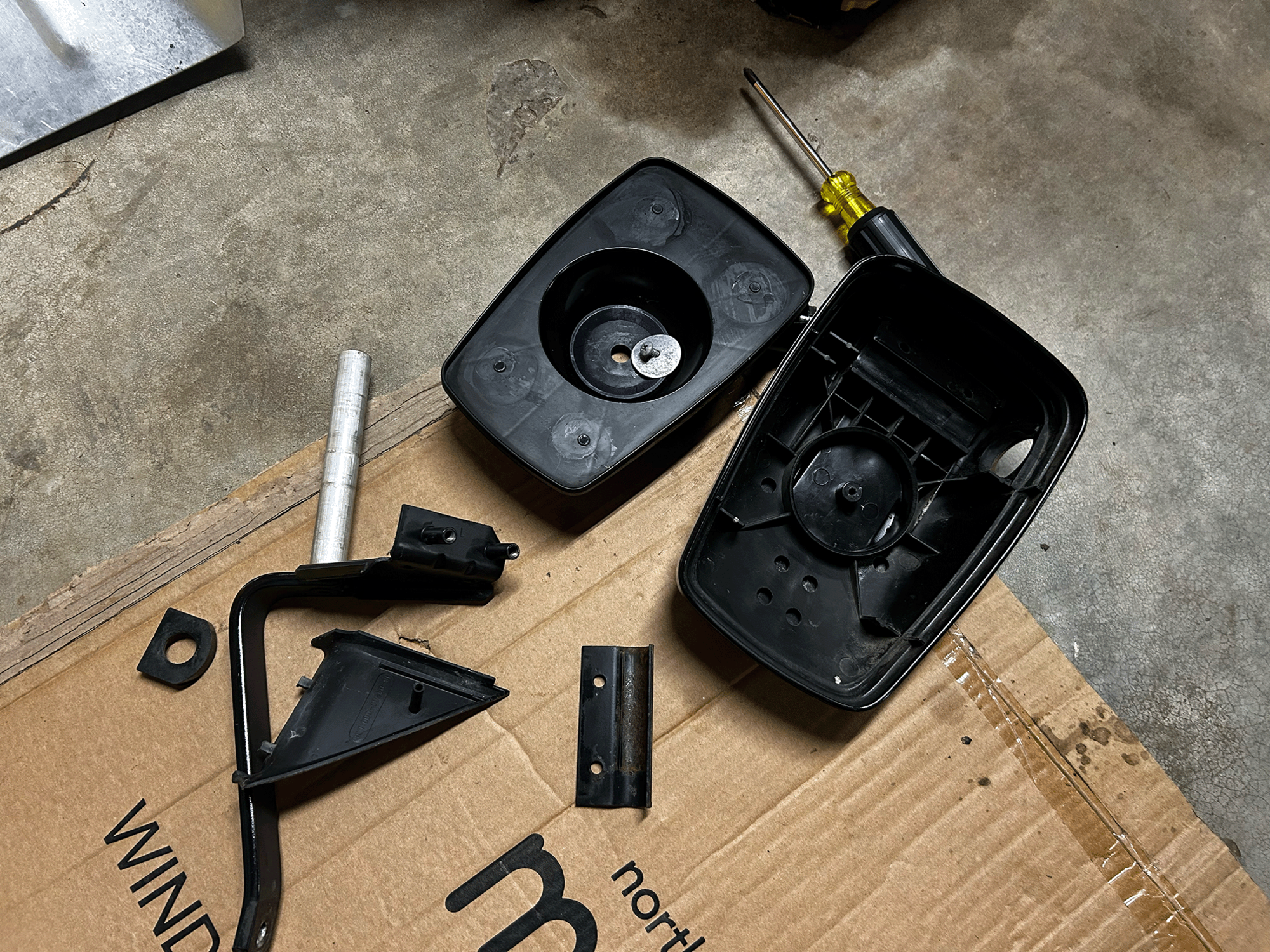

It was loose, so I took it off and found that one of the two screws that hold it onto the pole wasn't all the tightened down. I tried to tighten it, but realized there was a nut on the other side of the plastic that I couldn't get to, so I unscrewed it (not realizing my mistake) and realized too late that the plastic housing is completely sealed. I've tried using a pry to separate the plastic from the metal, but no dice. I think it's glued, because it wouldn't budge. On top of that, the mirror itself is broken now, so I'd have to find a replacement glass anyways.
Not my shining moment in the sun.
On the bright side, I did redo the wiring for the license plate and got the interior dome light working by bypassing the switch, it's the little victories...
If you've got any know-how, I'd be glad to hear it. Otherwise I may just bite the bullet and get that replacement.
all remaining parts, the mirror itself is broken now, unfortunately
sealed housing where the loose nuts are
plastic fitting lip
plastic fitting lip

When I originally posted the thread about fixing your tow mirrors, years ago on a now defunct Mazda truck forum, I stated that you should not try to remove the two screws inside the mirror head (like you found out!) as it will ruin the mirror. Just spray some type of penetrant in there to help release the "grip" of the mirror head to the aluminum pivot pole, and pull the head off of the pole. I too ruined a mirror head when I loosened those two screws!
