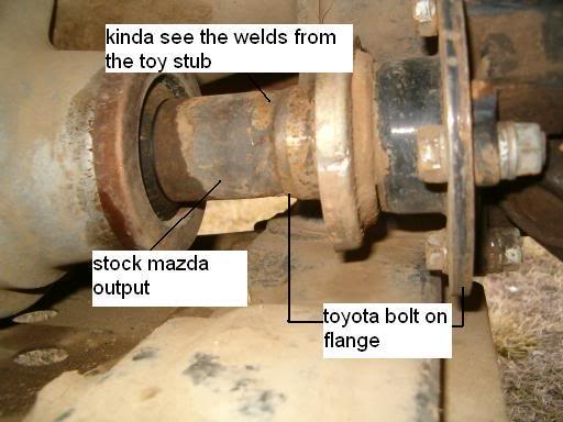

for the rear i just used the mazda d shaft, and had a driveline shop put a toyota flange on it for the rear diff. for the front i took a toyota case, cut the front output shaft off just alittle behind the splines, then i took my ase apart pulled the front drive gear and shaft, its all one piece. the little piece of toyota shaft sits just inside the mazda shaft. welded that on there and then it allows the use of a toyota bolt on flange.
Attachment 7365
Which model Toyota transfer case did you get the output shaft from?
