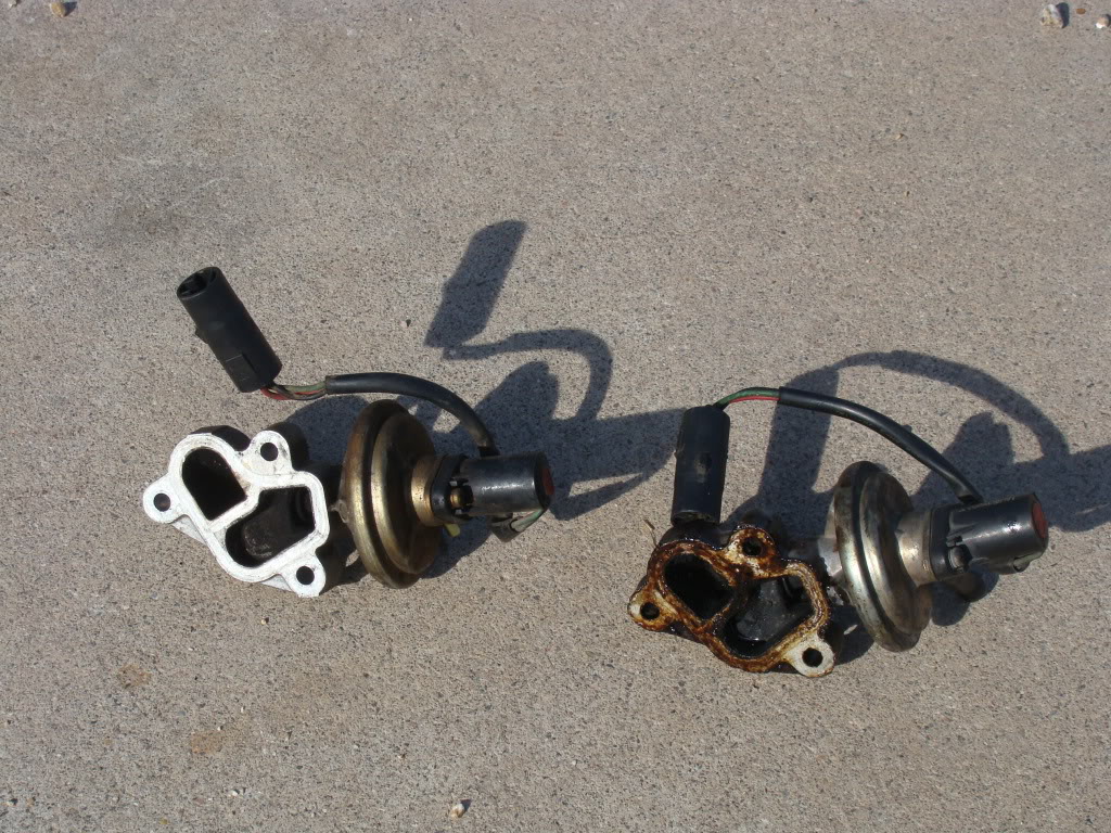

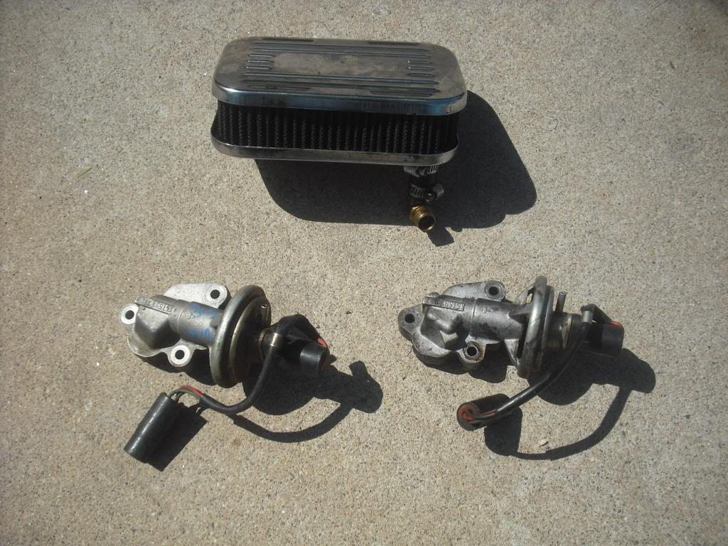

Originally Posted by Mr_Leffe
Mazda tells me I have to buy the whole Valve ($304) part #20-300
I've got two working used B2200 EGR valves available, WAY cheaper than that (in Arizona). The valve operation of each has been checked with a hand vacuum pump; both open when vacuum is applied, and both close when vacuum is released.
The brown stuff on the one is Permatex, I can remove that with alcohol.

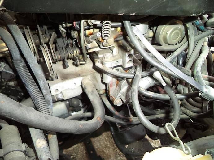

I removed the EGR and cleaned a coalmine of carbon out. Replaced the unit and the Check engine light now gone. I did find an uncapped vac hose on the right side of carb base. Engine appears to run the same plugged or not. The left side one disappears in a harness of its brothers. Any knowledge where the loose boy is supposed to attach to?
Old Feb 2, 2015 | 02:38 PM
hixx's Avatar
Joined: Aug 2007
Posts: 1,324
Likes: 1
Not without a picture. Those have a ton of vacuum lines.
Old Feb 2, 2015 | 03:17 PM
Mr_Leffe's Avatar
Joined: Jan 2015
Posts: 16
From: california
The one with the Golf Tee. Does it connect to somewhere under the Air Cleaner?
