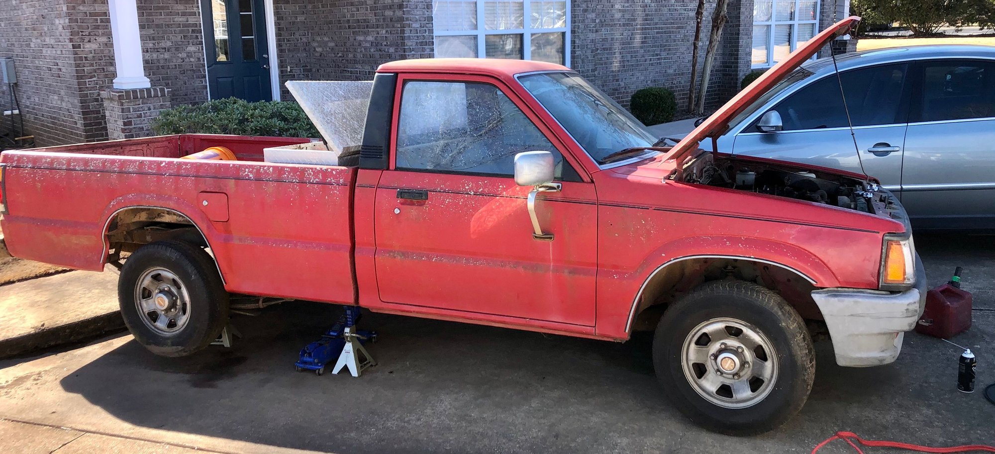

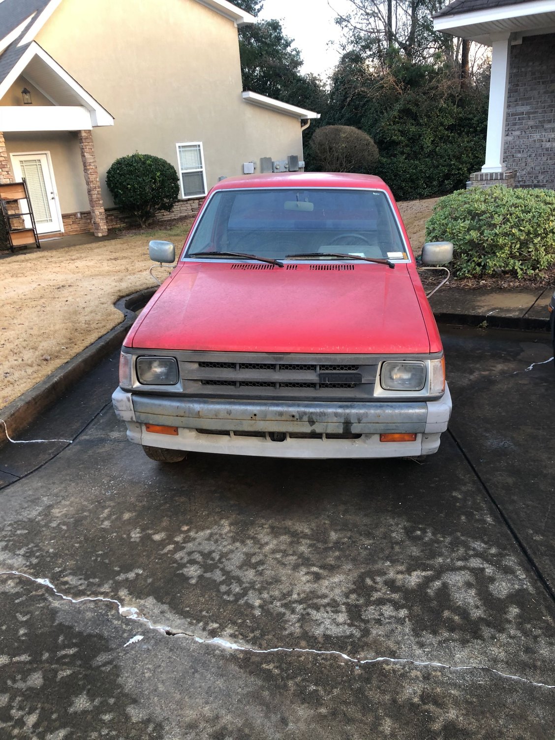

Hey everyone, I’m new to the b2200 and the forum. I’ve got an 88 B2200 and the mechanical fuel pump works well, but it doesn’t seem there is any fuel getting into the carburetor. I’m not sure how to proceed in figuring out the issue. Could I get some pointers? Forgive me if there are similar threads, I tried searching for them and didn’t find any that seemed helpful.
Bonus info: got the truck free at 150,000 miles last weekend.

Congrats on a free truck! Post a picture of it if you can.
