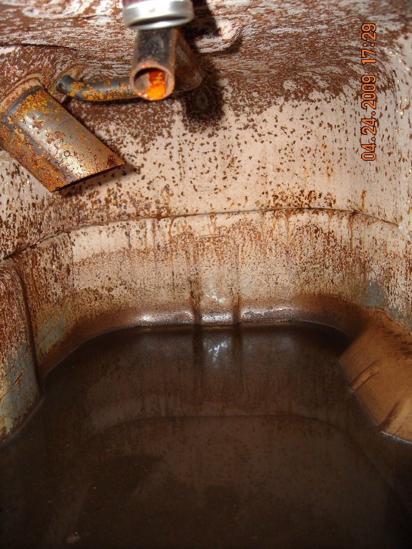

Only one fuel filter came on these trucks from Mazda......it is the one that is held by the wire "bracket" on the wheel well. A previous Owner probably installed the second one.....probably/maybe because the gas tank on the inside is rusty? If any vehicle sits for a long time, and it has a steel gas tank like these trucks do, then it can rust inside of them.......mainly because the gas we have to use these days has Alcohol in it, and the Alcohol attracts moisture. If the tank is rusty, then the carb will get some rusty sediment in the bowl area, which could start to clog passageways in the carb, creating performance issues.
Here is a pic of the inside of a gas tank in a parts truck that I bought years ago......and the rust got past the fuel filter and into the carb. Truck still ran good though.....

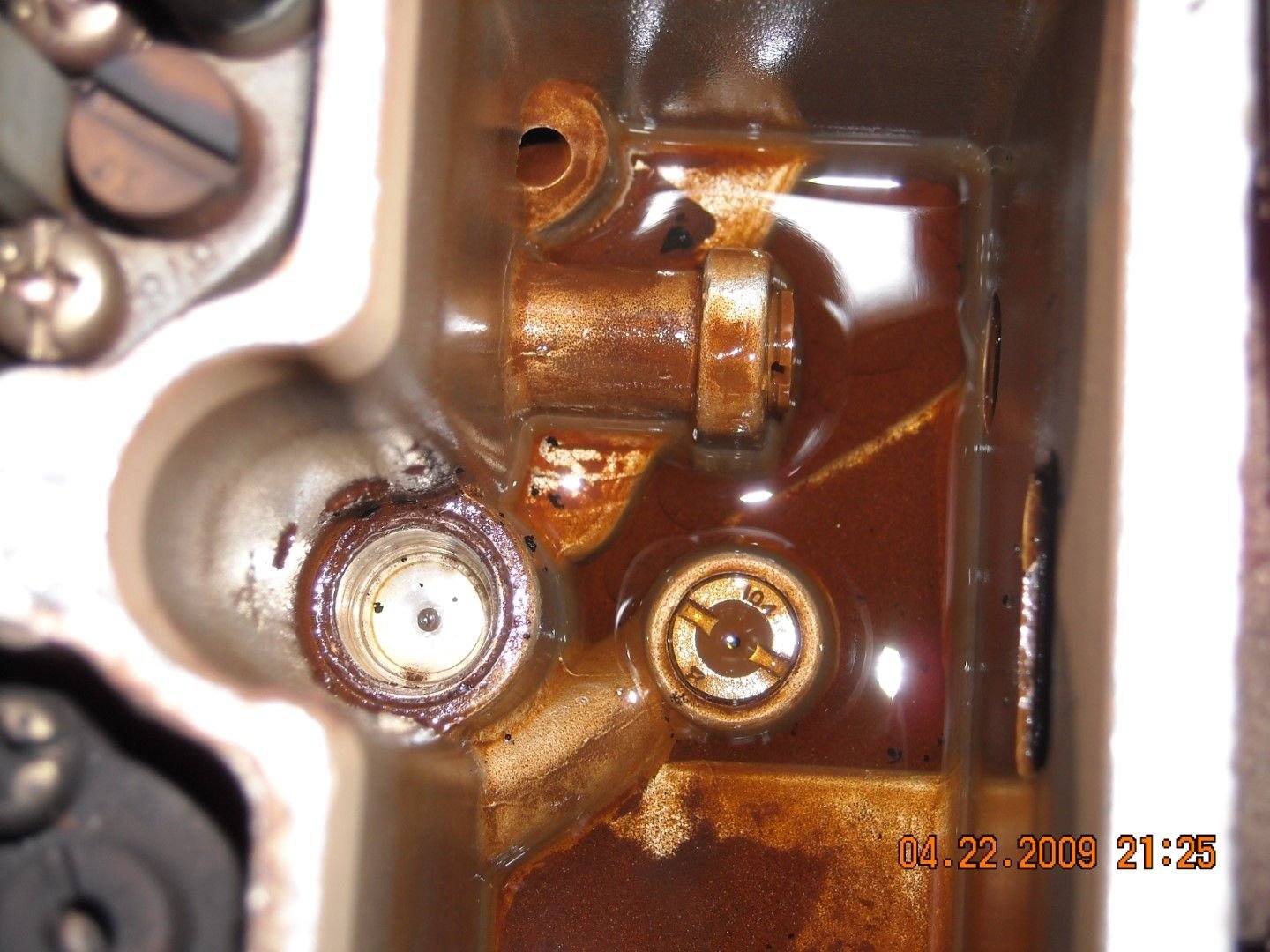

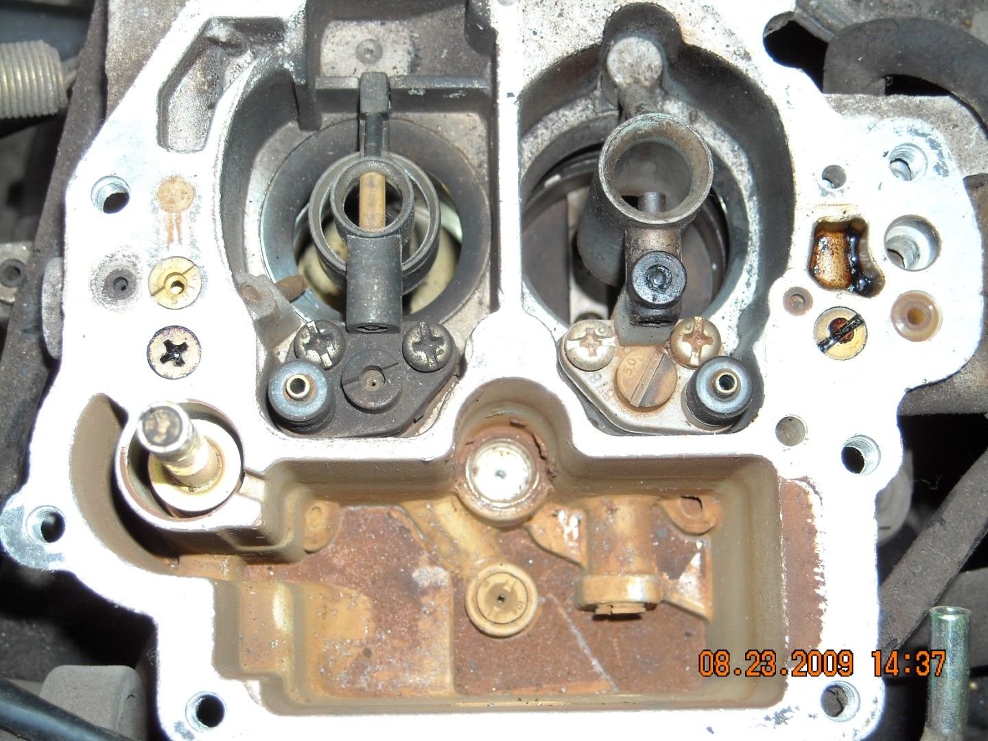

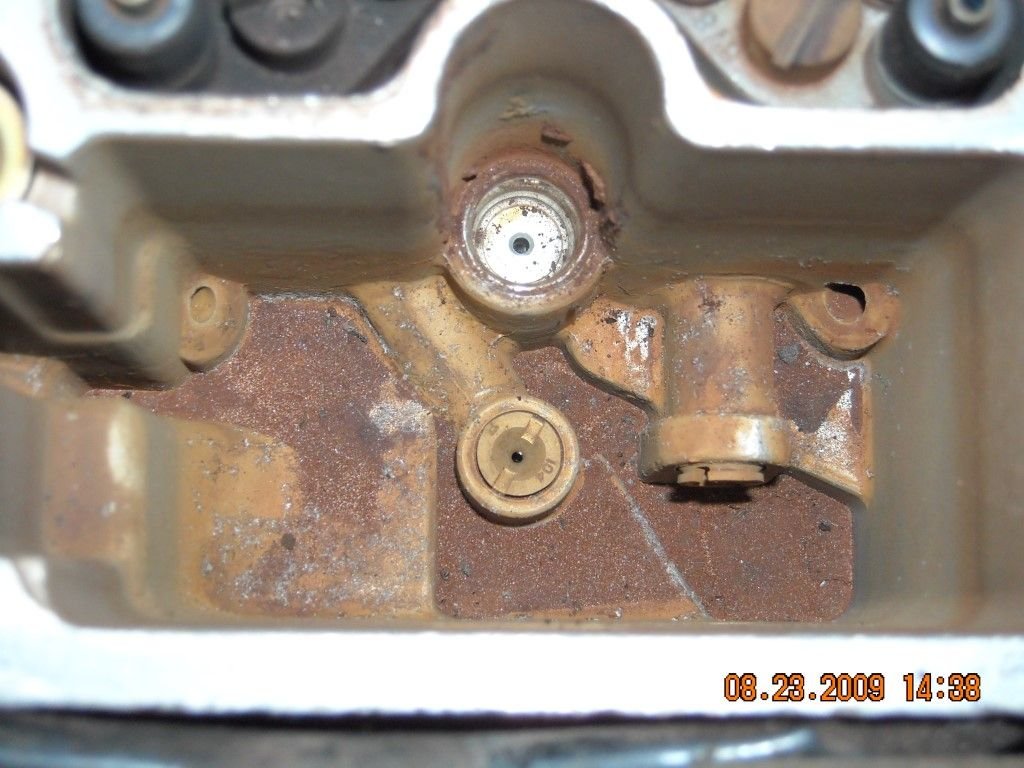

Factory carb fuel bowl......and the truck had a good, fairly new fuel filter on it.....
After the gas evaporated, it left all kinds of sediment......

Big difference living in Arizona with less moisture!!! Here's a picture taken inside my own 1988 B2200 fuel tank back in 2009 with the boroscope my daughter gave me, not a speck of rust.
