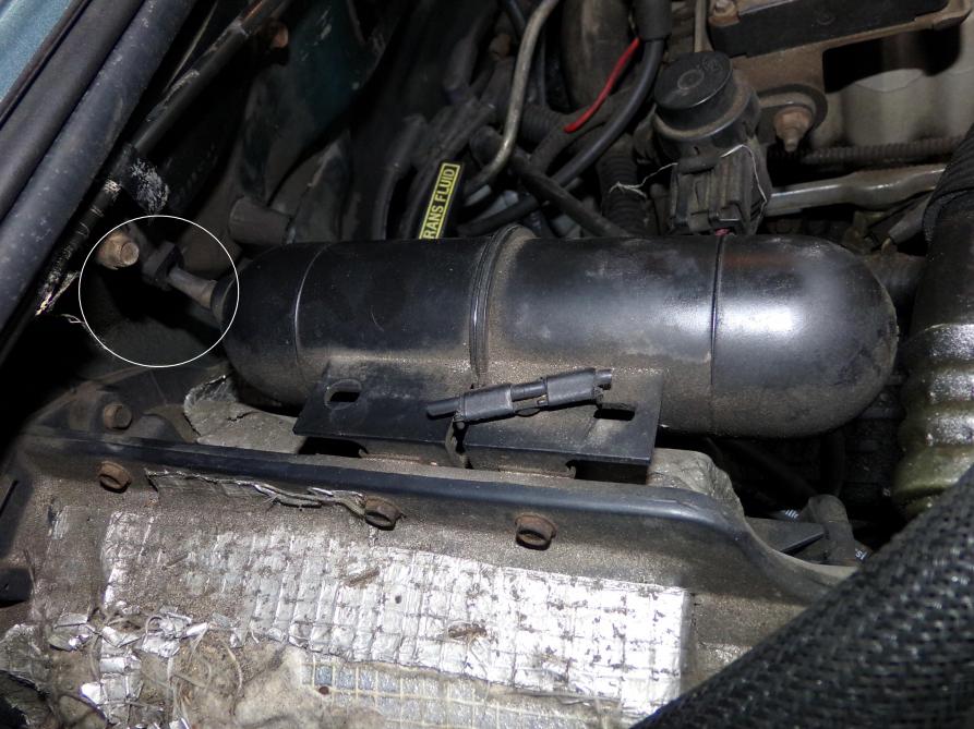

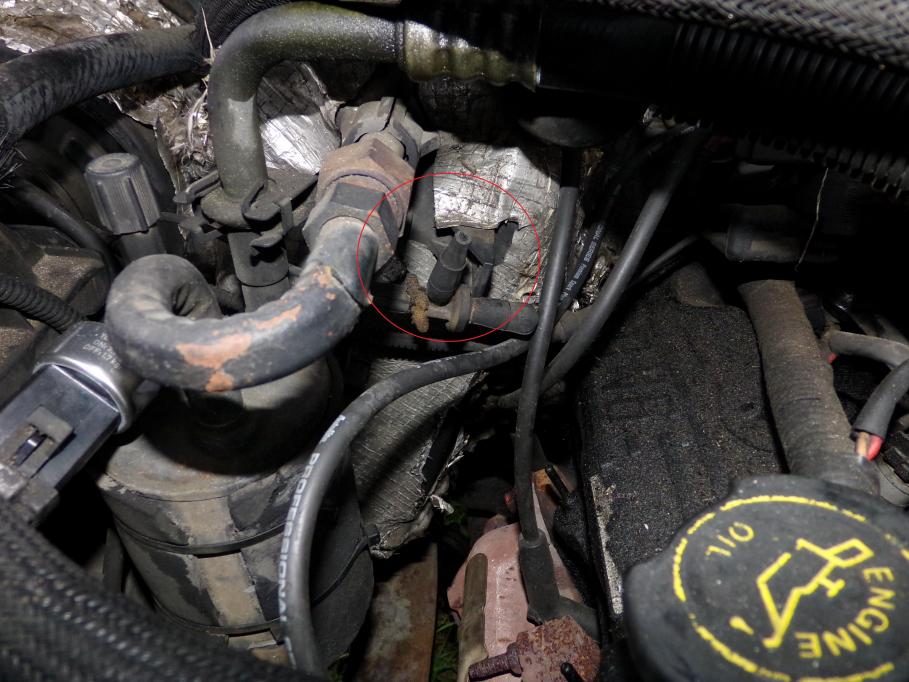

Vacuum may be a good place to start. I have found 2 places that look like there should be a rigid vacuum line but I really don't think the 2 places connect together but can't find anywhere where they should connect.
Attached Thumbnails 1994 B3000 check engine light-gedc0255a.jpg   1994 B3000 check engine light-gedc0256a.jpg

honestly, I am not familiar with this engine. There should be a vacuum diagram under the hood or you may find one using google image search. The B series truck is a re-badged Ford Ranger so you may search under the ranger name as well. "The Ranger Station" is a dedicated forum for these.
all the best.

May have been a vacuum leak. I did a search on the engine I have and found a picture that shows the vacuum the 2 pictures I posted where there circles are should be connected. Since I replaced the vacuum line the engine light hasn't come on. The vacuum diagram under my hood was hard to read and I wouldn't have known where this line would have been on the engine. Maybe I should find that picture again or just post a picture of what I fixed.
Thanks...
all the best.

Nice job! You should be good.
