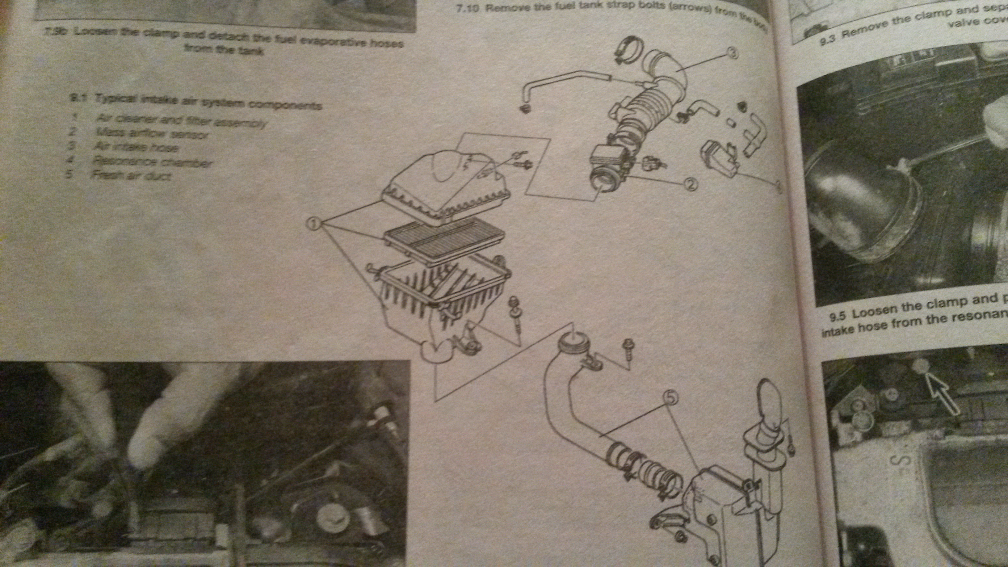

It will do no harm cleaning the throttle body with the carb cleaner too. Give the MAF sensor a quick blast of the carb cleaner too. If the air filter was dirty, chances are the MAF sensor is dirty too (this may contain a temp sensor also 2in1). On mine there was a clump of dirt on 1 side of the sensor (side nearest the air filter), easy to remove the sensor, think it has ZL10 written on the top of it, a few quick blasts of carb cleaner and all the dirt came off on mine.
It's also worth having a good look at the breather hoses (have a look at the picture attached), there could be a small split in one of them. You could be getting an air leak. You'll need to take them off to get at the throttle body if you're give that a look.
