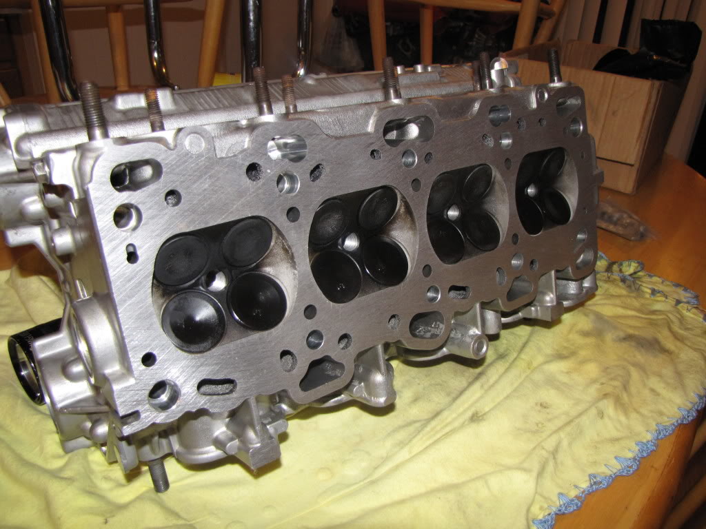

If you look at the 4 corners, you will see how the head gasket surface is not parallel to the valve cover rail.
It is close, but still off
This is the surface finish left by a belt sander

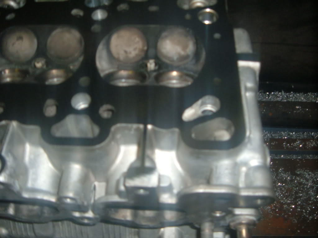

This is how the surface looked after I milled appox .002

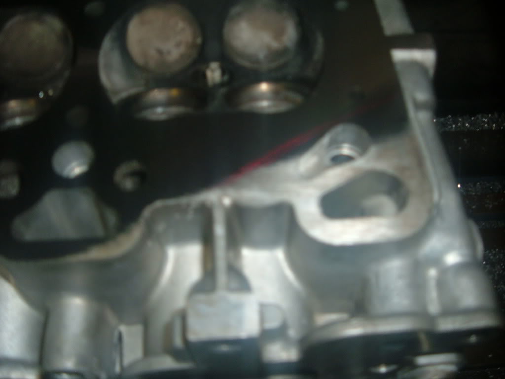

It did cut most of the surface, but it was still low at one corner, and it would happen to be right around the oil feed port to the head.

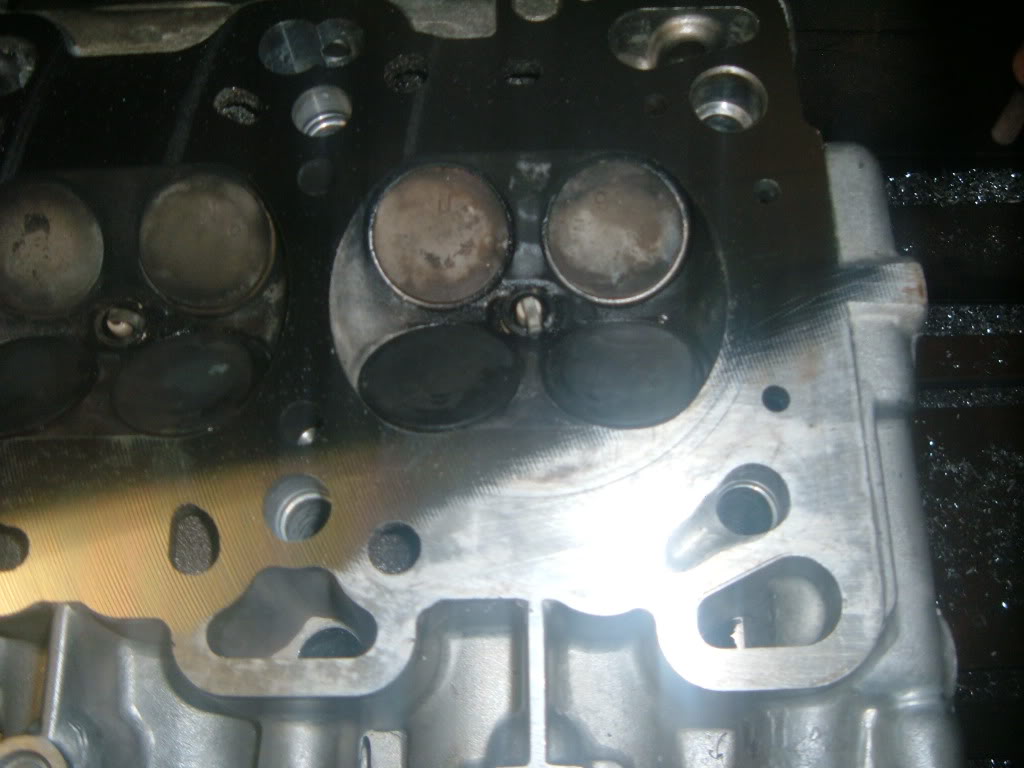

I made another pass of about .002
This is how it looked.

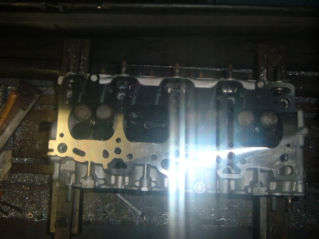

I made another .002 cut
And was to this

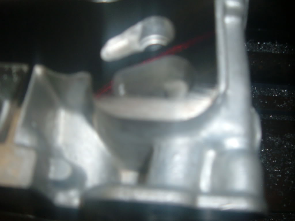

So one more pass to clean the gasket surface, and proper clamping force will be kept on the head gasket.
