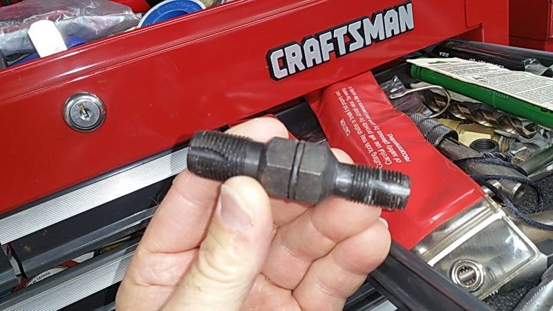

I've never seen or heard of a spark plug thread chaser---I'll look into it. Thanks, Callisto.

Here is one of a few I have on hand for spark plug thread chasing.
I highly recomend with any damaged thread to do a permanent thread repaid using a Time-sert. I keep a large section of Time-sert and thread remover/ extractors mostly for DIY customers, friends and family that had troubles...... hahaha!
