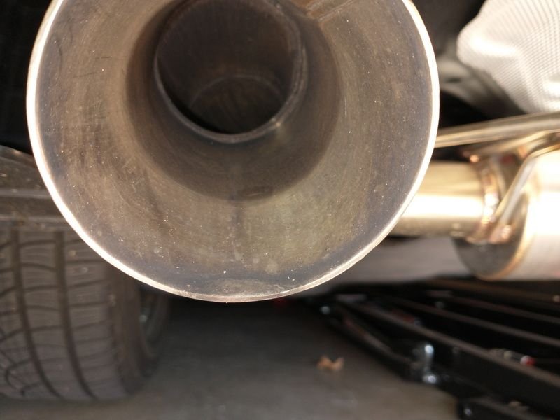

I am sure if you took a clean whit wipe or your figure in your sons tail pipe it would come out some what black? Other factors effecting the tail pips , gas type (brand) and octane, ambient operating temperatures', state of tune and the supporting parts, air filter, spark plugs, MAP, IAT sensors, battery to name a few.
My Mazda is about as well maintained as humanly possible and because 5 days a week I drive from cold start round trip to wife's work and home less than 3 miles I get pictured below.
Exhaust is highly corrosive and toxic unless it is removed by exhaust velocity and the high exhaust temperatures. The longer down the exhaust system from the time it leaves the combustion chamber you will not only support long power but maintain a very clean exhaust system. Most however don't really go to that extent of upgrading the stock or performance exhaust systems to benefit that.
I just took these pictures for this thread, miles on late production 2018 2.5 N/A 42904 miles.
A quick run of my figure at the trialing edge of tail pipe.
