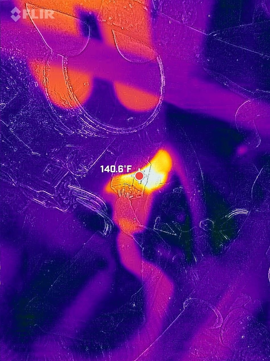

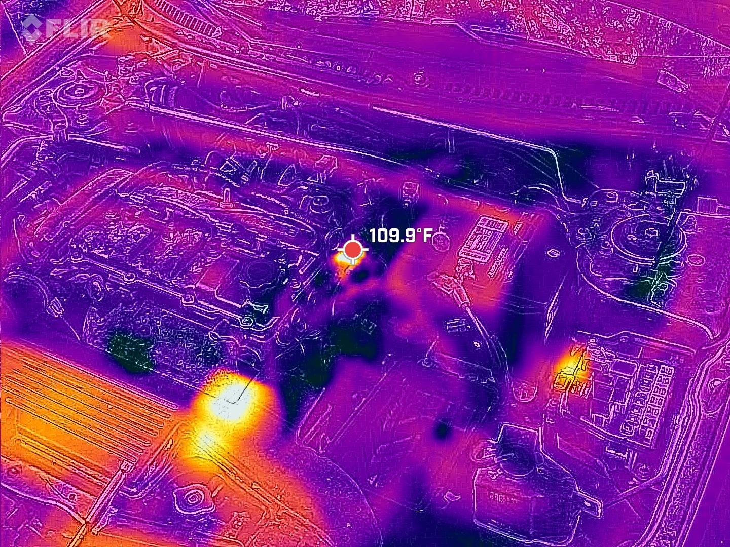

While inspecting the EGR I noticed it was quite warm to the touch. The engine doesn't start so it can't be driven so why is the EGR hot? The ignition is in the off position so it must be getting power constantly to it. I have a Flir One Pro and I used it to take a photo of how hot it is getting with an astounding 140F. The first thing that came to mind was “there must be a short circuit”. But no fuses popped.
So my main question is before I get to too detailed into other troubleshooting steps I have done is, Should the EGR always have power with ignition off and be this hot? My thoughts are “No”.

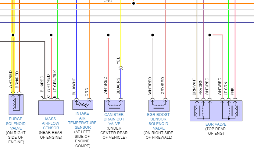

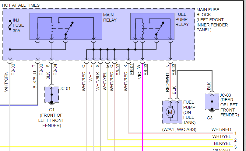

Nothing on the internet indicates that should be normal but also nothing on the internet that says it’s not. I just find it off or hard to believe that would be normal. My understanding is that the EGR has a power wire (WHT/RED O) that sources from the Main Fuse box directly to the connector of the EGR valve but also the same hot wire feeds power to other components like (Purge Solenoid Valve, Mass Airflow Sensor, Canister Drain Cut Valve & EGR Boost Sensor Solenoid valve).
Main Fuse Box with (WHT/RED O) wire to EGR Circuit
Wht/Red power wire to EGR shown in wiring diagram.

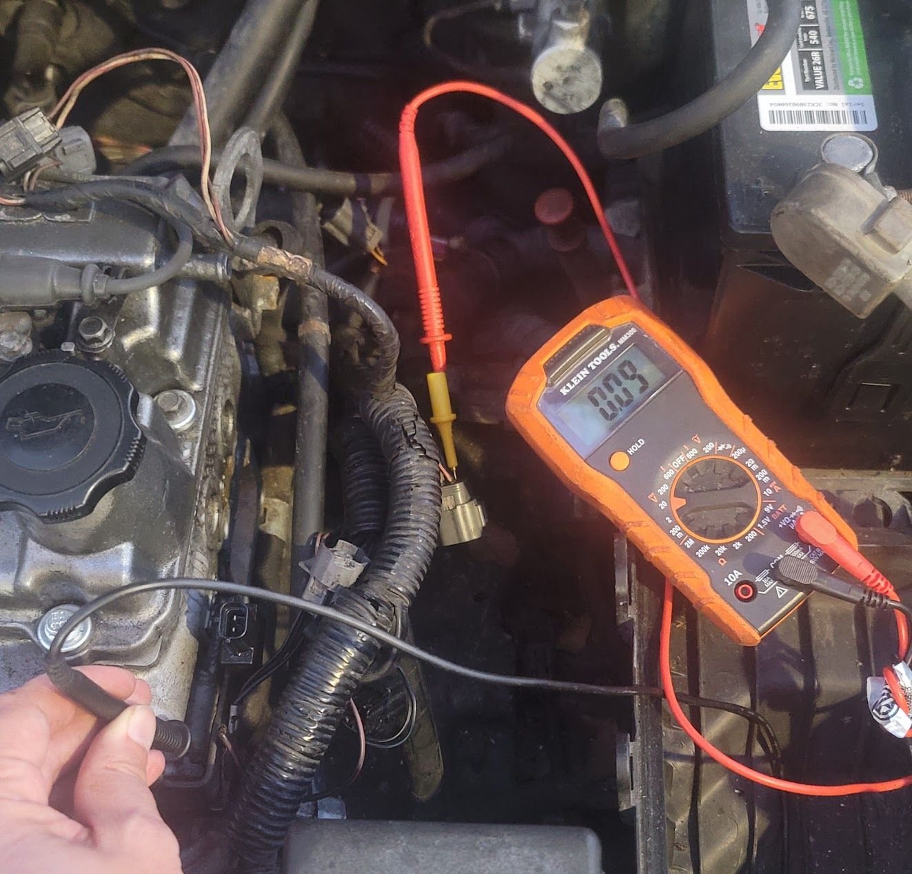

With the ignition on, I checked the two wht/red power wires at the EGR connector on terminals C & D and I get battery voltage as expected.

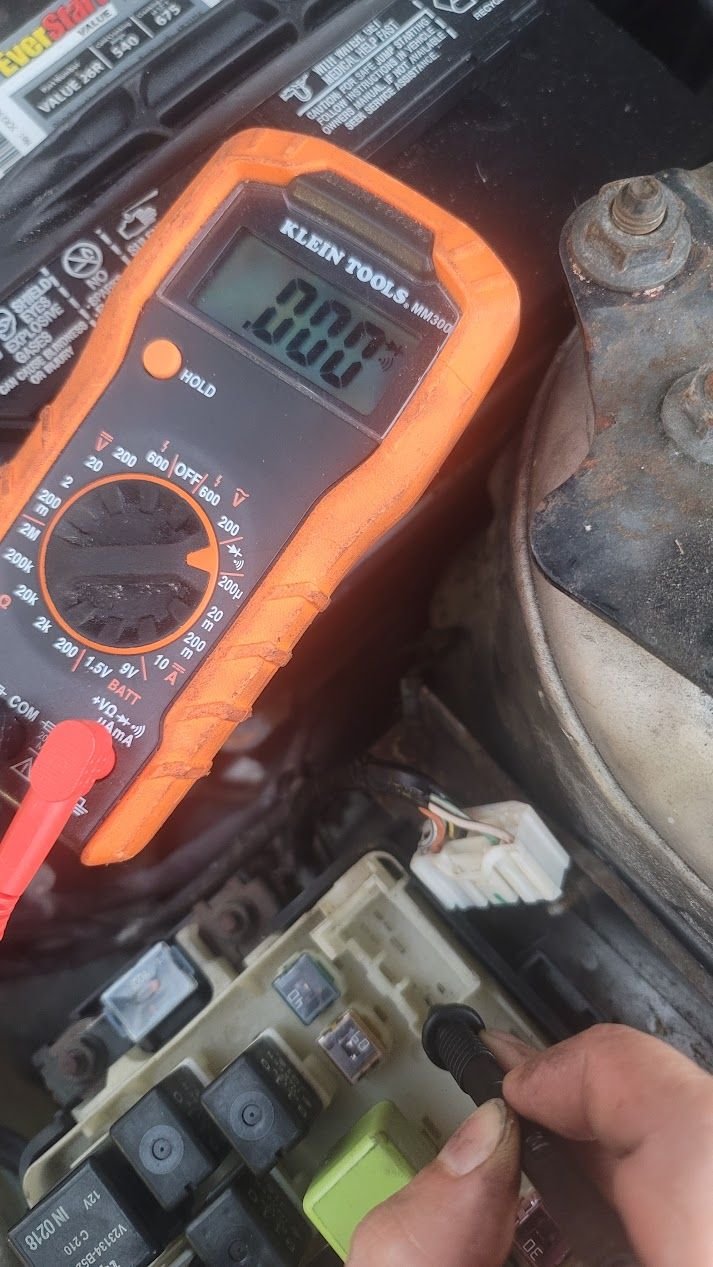

When I check voltage at the fuse box with the Ignition off I still show some power (.09V) of the 20V max range on my MultiMeter
Low voltage with Ignition off. Power from Main Fuse Box
I disconnected the battery power cable and performed a continuity test with the EGR connector (wht/red) wire and the lead inside the fusebox that makes connection to another connector of the same wiring color scheme and it tones out with good continuity. The wire coming from the EGR connector enters the Main Fuse box from underneath.
When I perform a continuity test with the Connector in the Main Fuse box I get nothing. I was expecting a tone out but I guess that could be normal since I am not directly completing the circuit with the connector being in place?
Conntinuity Test with Fuse Box Connector, no tone.
I am guessing that possibly the Main Relay could be the culprit being faulty and providing power when it shouldn't or there is a ground fault. Not sure but Looking forward to your feedback!
