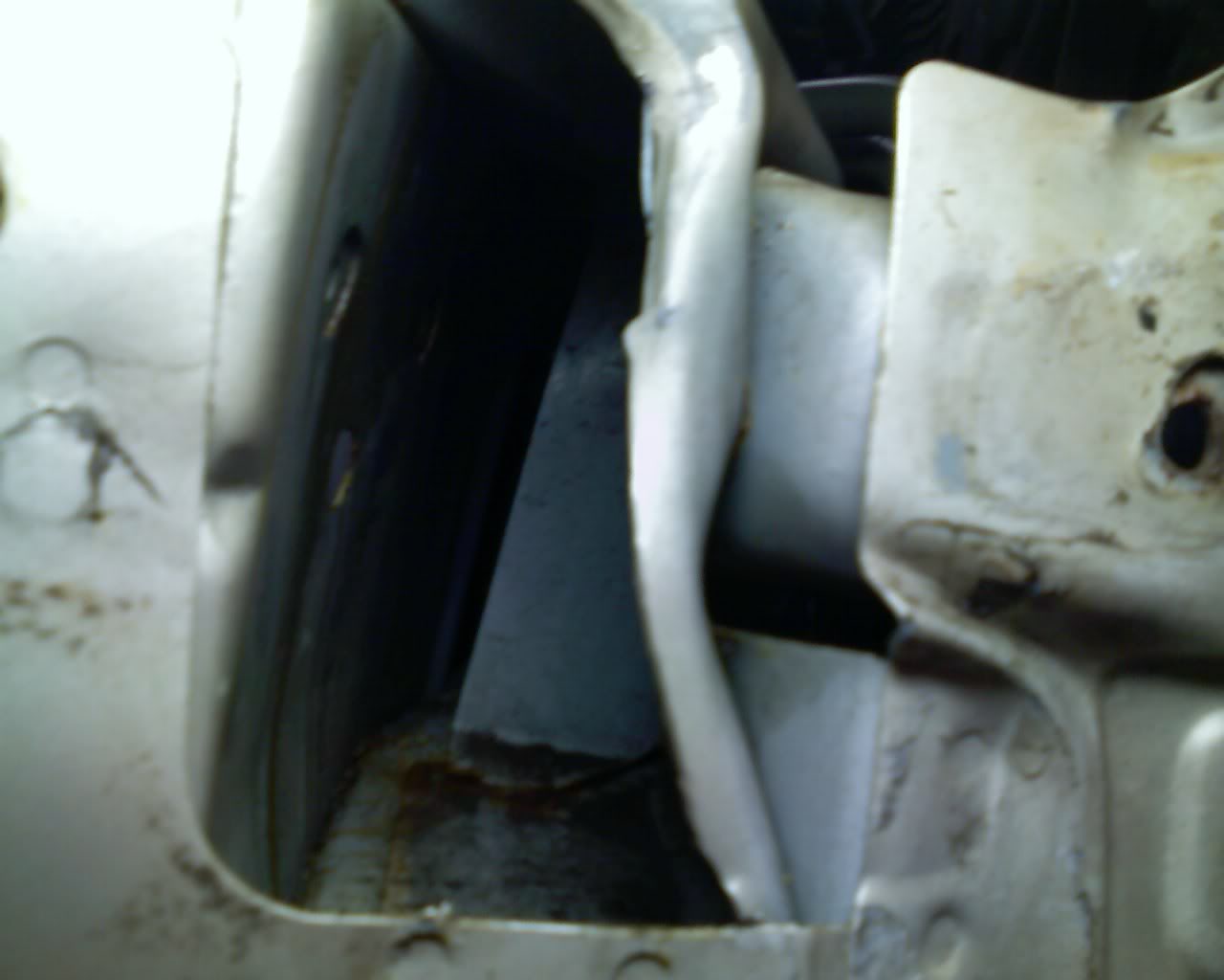

I've done a little research and I've found that some people have engine mounts with liquid and some do not. I've also found that front end collisions tend to break this particular engine mount. Partially because of the impact, partially because of wear.
I took some pictures with my cell phone of the damage.
The reinforcement bumper doesn't seem bent. The frame itself is whats damaged. Can a shop work the kinks out? about how much do you guys think it would cost me? I can't seem to get the bumper to line up at all with the frame so bent.

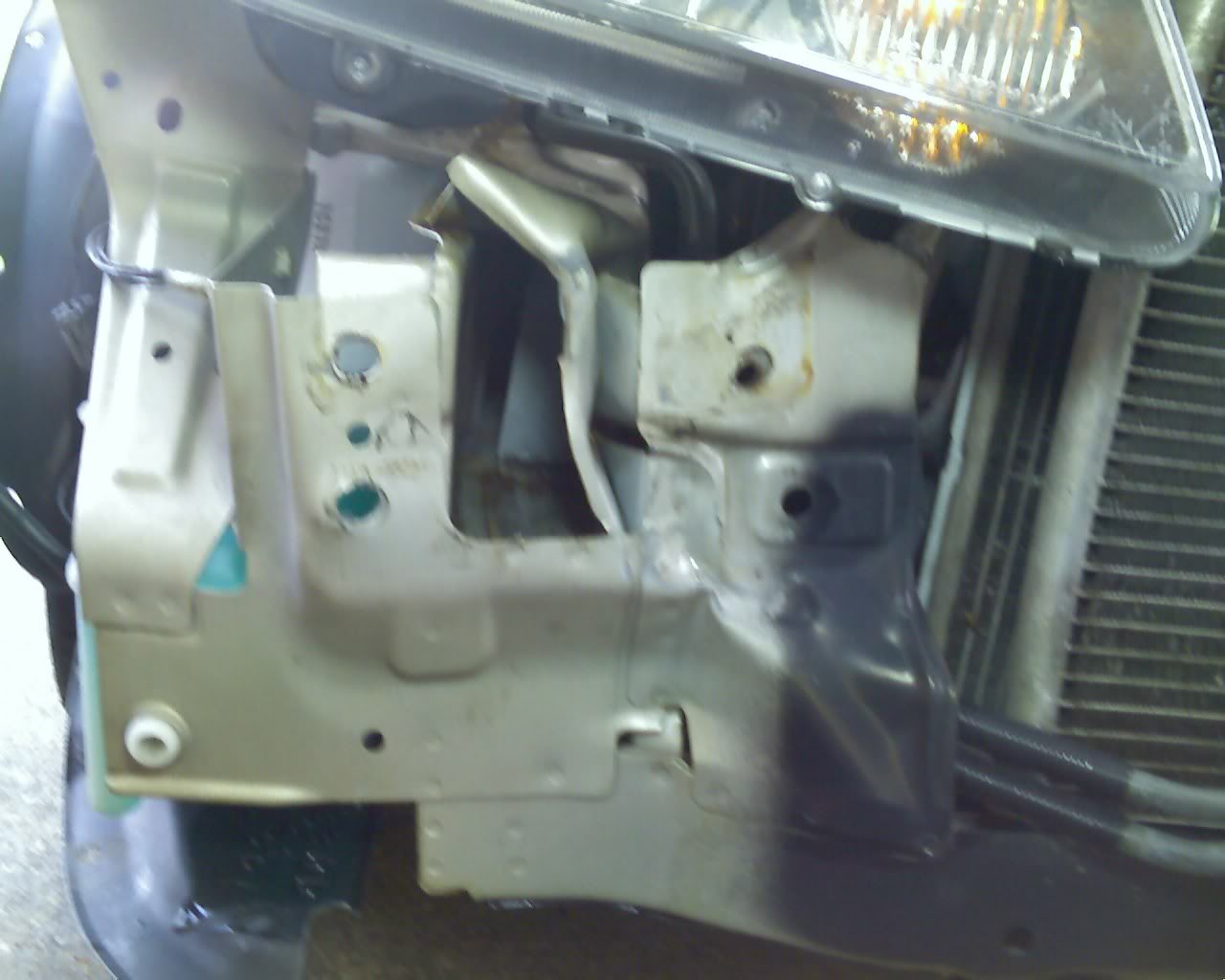

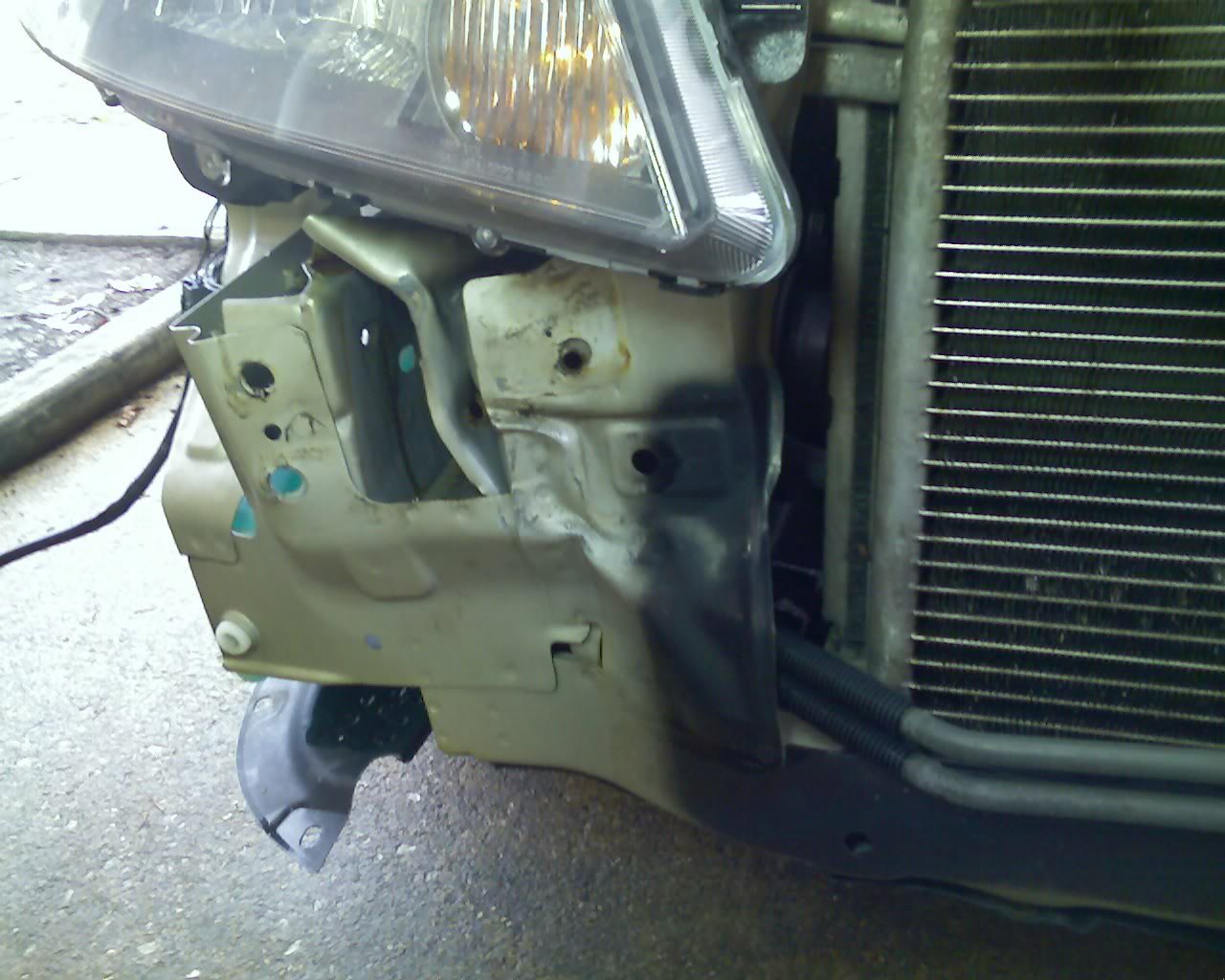

Right side
Right side (close up)
Right side (close close up)

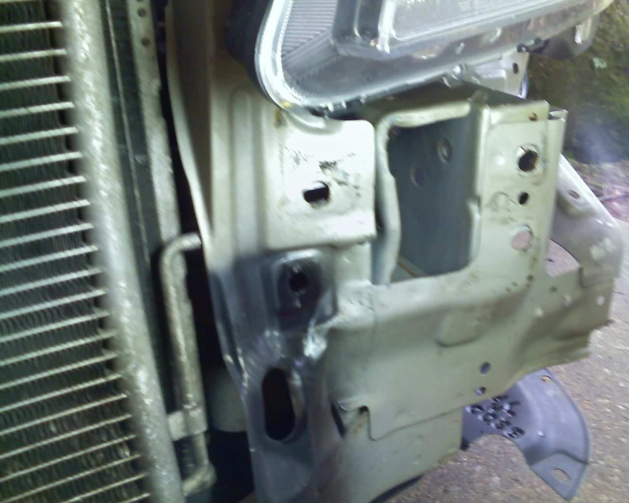

Left side

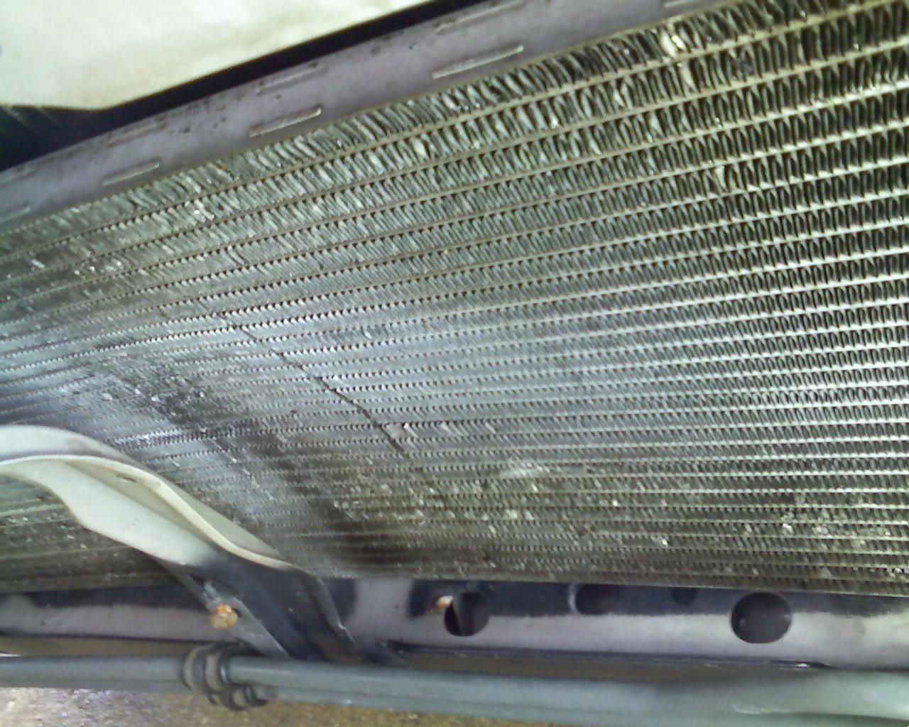

AC compressor (radiator)

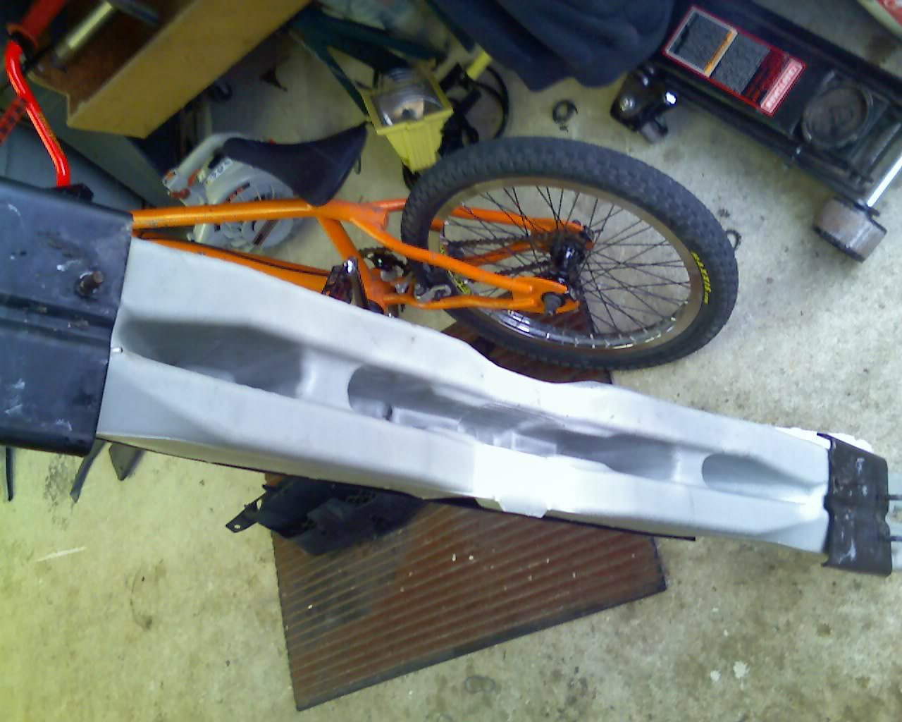

reinforcement bumper (its only a little white (stressed/almost bent) in the middle)
Old Apr 10, 2009 | 11:27 PM
maznik's Avatar
Joined: Apr 2009
dont bother you can get a reinforcement for $50 from ebay( thats what i did) but you can try to fit your old one, the thing you should worry about is the collision on your passenger side(it looks twisted). It doesnt seem a big deal but when you start putting everything back together the problems start. and you cant fix it with the hammer So you should see a body shop with a good frame from my experience it shouldnt be more than $200. for the engine mount if its leaking its no good anymore, replace it with a new one, i got mine for $ 60 brand new from e bay( it wasnt with liquid) i can post you a link. the support i saw its damaged too but its thin metal and you can adjust it yourself. if theres anything else just ask.
