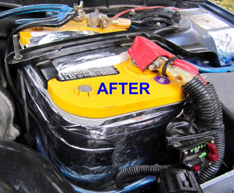

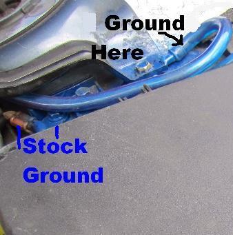

Old Jan 31, 2012 | 08:15 AM
UseYourNoggin's Avatar
Posts: 2,633
You Forgot 2 Grounds.
Grounding a big amp is not sufficient enough to ground it at the back of the car!
You have no idea of how many times I have seen or heard this. Many people put a big honkin power wire but don't logically think the ground wire all the way thru. My co-worker long ago did this also and fried his ground wire up front.
Have you seen the Stock ground wire coming off the negative battery terminal ---- it isn't big enough to handle that extra draw, not to mention you should also clean it.
1) Please add another ground wire from the negative terminal of the battery to the body (a good spot is battery hold down a few inches from stock ground).
2) Please add a ground wire from the engine block to the negative battery terminal as alternator will be working harder and your engine will love it (this one is not mandatory but logical).
Pics from my Mazda 6.
Attached Thumbnails Hooking up a subwoofer if using a stock deck.-grounds%40battmount2.jpg   Hooking up a subwoofer if using a stock deck.-battafter.jpg
