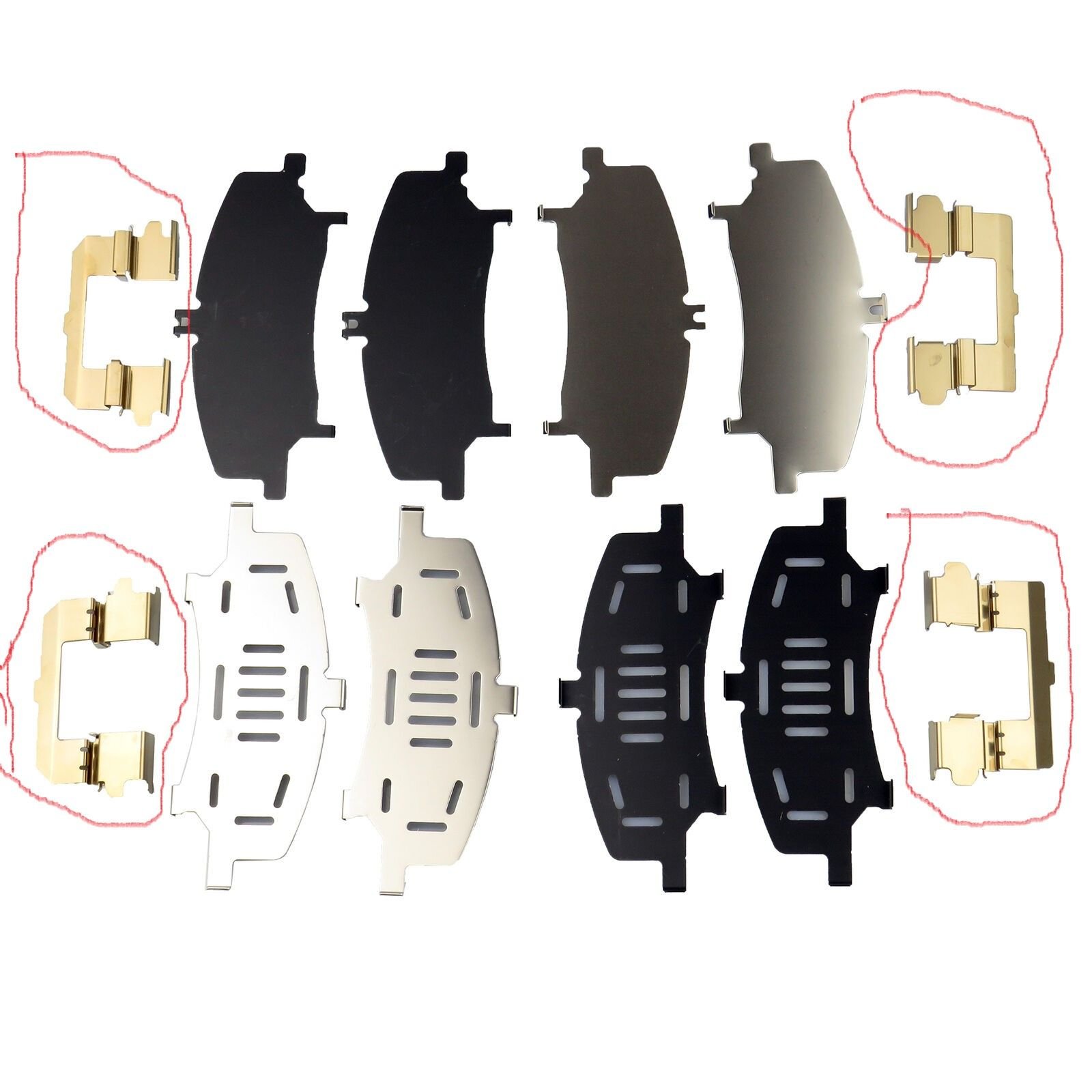

Jamesdhudson92 what vehicle do you have?
I know older CX-5s have a habit of snapping the calliper shims.
***Generic photo***

It would pay to get the brakes dismantled and inspected very carefully.
