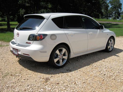

Aluminum Fuel Door

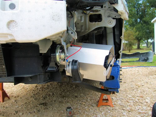

Dual Horn Mod

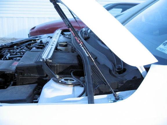

Redline Tuning Quick Lift Hood Strut Kit. [/align][align=center]A REALLY nice mod, imo. One hand to open and close the hood!!

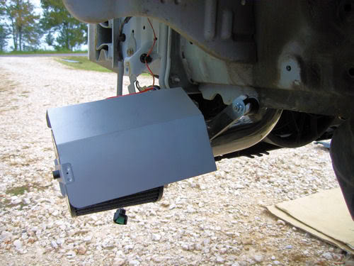

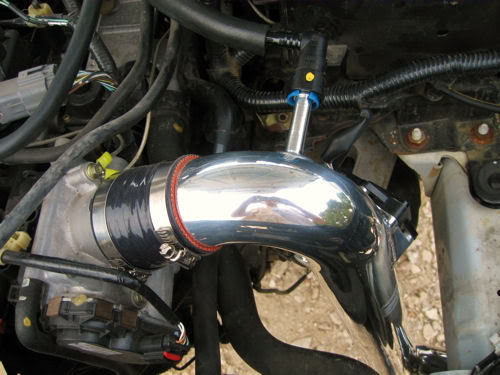

I finally dumped the "Poor Man's" SRI for a [/align][align=center]Mazdaspeed CAI.

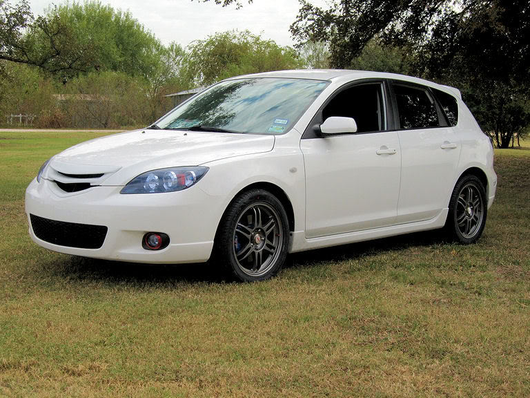

And finally, theAuto ExeGrill (knock-off,) Kosei wheels and Kumho 225/45-17 ASX's

Looks great! It sounds awesome too, Iheard the video. The grill looks sweet but Im not feeling the fuel door. Let me ask ya....
How's it ride with the wheels? How wide are they? (not the tires the rim)

Well, the fuel door: I wasn't sure about it either.I have grown to like it but lately have been thinking of having it painted(professionally) the same color as the new wheels. What would you think about that?
The ride/wheels: It rides just fine. I purposely chose the Kosei'sbecause they are nearly 5lbs. lighter than the OE's and even w/the wider rubber I saved about 3lbs/corner of unsprung weight. They are also very close to the stock offset of +52.5mm.I wanted that to avoid other steering and tracking issues. They are 17"x7"x +50mm, 13.7lbs. andlarge enough for any tire I'd want to put on this car.The steering is a bit lighter and she turns in better than before.

Yeah like the rims would be cool. The rims are gunmetal color?
I like the fuel door but with the clean shave look and all the fuel door color not being white throws it off a bit, IMO.

They're more along the lines of graphite. They glisten, the same way pencil lead does in the light,but don't really shine like a gloss finish would.More of a semi-gloss. Not black either, but a med-dark grey. The lighting has a lot to do with it.
Tell you what though, they hide the brake dust really well!!
