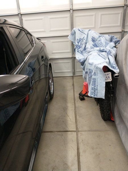

Parked for several years next to the Mazda.

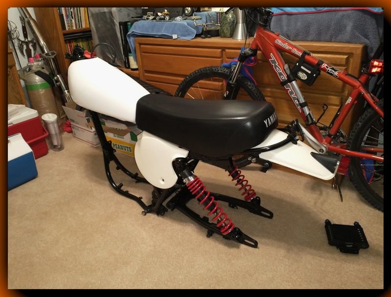

And as of today in the spare bedroom.
I just recently re-painted the Tank a Toyota bright white. Had the frame powder-coated and did a rear fender conversion. Also completely disassembled the rear shock and repainted the components.
Still a long way to go. Wheels are a personal refinishing challenge because i did not want to spend the money for new rims and spokes. And the engine is torn down as well.

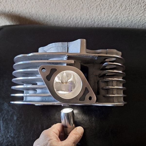

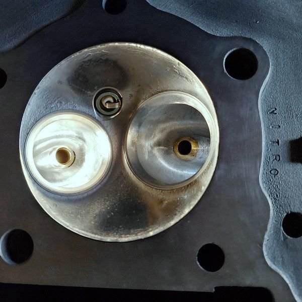

Posts: 10,593
Currently working on the head.
I will be doing a complete service and upgrade.
After cleaning and bead blasting:

I did one last (I hope) polishing up before I install the springs and valves.

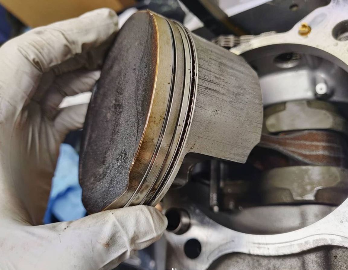

My lovely DRZ400SM experiencing an engine knock. There's some good scoring seen here and some play in that connecting rod as well. In any case, got it cleaned up and down to the bare casing. I will be installing a new crankshaft, bearings etc and throwing a 441 big bore kit at it as well. This DRZ never fails to surprise me haha
