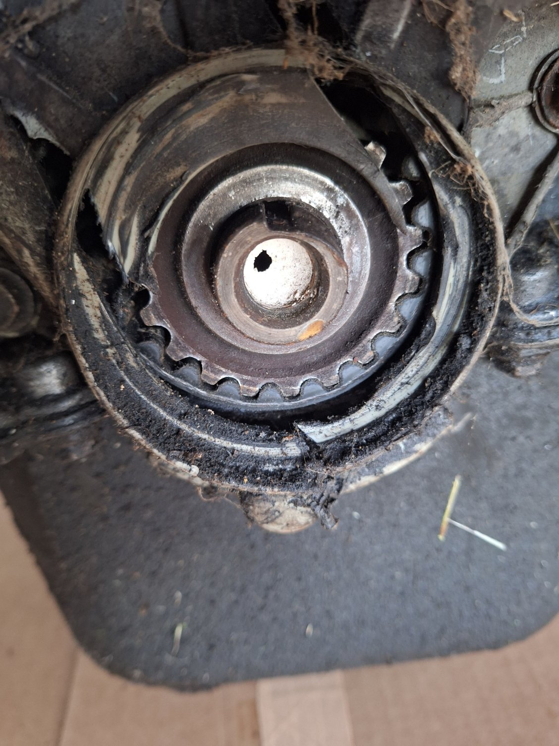

Found some damaged parts...
First pic is the center of the balancer, damaged.
Second pic shows a damaged crank nose and broken keyway slot.
Also, it appears that someone decided they didn't need that timing belt guide washer behind the balancer. So the timing belt ate through the cover.
I met this "someone" when I bought the car for parts. The knows a lot but does a little, type.
I guess the motor in the red car will be coming out sooner than later. Need that crankshaft!
So... I have one bad block d15 and one bad crank d15.
