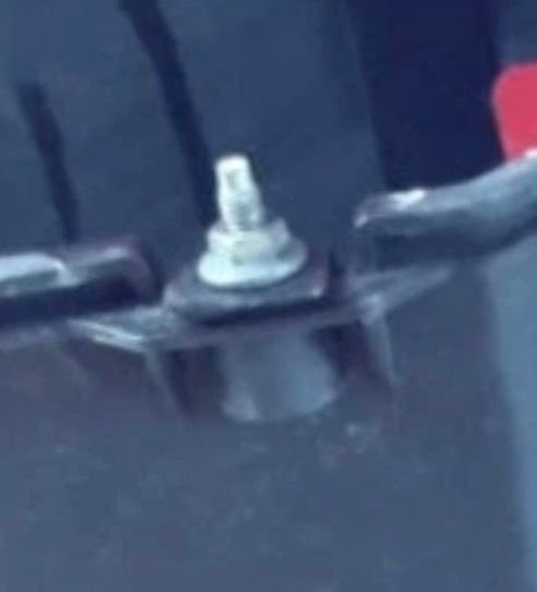

It’s 2026 and I did not think that forums still existed. I’m a new Mazda owner and I am not exaggerating that my 2011 Mazda 3 2.0L with. 5-Speed Manual is the greatest vehicle I have ever owned. It’s something to behold. That being said I was going to ask for an assist in getting a part number. Not sure is everyone is familiar, but these have a battery box assembly with a bolt that is molded in. I am trying find the nut. I ordered a part off of E-Bay and it wasn’t included evidently, which is the whole reason I had to order it. Anyways thanks for existing and hopefully this isn’t an annoying post.

from the picture....... best guess ..... These generally strip out on the body side (from over tightening) ... If that is what yours did you may need to first repair the crack and the threaded hole.
These are called hanger bolts, and they are readily available in many hardware stores of thousands online sources.
When customer apparently stripped them or the last service shop did most of the time, I have what my Tech needs to repair the damage. if not, I just run up to Lowes or Hom,e Depot for the part.

6X1 flange nut.

I think it is the picture below that he may be refereeing to? The nut on top in his picture is not the one that is hard to find.
But describing what you need to someone use the term hanger bolts
In this picture substitute the descriptive word "wood" to plastic.
Bolt Depot - Hanger bolts, Steel plain finish, #8-32 x 3/4"

He said he's trying to find the nut not the anchor bolt.

yaI read that but it’s an average nut nothing special that’s why I post what I thought was more likely what he was asking for.
