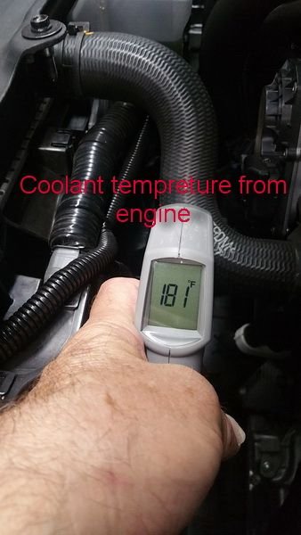

One way that works and is very accurate.
After a short drive to get everything to the operating temperatures.
Check the coolant temperatures at radiator hoses both upper and lower and compare then with how the dash gauge is register.
Top (upper) hose
Bottom(lower) Hose

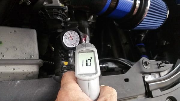

And if yo don't have a MiniTemp I am sure you have this in your kitchen that is very close, at least to get a general idea what the temperature is.
And yes it does work for all the other who are looking a this and going WT* ! lol
The Meat gauge indicates about 106-108F comparing a true temperature registered of 110F... LOL
We all gotta love what MacGyver taught us about use what you have available to use in a pinch, number one items , duck tape and bailing wire... LOL
