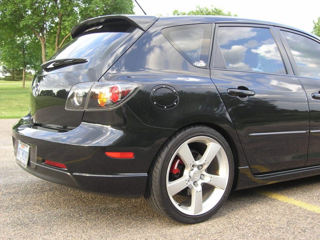

Those Megan Racing springs say that they lower the car 1.5" but I see more gap between the fender and the tire on their car than on mine which is supposed to be 1.33" front and 1.25 rear.
Megan Racing:
Mazdaspeed lowering springs (Eibach Pro-kit)
See what I mean? I know my tires are not stock and the rim is a different diameter (18") BUT my tires are pretty much the EXACT same diameter as the stock 205/50/17 tire.

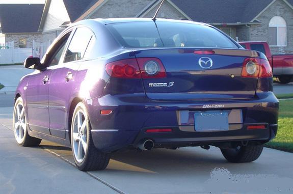

Here's Prokit springs on a sedan (I sold this car while back.) I also did put the Camber kit on as I put 25,000 miles/yr on and didn't feel like trashing my tires that quickly.
17x7 wheels, 60mm offset 225/45R17 tires.
I thought it to be the perfect balance between performance and daily driver.
I miss this car.
Attached Thumbnails Lowering My Car-111105-drivers-side-prokit.jpg   Lowering My Car-111105-drivers-side-rear-prokit.jpg

Hence, along with the 50mm offset, is why the wheel/tire appears pushed out to the fender further than the stock 3 rim. I was just making the reference to the VERTICAL space between the top of the tire and the edge of the fender. If I had Sport Line springs, it'd definitely rub being pushed out so far. As it is right now with the Mazdaspeed/Pro Kit springs, it rubs a little on large bumps. Nothing a little rolling of the fenders couldn't fix. Stock rims/tires, on the other hand, should tuck up real nice and not have any rubbing issues, I would think.
BTW, the Mazda 6 rims look pretty nice on the 3! Was wondering what that might look like. Thanks for the pics!
