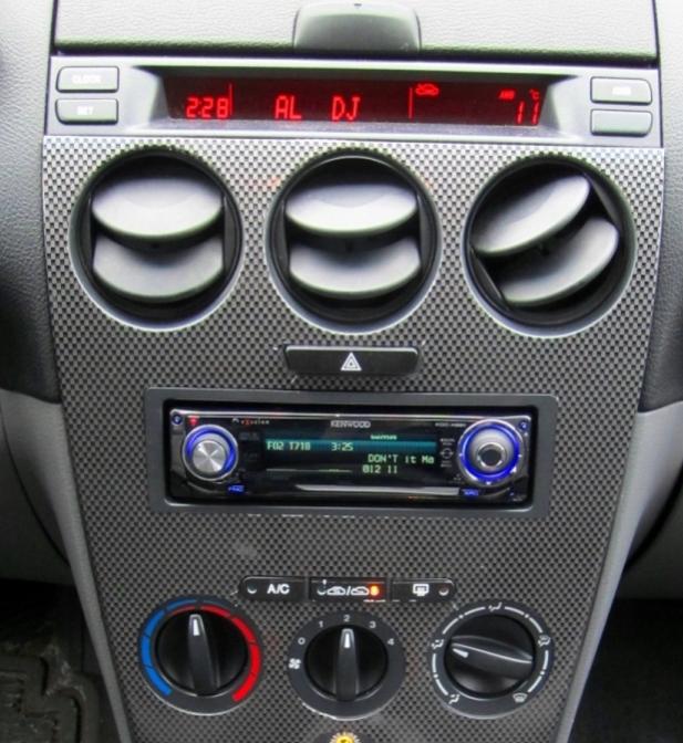

You can buy a new centre console that accepts whatever you buy but this is best to go through an aftermarket stereo place. This is what i did. I got a good deal on a single CD player with a USB adapter which plays as much music as i load on to it. The middle console adapter is not cheap and are ugly. Some people put some after market decals on it (this should be done before installing the stero ---- i did mine after and when i cut it out around hazzard button, it didn't quite come out perfect). Pic attached.
ClickMe to see soom good decals.

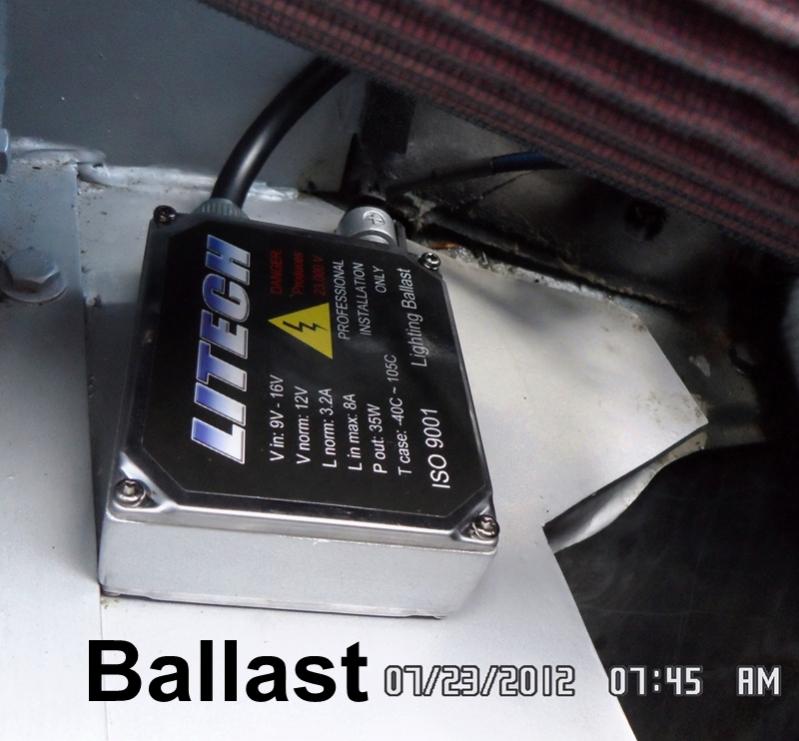

HiD lights are great. I would recommend 35 watt in the range of 4300K to 6000K (no higher).

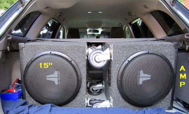

When you add a stereo make sure you add extra grounds to engine block and body to the negative terminal of the battery on top of your amp ground!
If you go further than 8 feet for your amp power wire than 4 gauge wire will not be thick enough for good bass response.

thanks, i think it looks nice, the biggest problem im having is that im trying to make it look 'fresh' so when ever i go to a car meet people will be like oh thats nice, but the thing is its going to be my second car and any mods i do will take time because i still go to college and have a part time job, the one im getting is a 2004 mazda 6 in silver, and one of the fist things ill do is lower it with new coilovers and get alloys jdm style, any suggestions what colour alloys will go with a siver car appart from black?
