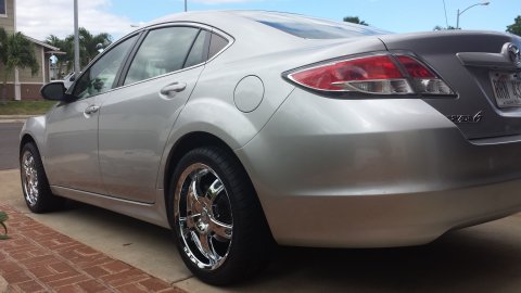

Howzit people!! I didn't know there was a Mazda forum, but then again, I didn't bother finding out if there was one...buahaha! Anyways, i'm glad I found one and joined instantly. I have a 2012 2.5L Mazda6 which I bought last November and just recently got new rims and tires for it. I had no problems the past couple of days but as soon as I hit the freeway my tire sensor warning light came on... Does anyone have a solution? Please help me out...Thanks!!
