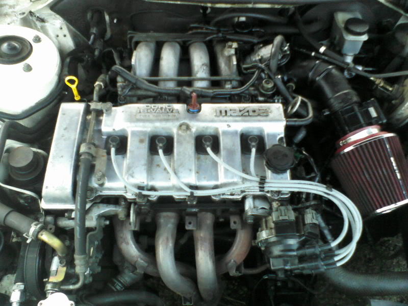

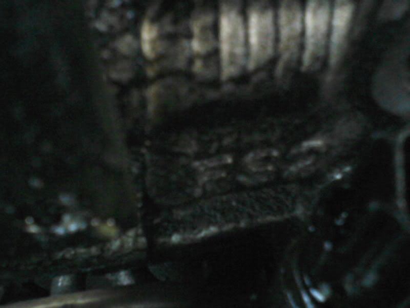

also, could anyone tell me what engine i have? i believe it is the regular old FS @ 115 hp, but if someone could verify that would be great! what gets me is the FS2 casting on the head, i found nothing related to this.

looks like a 2ltr 115 brake - think we only had the 2.5 GT in the UK. Think the Ford Probe had a similar engine here

yeah, that is a 2.0 fs-de. that is the first generation of that motor though. the block and head are the same as the protege 2.0 engine, but the electronics and valve cover are the same as the bp 1.8 dohc motor. it's actually a pretty nominal set-up. a lot of the protege guys were swapping to the coils and valve cover that motor uses. they claim that it adds a little bit of extra power.
