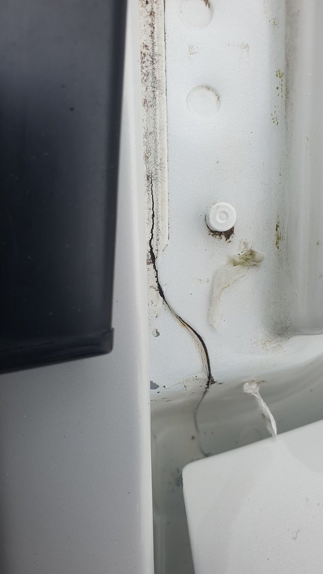

I have found about 2 inches of water in my spare wheel well and also in the jack storage area.
Using a hosepipe to simulate rain and my wife sat in the backseat/boot area to check for the water I sprayed water on specific areas....
1. On the sides near the fuel filler cap / side windows
2. Onto the rear window so the water ran down the window without going into the side channels
3. Onto the rear lights
4. Ran the hose slowly up each side of the roof drainage channel either side of the boot ( with the lid open) as far as the top of the piston bolts to see if anything was coming though the hatch piston bolts at the top or the rubber pads at the bottom.
5. On the roof just near the middle of the hatch so the water flowed down the drain on each side of the boot but didn't touch the sealant area mentioned below.
The water seems to be draining out down the side channels and out under the car and none of these caused any water to drip in.

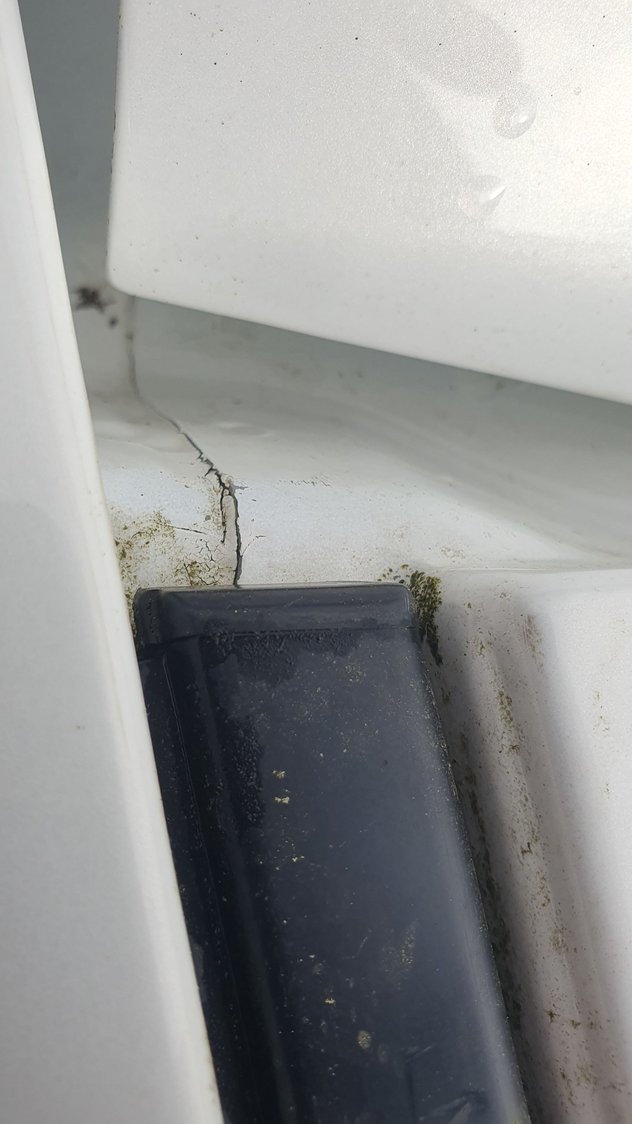

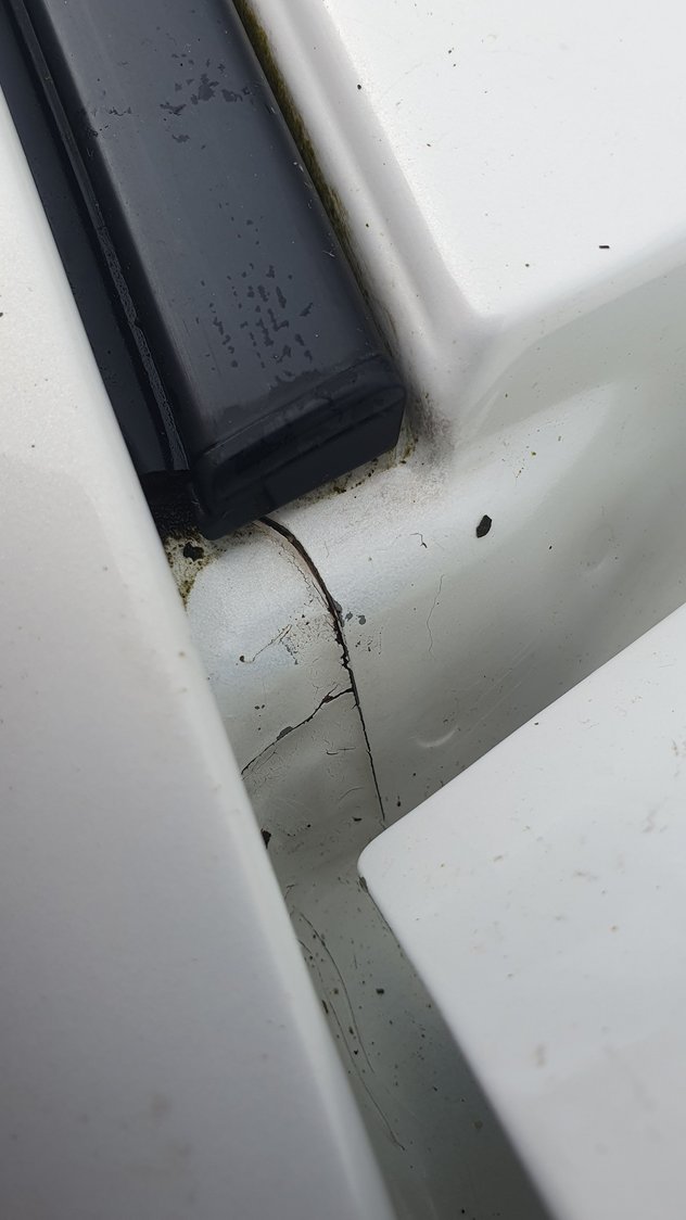

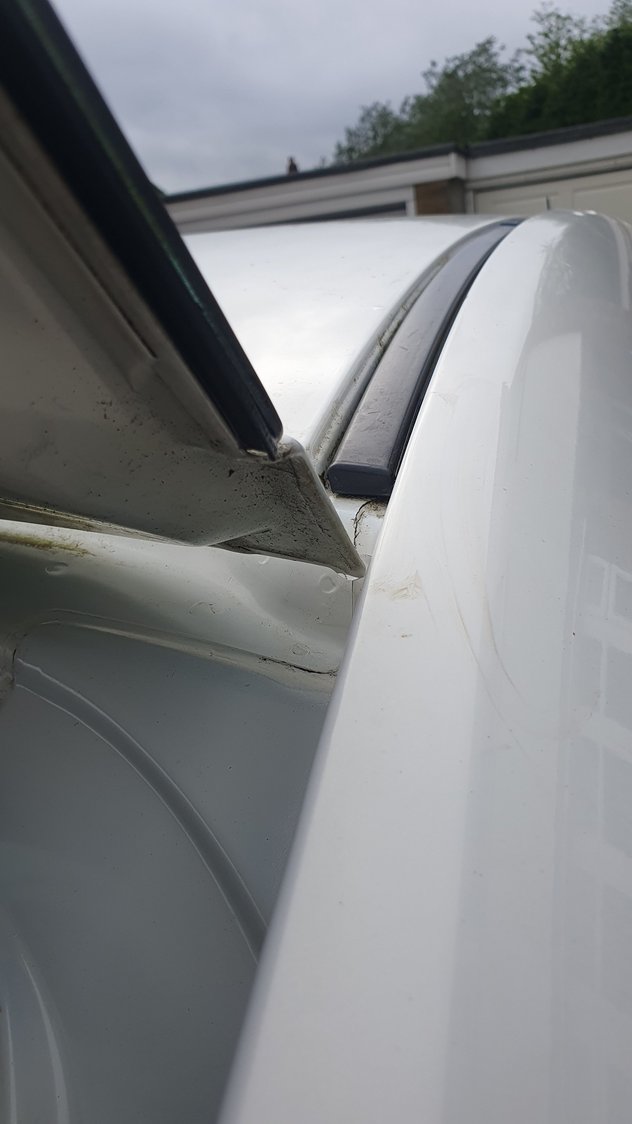

I then spotted that there was some kind of sealant just where the roof rails end and the roof panel meets the hatchback panel that had some small cracks in the sealant. I put the hose on the roof rails so the water had to pass over this sealant on its way down the hatch drainage channels.
Even though it took some time (10 seconds) to appear as it is coming out behind trim or panels in the boot some water then started to come into the boot

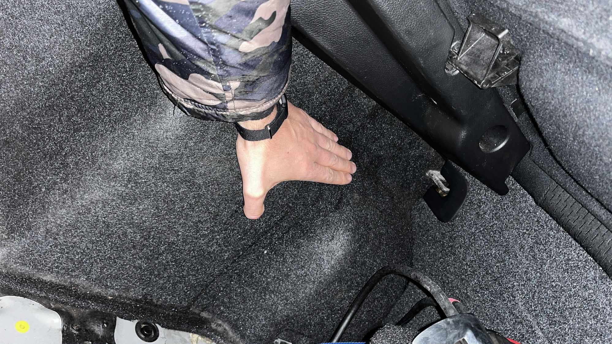

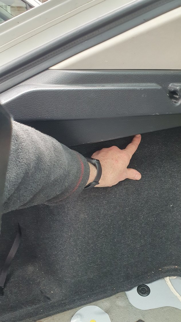

1. On the passenger side it seems to be coming down the outside of the felt trim about level with the fuel cap and then running down into the spare tyre well (see photo with finger pointing at leak)

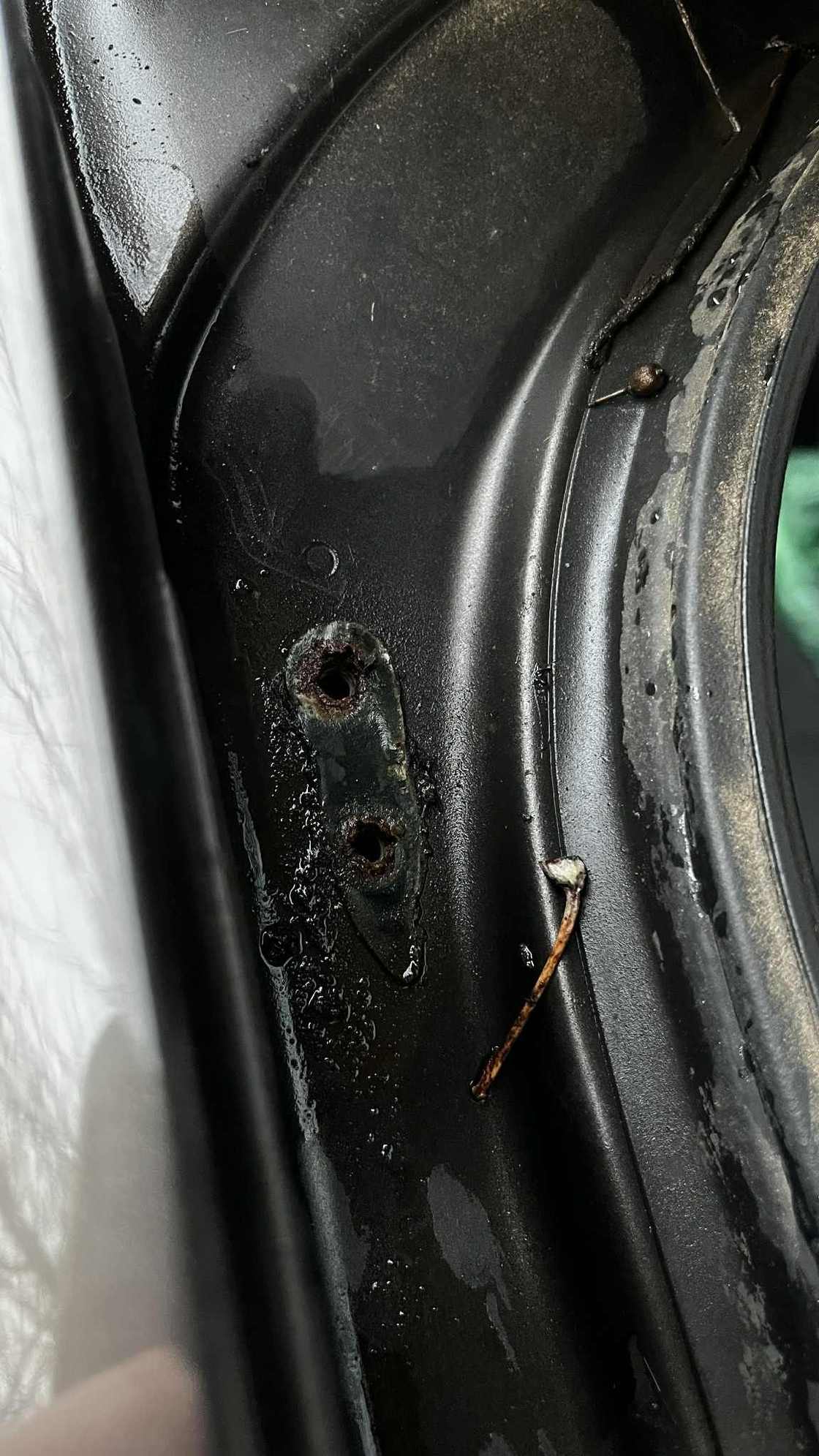

2. On the right side it is appearing in the jack compartment where two metal plates seem to met (see other finger photo)
I've also added a photo of the cracks in the sealant.

1. I know leaks can come from anywhere but could the cracks in the sealant cause this?
2. If it could be this sealant do I need to cut/scrape it out and repair. If so how do I remove it and what should I use to repair it with?

If you're still having issues with this, I fixed mine by using flowable silicone sealant in the area either side at the rear of the roof drain channel, after I found a pinhole in the seams there.

The first things I sealed (with ordinary, paint safe silicone sealant) were the bolt holes for the boot strut mounting brackets and the bolt holes for the blocks that pull the boot lid closed (further down the side gutters from the strut mounts). This didn't stop the leak in my case, but it is probably not a bad idea, as it is an easy thing to do.

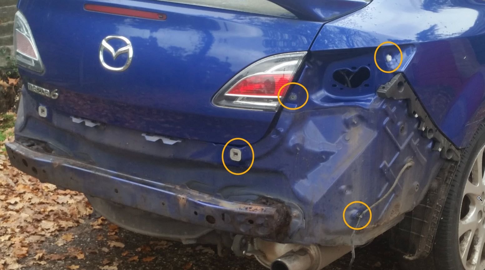

At this point I thought I had fixed all the leaks - but then I realised it was also leaking from where the bumper is mounted.
I removed the rear bumper and rear outer light clusters, and noticed that the locating lugs (for the lights) and the plastic bumper mounting grommets were loose (rubber gaskets had shrunk), so I removed them all and used ordinary silicone sealant (paint safe type) to seal them to the body, I also put some sealant under the clip that holds the number plate illumination wiring to the body, and around the rear vent flap unit. (See attached photo's to see locations of fixes).

https://photos.app.goo.gl/mb656uuJxys3HRwQ9 - Right side
