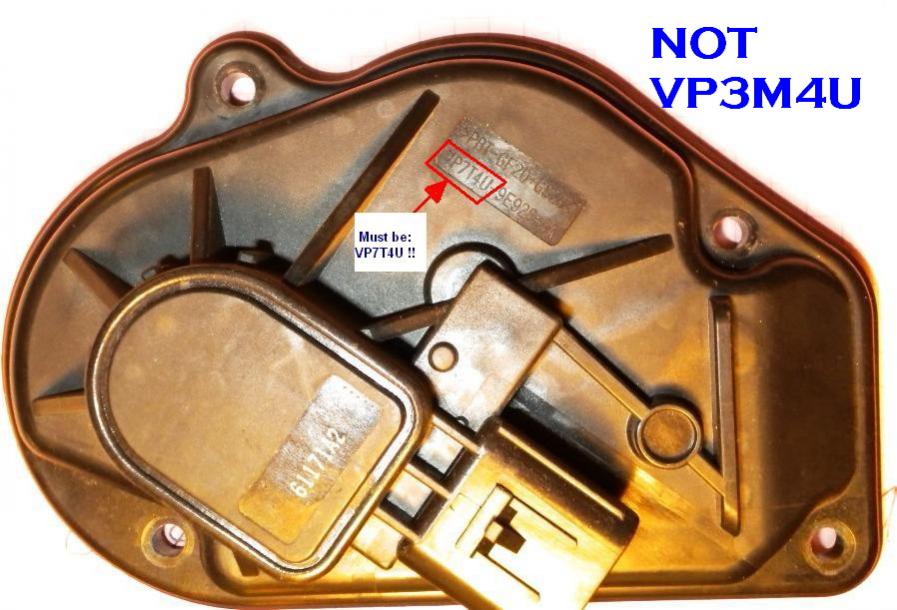

The older V6 Mazda6s V6 3.0L with the original TB part number starting with VP3M4U-*-AA, -AB, and -BA have a TB problem that may not throw a CEL. (No CEL, no warranty coverage...).
Also must be a certain part #, see attached pic in thumbnails, pic shows a good one.
