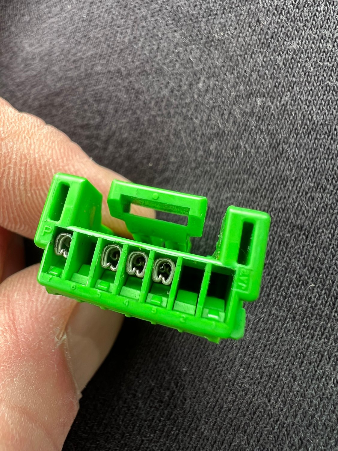

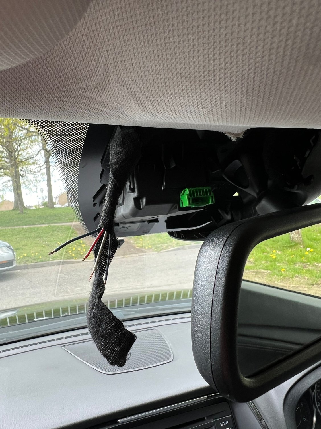

Hello everyone, recently I've bought my Mazda 6. There is SCBS Inspection Required light on the dash and I've found out that wires are not connected. Does anyone know how should it be connected or where should I look for help? Thanks in advance.

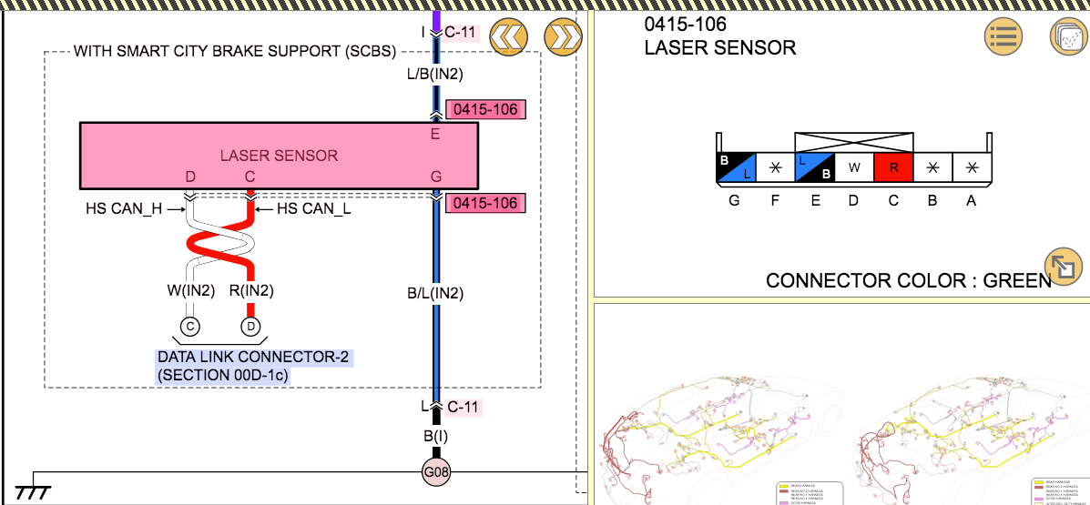

WHITE and RED are CANBUS network, in your picture the other 2 wires look like GREEN and BLACK instead of drawing BLACK/Blue, BLUE/Black these are Ground(G) and +12V(E) respectively but confirm using a Voltmeter with Ignition ON.
