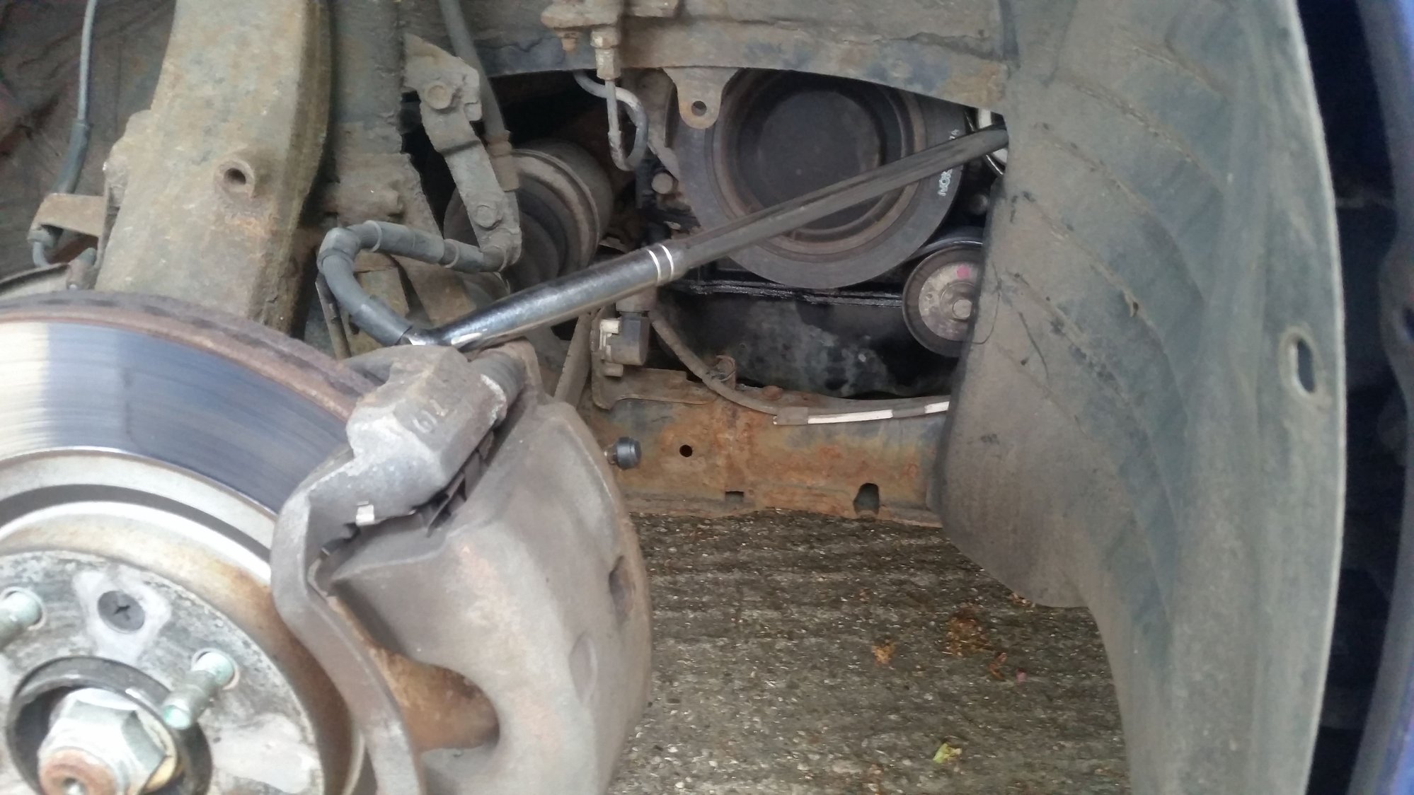

For anyone doing this job or any other job that requires the aux belt to be loose, here is a little tip / hack that I find helpful:
I have a 3/8" breaker bar (around 14" long) with a pivoting head on it, this is exactly the right length to pull the tensioner up and leave in the "off" position, with the breaker bar handle resting on top of the brake calliper, thereby leaving both hands free to fit a new belt, or change a pulley / tensioner, etc, without having to remove the belt - which is really handy if no assistant is available.
Hope this is of some use to someone.
