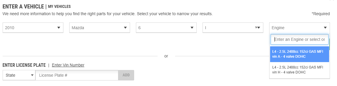

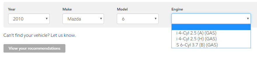

I just bough myself a 2010 Mazda 6i and I'm trying to do a tune up/replacing fluid and filters but every time I go to a parts store its asking if the 2.5L engine is an A Vin or H vin. I have no clue what the difference is or how to tell (My vin has A and H in it so that doesn't help) Vin = 1YVHZ8CHXA5M17665. Any insight would be much appreciated.

Anyone viewing this and wondering, it is referencing the 8th digit of the VIN (so the car in this post is an 'A VIN')
