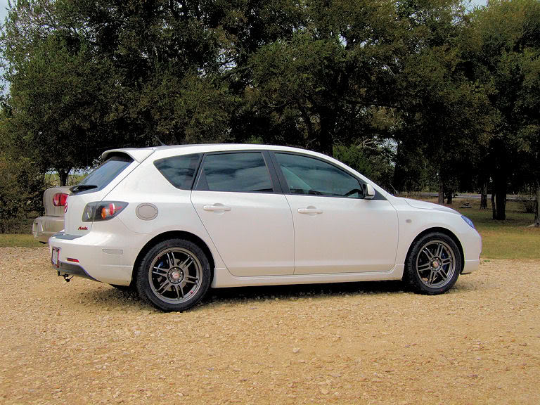

Gina, it's not the tires that are different. You can change to, or add compressed air any time you want to. It's just the medium, in this case nitrogen, that is used to fill them.
I own a set of those wheels I pictured above, but run compressed air in them. I too have wondered whether or not is was worth the extra hassle for what is essentially, my daily driver.
(My car with 17x7" Kosei Racing wheels in Med-Gray, "Graphite"... not the best picture)
Perhaps if I owned a highly-strung, expensive sports exotic that I raced every weekend, I would be more concerned about what gas I ran in the tires, but frankly to me it's just not worth it.

Richard,
Is that a Chevy Cavalier you are hiding beside your Mazda? If so your not doing a very good job! lol
